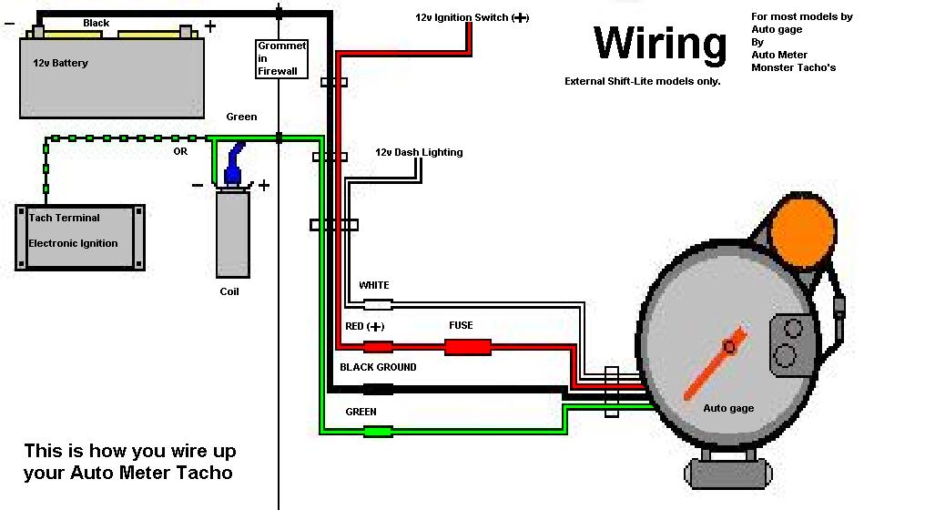

shauns ke30 Posted January 17, 2010 Report Share Posted January 17, 2010 (edited) Hope this help's some one! I no everyone always ask about how do you put a 5'' Monster Tacho in ?? well hear you's go esay as have a look oh and there is also two loops on the back of your tacho (that mite need to be joined or cut) for 4 bangers 6 bangers and also 8 bangers will get this info tomorrow for yous cheers shaun Edited January 17, 2010 by shauns ke30 Quote Link to comment Share on other sites More sharing options...
Roo Posted January 17, 2010 Report Share Posted January 17, 2010 good stuff, but you don't need to earth it to the battery. anywhere on the car body will do Quote Link to comment Share on other sites More sharing options...
shauns ke30 Posted January 18, 2010 Author Report Share Posted January 18, 2010 good stuff, but you don't need to earth it to the battery. anywhere on the car body will do yeah i thought so lol but thats what the auto meter booklet said to do so just running of what the diagram said :dance: cheers mate Quote Link to comment Share on other sites More sharing options...
