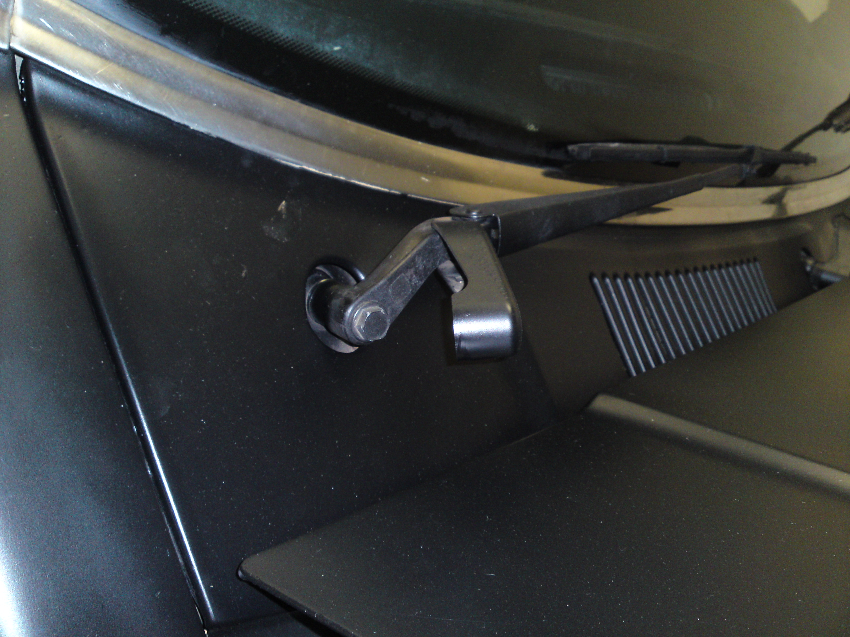

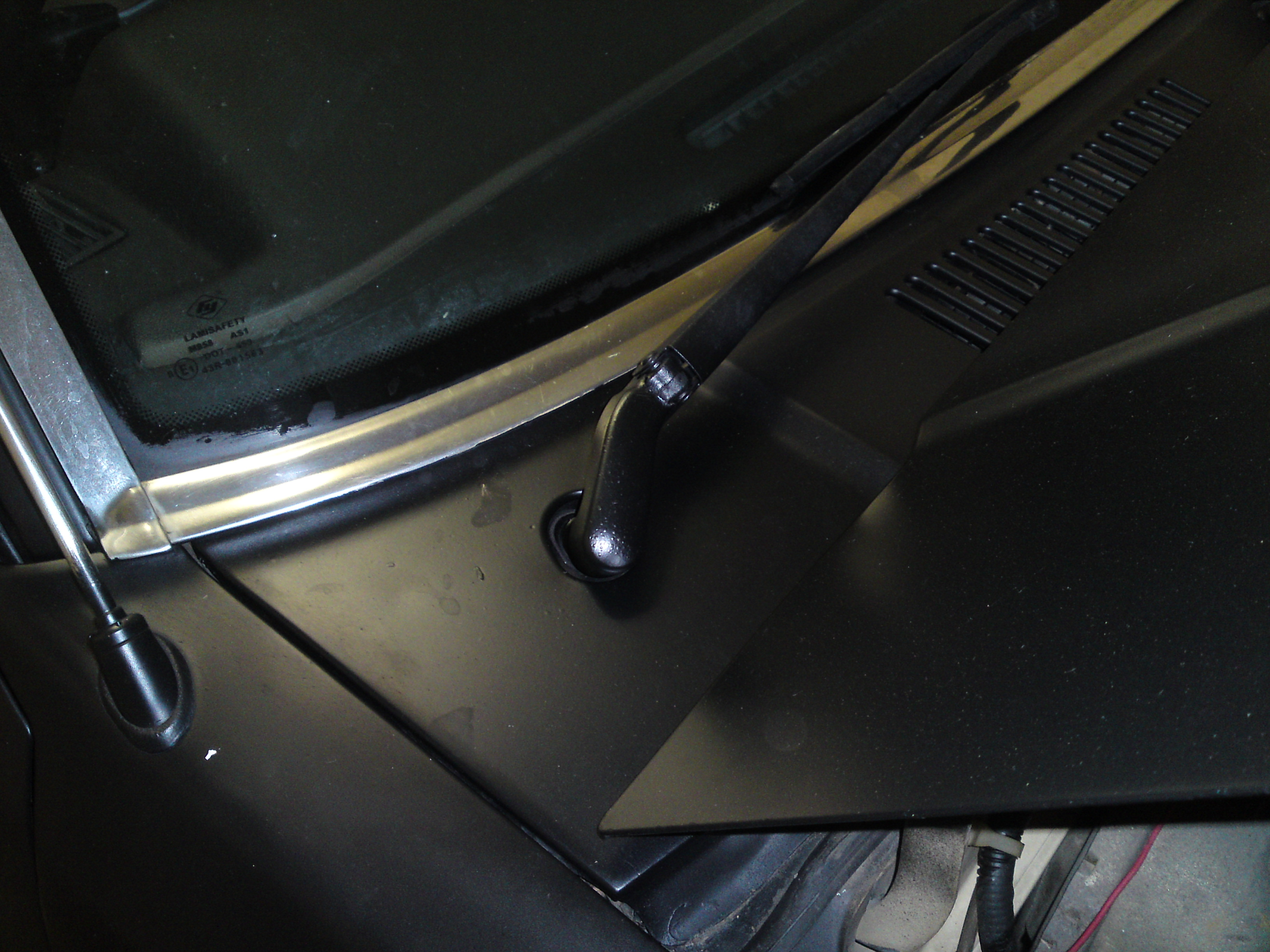

B.L.Z.BUB Posted February 5, 2010 Report Posted February 5, 2010 where the arms attach to the motor there is a plastic cover give it a tug it should slide up and off pretty easy exposing a nut. Once the nut is off just give the arm a wiggle and it should pop off. If really rusty you may need to spray with wd40 overnight. Repco or somewhere will sell generic ones that will fit just ask the dude behind the counter. Or go to a wrecker. don't pay anyone to mount them, its a 5 second job. Use that money to buy a workshop manual. Quote
markhansen1983 Posted February 6, 2010 Author Report Posted February 6, 2010 where the arms attach to the motor there is a plastic cover give it a tug it should slide up and off pretty easy exposing a nut. Once the nut is off just give the arm a wiggle and it should pop off. If really rusty you may need to spray with wd40 overnight. Repco or somewhere will sell generic ones that will fit just ask the dude behind the counter. Or go to a wrecker. don't pay anyone to mount them, its a 5 second job. Use that money to buy a workshop manual. Dude- that was great advice. I went to StupidCheap- they said they would have to order them. Repco measured them and then sold me the generic ones. Now all installed- cheers for your advice and pictures. Quote
