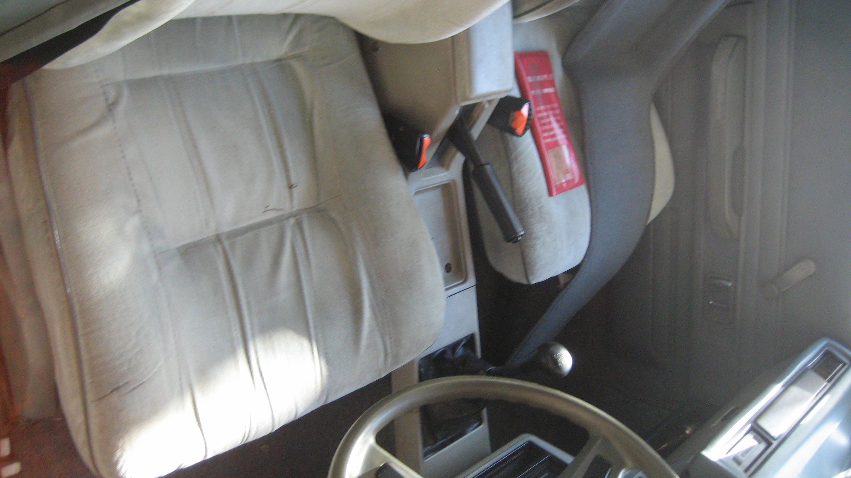

I'm 90% sure mine has the front style. Coz i have a pic which ill post.
as you can see there are no side adjusters. so...?

To clear this up all slanty front ke70's and ae71's had the adjuster lever at the front for the fore/aft position. Flat front ke70's had both levers on the side. And the seat and mechanism in youre car is original Jesse.
