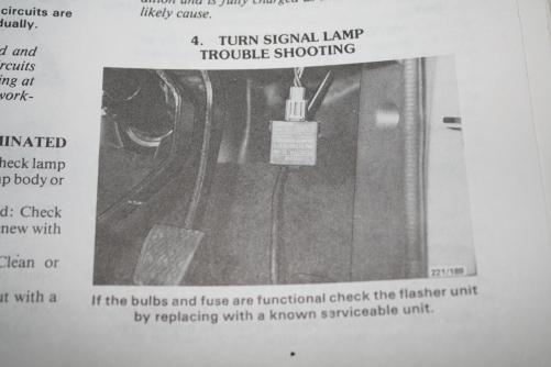

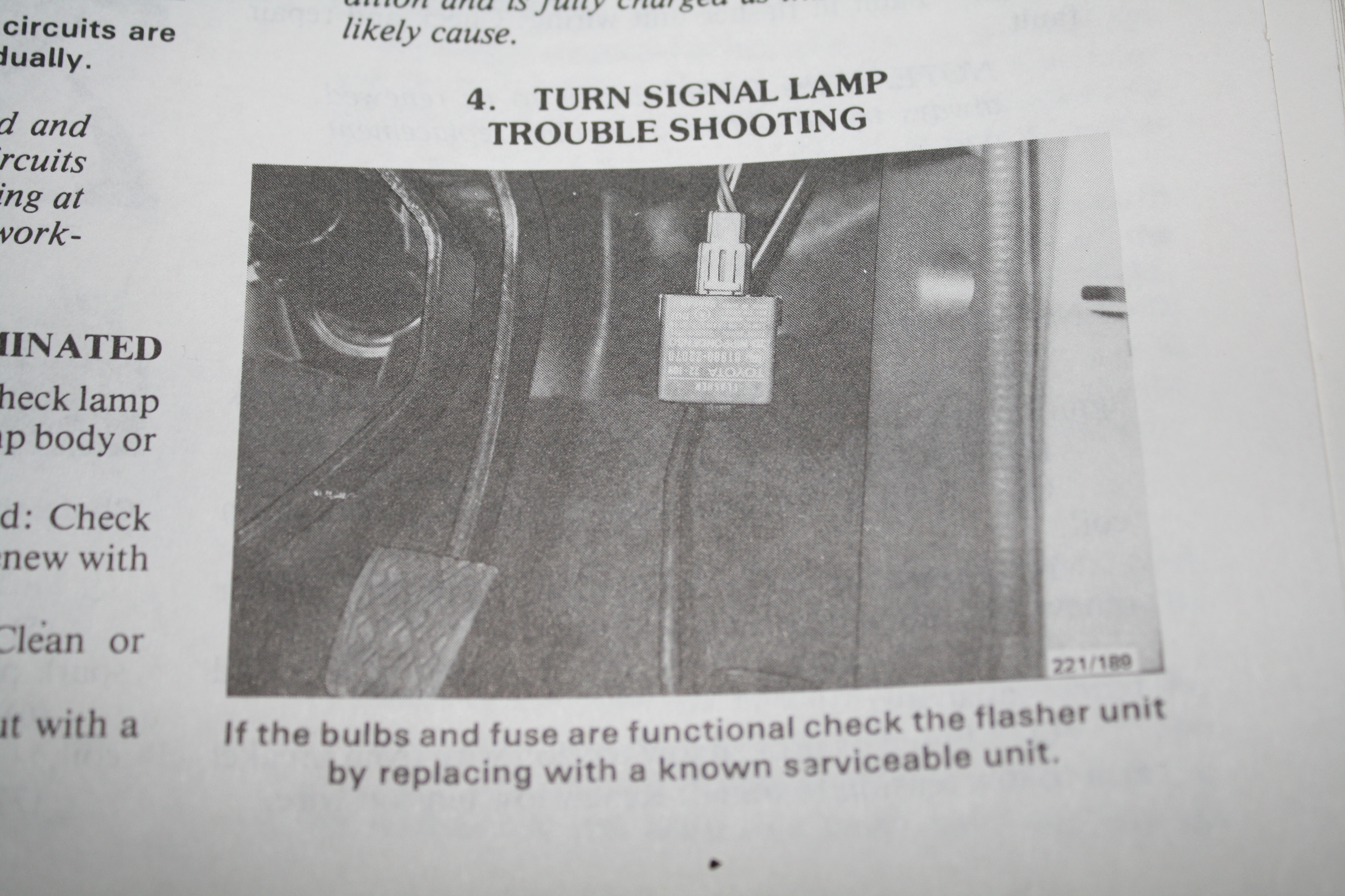

Found my manual, the picture of the flasher unit is hanging down in the drivers foot well so it should be close to the fuse box. Best I can do no other info in there.
