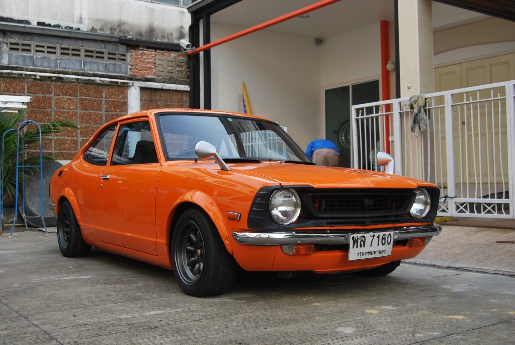

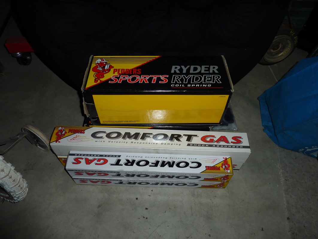

October 27, 201015 yr comment_478551 try some lowered king springs in the front, then find another set of rear springs and undo them, trim 20mm off each one, unpack the ones on the car, then repack but have the second leaf inverted, get a longer bolt for the center locating position, you may need a set of clamps as it gets pretty stiff, and hopefully it should turn out looking a little like this. rear shocks, try VH commondore wagon sports riders from pedders. Report
