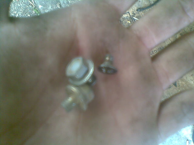

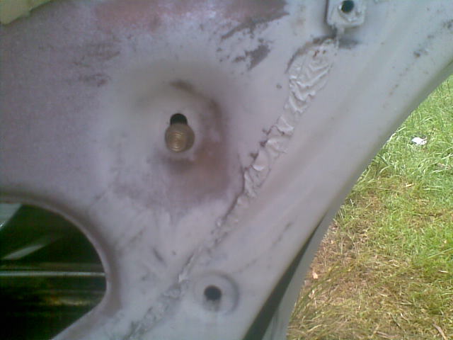

There will be two 10mm bolts one at the top like so

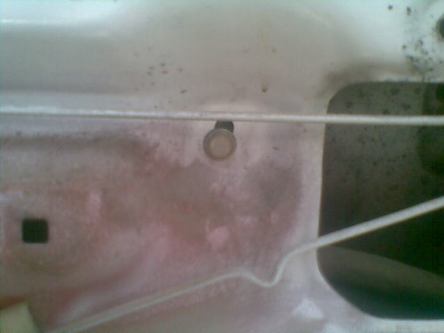

And one on the bottom of the door like so

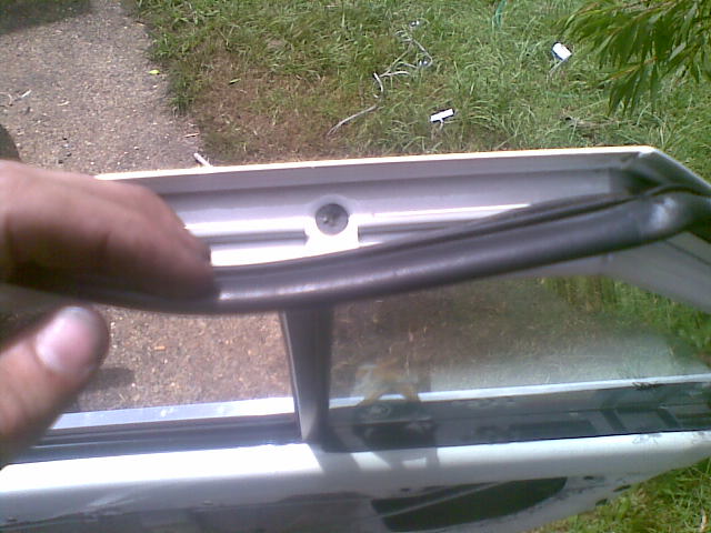

Then there will be a phillips head screw on the very top of the door under the weather strip like so

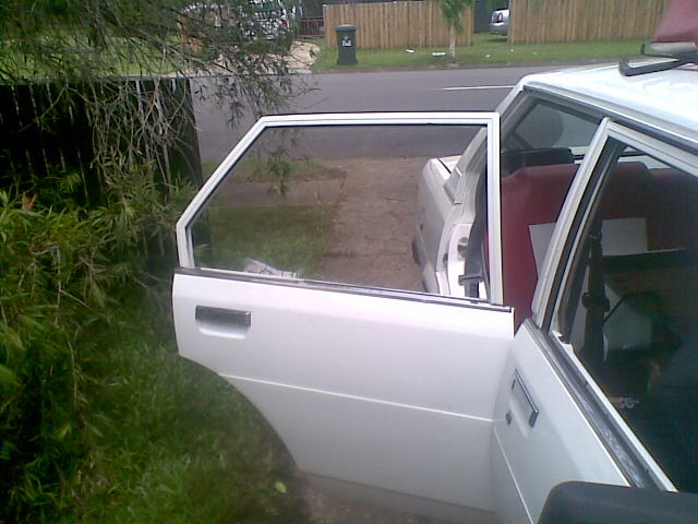

then you need to pull the window 'runner' out like this
once that is out of the way you can then procede to pulling out above bolts and screw,

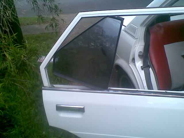

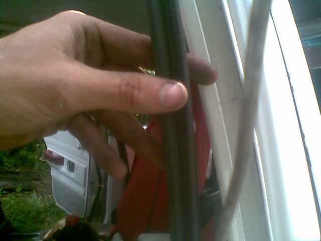

once the 'rod' this thing>>>>post-7244-054838100 1291781256_thumb.jpg is loose take the window off the runner on the bottom of the winding mechanism, let it GENTLY slide down and rest in the bottom of the door, remove the 'rod' out of the door and pull the quarter window out like this
and you should have this in ya hand when your at this point
and your door should look like this
