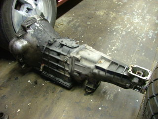

B.L.Z.BUB Posted May 26, 2011 Report Posted May 26, 2011 Make sure its a 70 box not an earlier one. Different shift position. Rare that it'll be an older one, but I found out the hard way. Quote
Millaz88 Posted May 26, 2011 Author Report Posted May 26, 2011 Is there an easy way to find out? Like code number on casing or anything? Quote
B.L.Z.BUB Posted May 26, 2011 Report Posted May 26, 2011 (edited) ke70 box (note shifter further back) Edited May 26, 2011 by blzbub666 Quote
Millaz88 Posted May 26, 2011 Author Report Posted May 26, 2011 Sweet thanks mate o how i would have hated my self if I was half way through and realized lol Quote
