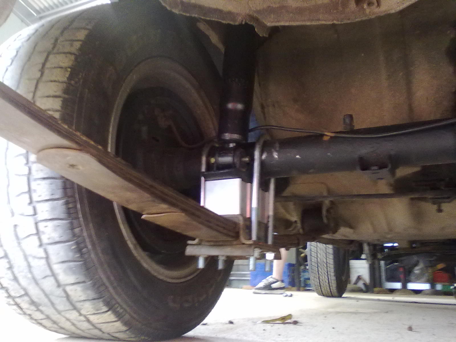

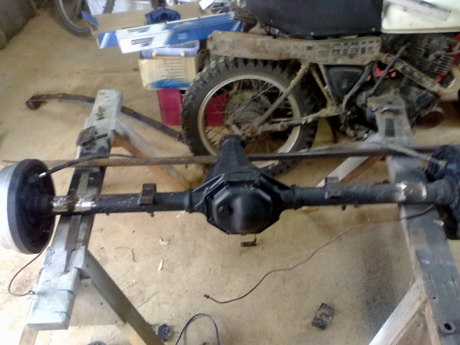

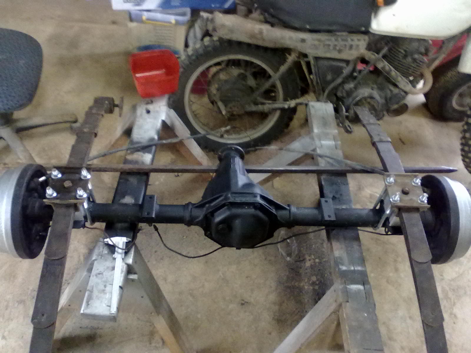

I've done it!
The spring mounts on the 55 diff are about 25-30mm wider so your springs twist inwards. The overall wheel track is about 35mm wider also. You'll have to lose the swaybar because there is nowhere to mount it on the ke20 body.
The drum brakes of the 55 BW diff are much bigger than the 20 drums and have a different stud pattern. 55-4x114.3. 20-4x110. The shock absorbers of the 30/55 mount to the lower spring plate and on the 20 diff the mount to the spring mount, so shock absorber length becomes an issue when you use lowering blocks.

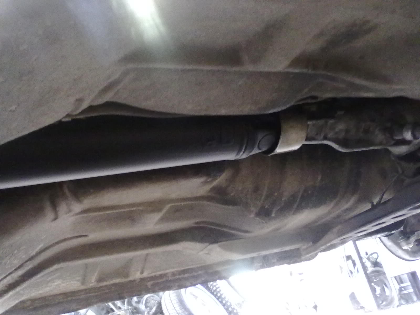

The final issue you will encounter will be the tailshaft as the rear yokes are different. Square for the 20 diff and round for the 55 diff. I found a 55 tailshaft and had to shorten it 25mm. It is a much thick tailshaft but its lighter. You may encounter a problem where the 55 tailshaft won't fit into a ke20 gearbox. I didn't have that problem as I used a ke70 5 speed.

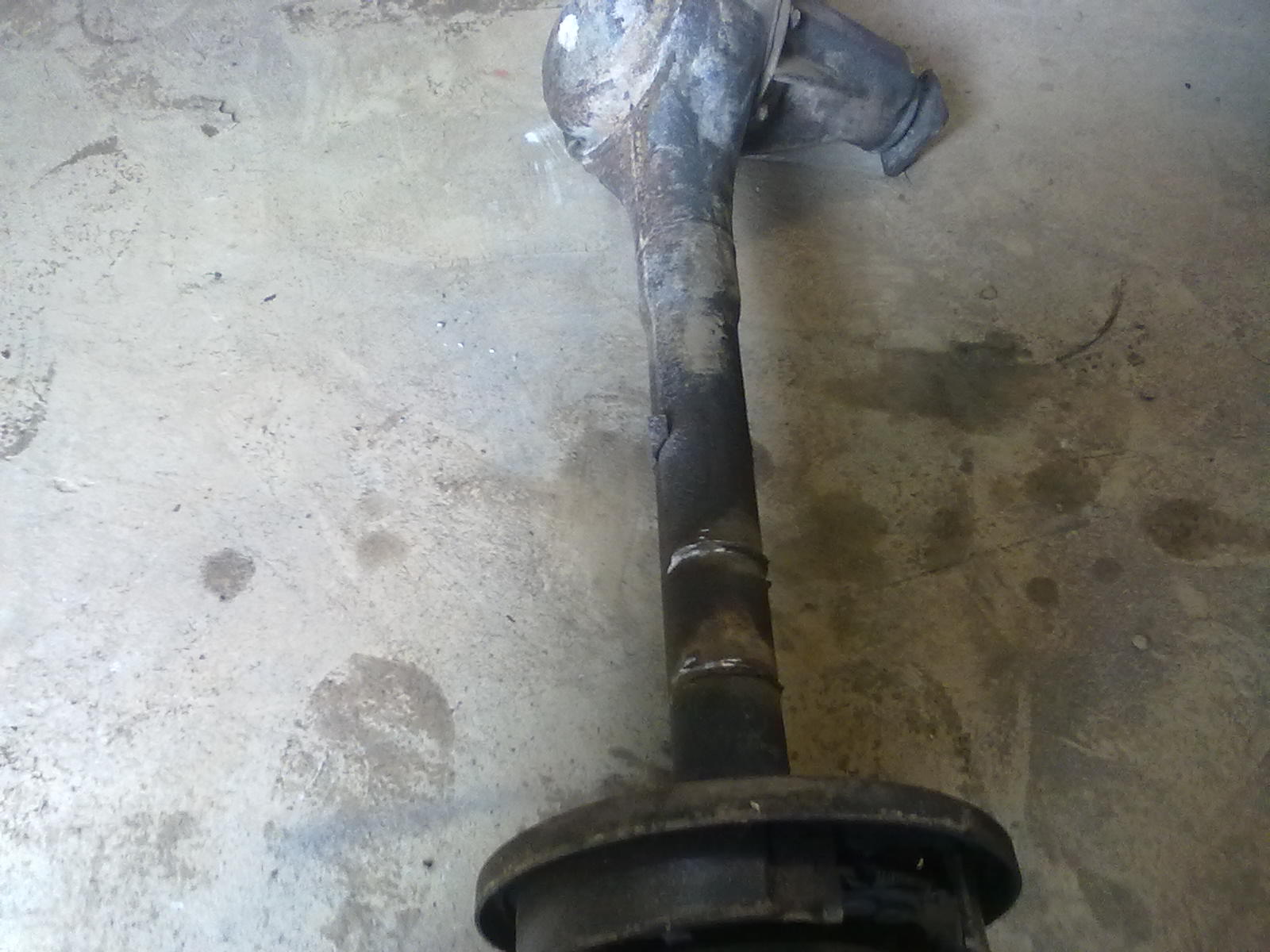

It resulted in cutting the spring mounts off the two diffs and rewelding the 20 spring mounts on the 55 diff. This allows you to set the springs mounts in about 15mm and you can also use either 55 or 20 rear shocks.
You may have issues with the brakes as the standard ke20 master cylinder struggles to move enough fluid to expand the rear brake shoes enough for a good stop.
