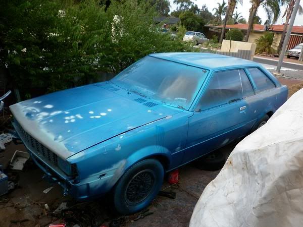

been lurking for a few weeks and thought id introduce myself, I'm from perth and my dad is restoring a t18
is this a te70 t171 te72?
and what r some common mods that people do to these?
i was also looking at the 1uzfe to go in but seems like a lot of work, what r some opinions?

Oh, BTW, it's a TE72, badged in Australia as a T18.
Common mods, depending on what you're looking for include 3TGTE from TT141 Corona or TA63 GT Celicas which gives 160hp and bolts in, AE86 suspension swaps across, with the exception of the rack, but there are ways to fit that too, and 4AGE isn't very hard to fit either, since it uses a T50 gearbox, and the engine crossmember is the same, except for the lack of rack and pinion. Mostly need the engine with bellhousing to suit. Other one that's pretty easy is either 2TG or 3T/2TG hybrid.

Welcome! I'm actually completely new to Rollaclub too, and I couldn't find the "Introduce Yourself" thread, if there is one.. but I saw that you've got a Liftback, as I do, too and wanted to say that's pretty sweet. TE72's are where it's at. HEMI 4-banger, it's a nice bulletproof engine with a good amount of torque.. mines got a Weber 32-36 dual barrel progressive carb and MSD Blaster2 coil and Superconducter leads. works nice.
Joined up to RollaClub to see if I could find info for a suspension build, but haven't gotten there yet :P
Good luck on the build! keep the 3T-C, it'll treat you well!
