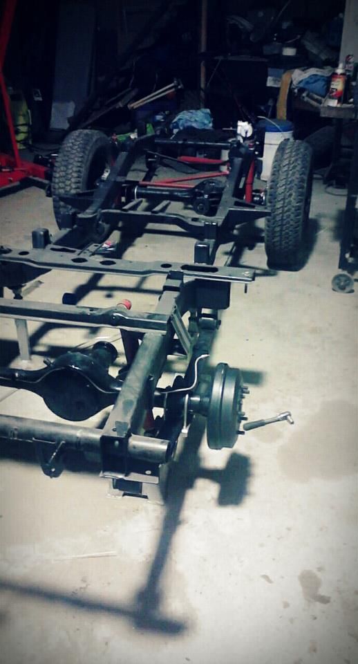

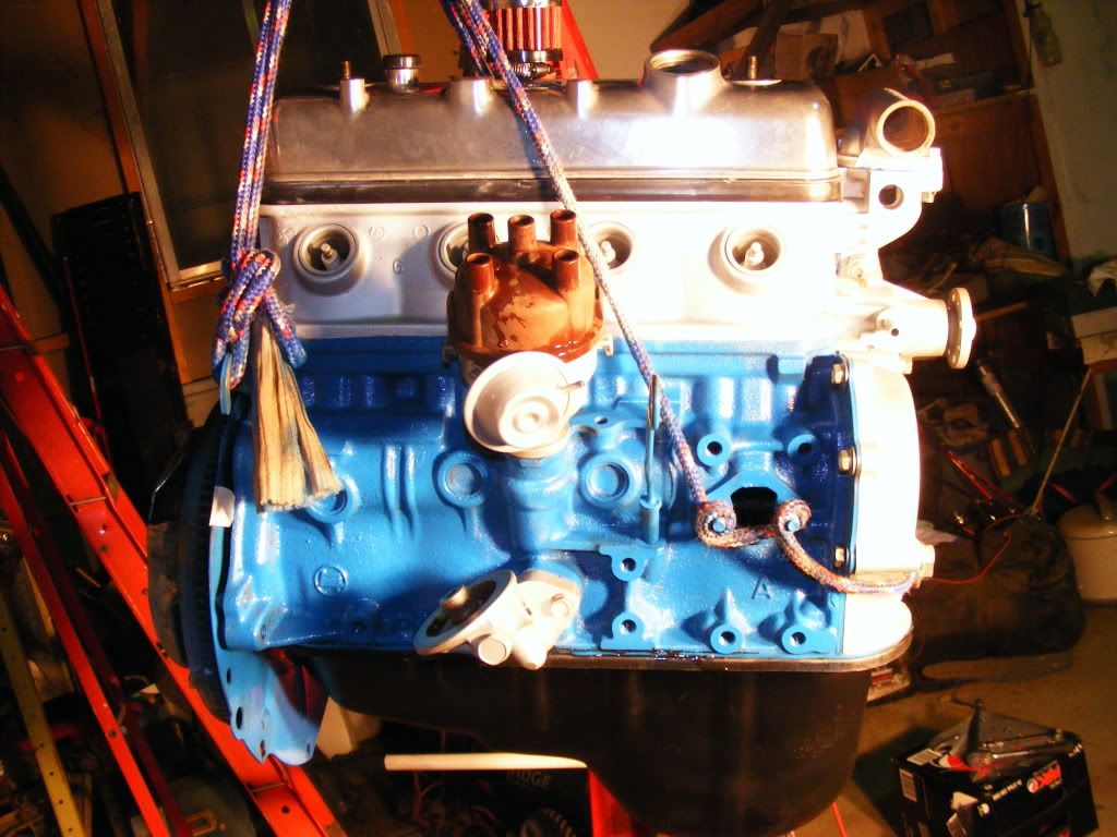

Few pics are where the car is at (fully rebuilding it.)

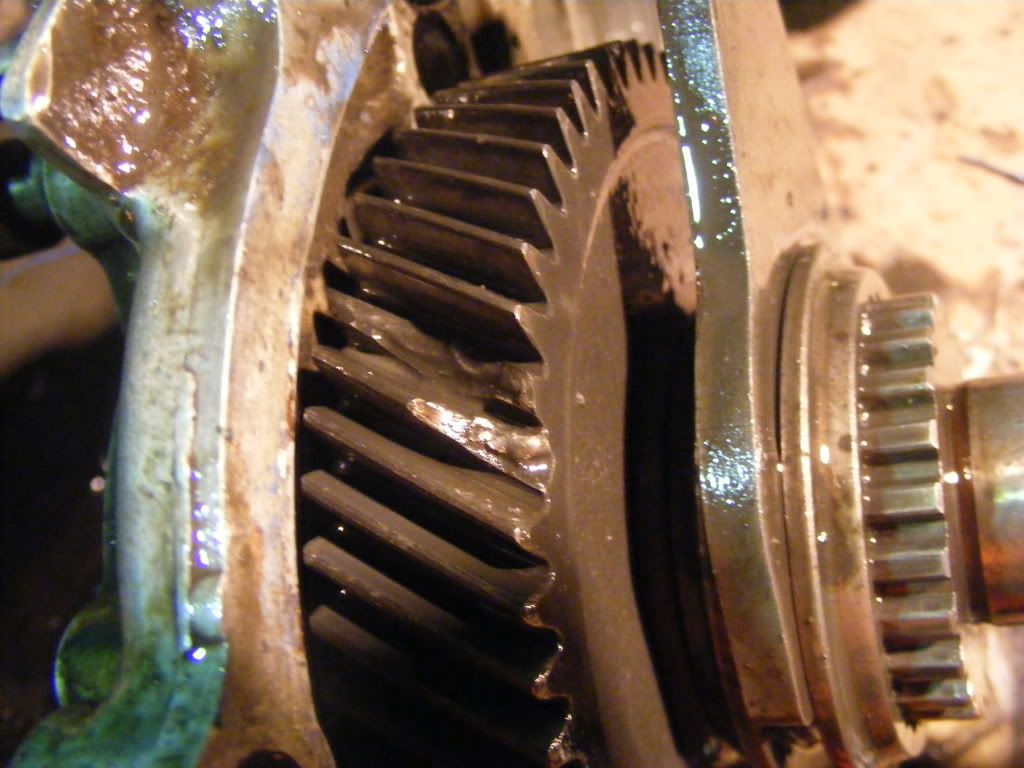

What the 1300cc's of goodness does to a standard sierra transfercase.
