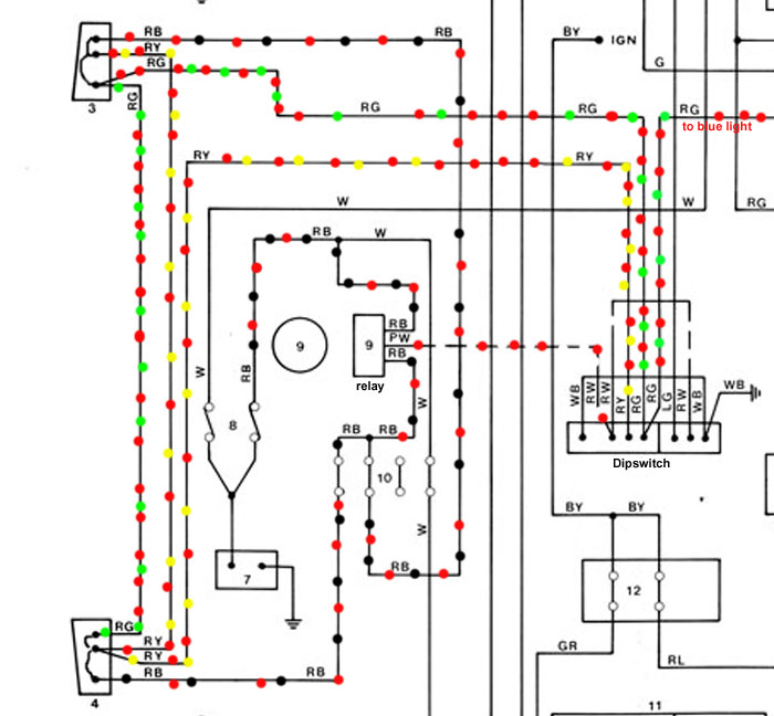

The drawing shows how the lights work, an abysmal system where the relay puts power to both filaments of the bulbs at once, then selectively earths one filament or the other.
You can see why you can have full beam by pulling the dipswitch back, it earths the relay & puts power to the bulbs, then also earths the high beam and the low beam together. So flashing your headlights should be both filaments at once.
When you let it go and it moves to dip, it earths the low beam.
When you push it forward again it earths the high beam only on the other earth point.
The wiring diagram is where it goes in the car. The red/black is the main power wire taking power from the fusible link (8) to the relay, and then through the light fuses and off to each bulb, where it joins both bulb filaments at once. The relay is switched on by the dipswitch stalk being turned and earthing out the R/W wire.
Now both filaments have power, you need to earth one of them to get light, and that's what the red/yellow or red/green wires do. The dipswitch is set up so it earths either dip or full unless you grab 'flash.
The red/black power is obviously OK on your car, and the red/green dip. Seems like you have lost the whole R/Y line through a bad connection somewhere, assuming hte new stalk is working OK All you can do is trace those colours and see where the power ends.

I followed the wires as best i could and found nothing, There are a few old connections in the engine bay though. I don't know what it is called, but the connector under the steering shaft, that connects 30 or so wires. I undid this, blew in it and plugged it back in, and problem solved. how easy was that hey? I also noticed that a wire in there had melted some of the plastic around it....
