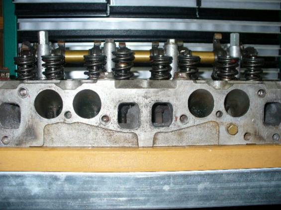

I search around for a bit, and I think this is a 3k-b head:
I think there is a brass bolt below the fourth intake port, to plug up the water port for the heated manifold.
