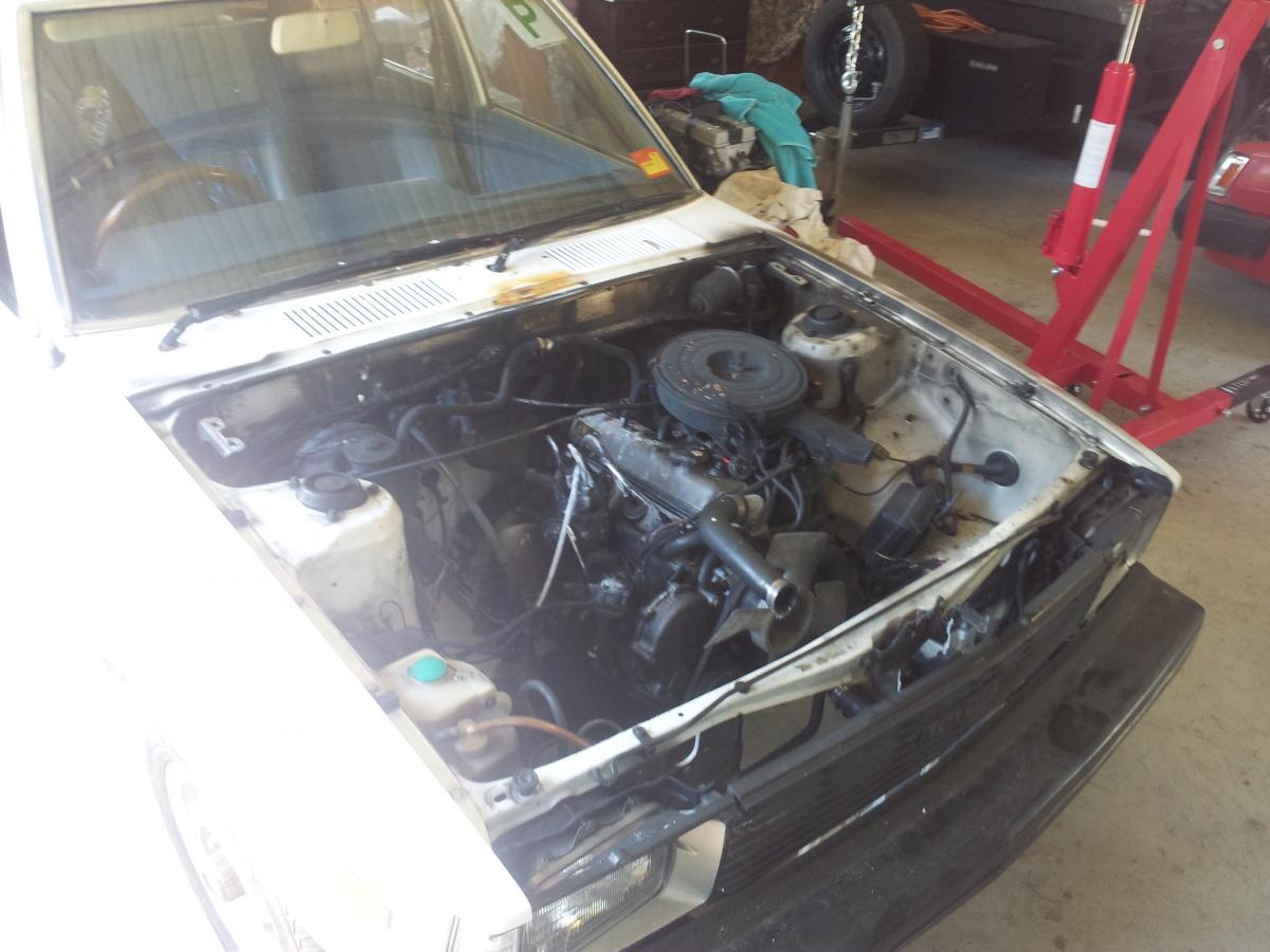

This is my 1983 toyota corolla ke70, she has 180,000ks on the clock. At the monent I'm half way into a heart transplant, I'm putting a 4age motor and a t50 gear box into her because my 4k caught on fire :S
When i got her she was stock as a rock and i planned to keep her that way, Stock and clean to show the kids in 20 years after all the ke70/ae71s have been drift hacked, but after the fire i didnt want to see her go to waste and i wanted more power :D as everyone does haha.

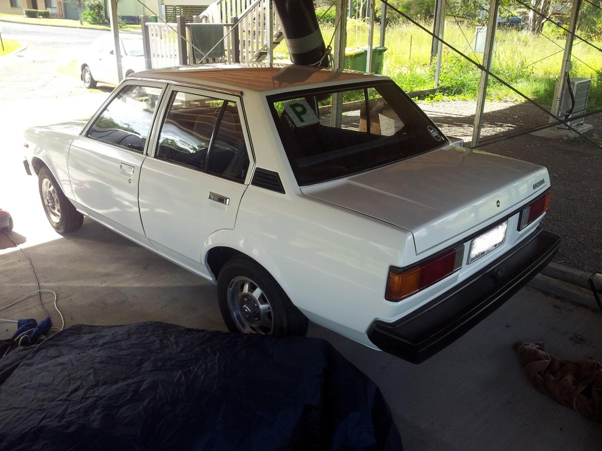

^ this pic is a few days after i picker her up. all nice and clean after her bath :D

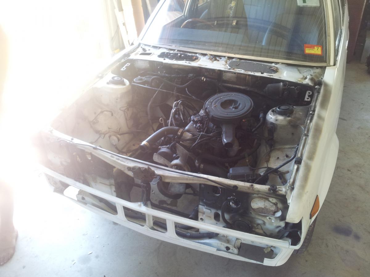

^ The day my heart broke... the return fuel line came off the fuel pump. almost made me cry, srsly.

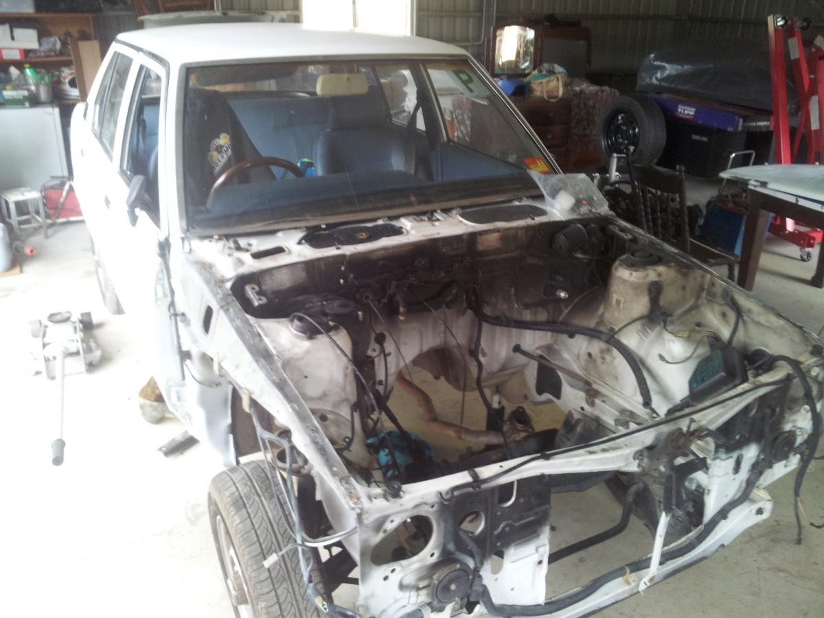

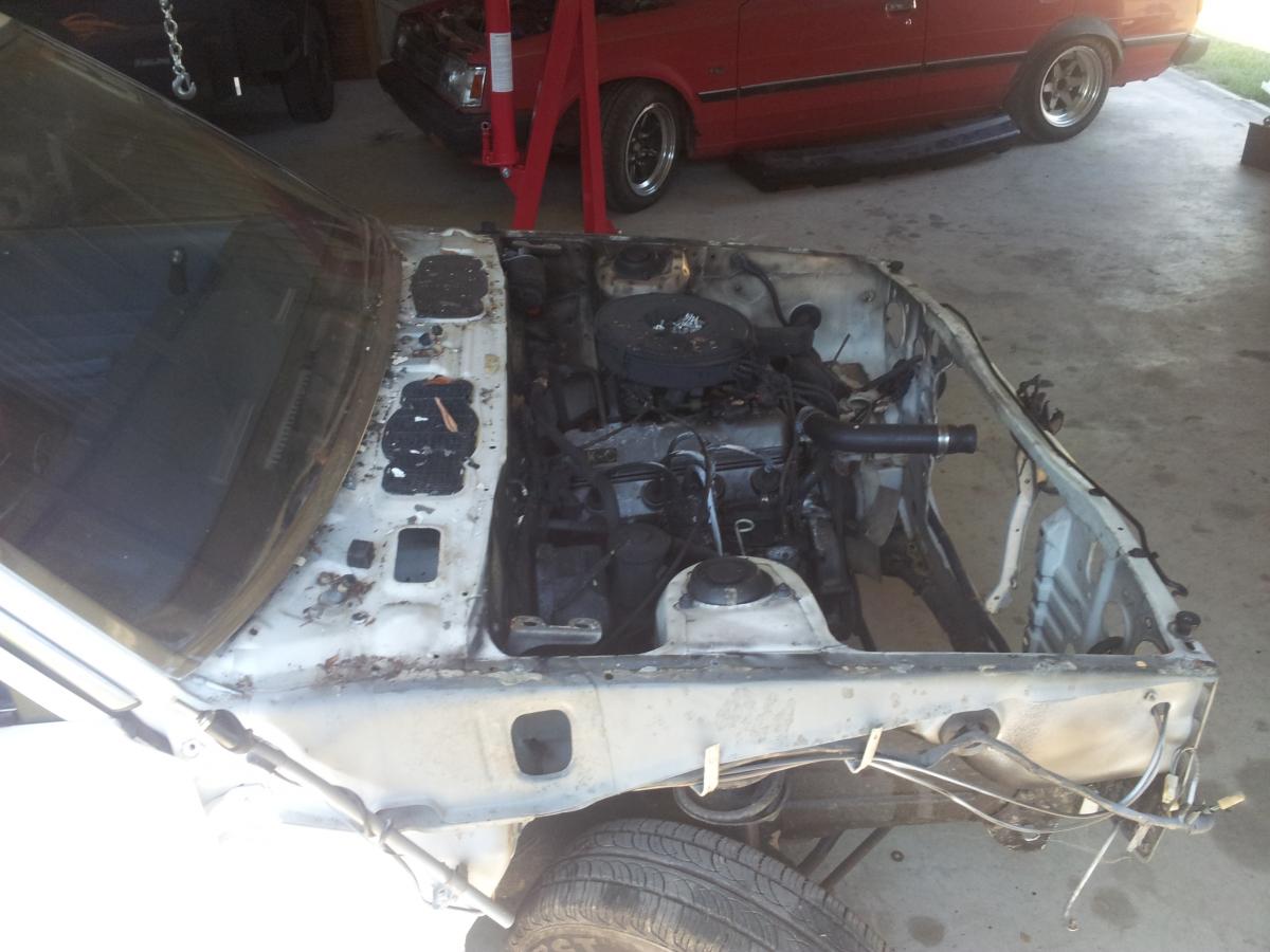

Just a few pics of the build :)
Mods in progress or complete
Motor is a 4age 16v from a ae86. Just been rebuild.
Microtech LT-10s ECU with loom.
Gear box is a t50 5speed from a ae86.
The tail shaft is from a Ae71.
Diff is a G282 1410mm long, from a rn41. still needs to have the mounts transfered over.
The cluster is got is the one with the tacho from a ae71.
Ae71 Pedal Box and a new ae71 master and slave from the clutch with new braided line.
Recond R33 Skyline brake booster and new Braided brake lines from head to toe.
ae71 engine and gearbox crossmembers (Just been painted).
500ml surge tank, lift pump and HF fuel pump next to the fuel tank.
Semi sealed h4 lights and a few other things i forget right now :D

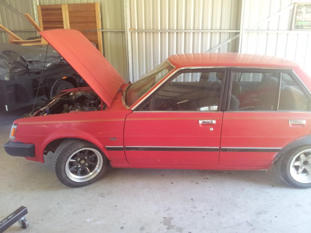

^ My ae71 that I'm getting all the stuff i need out of. Poor thing has seen a hard life (not by me)
