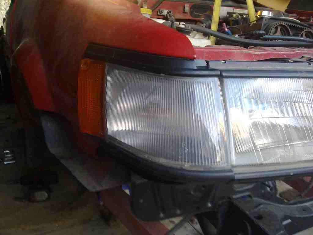

While I had the car in the carport I tackled something that has been bugging me for ages, the body loom that runs around the front of the car was going behind the rad support, thus putting it inbetween the radiator and the rad support. I could never get the radiator to sit hard against the support. So i unplugged the harness from the passneger footwell and fed it through so I could re position it on the FRONT of the rad support.
To do this I had to remove all the lights and brackets:

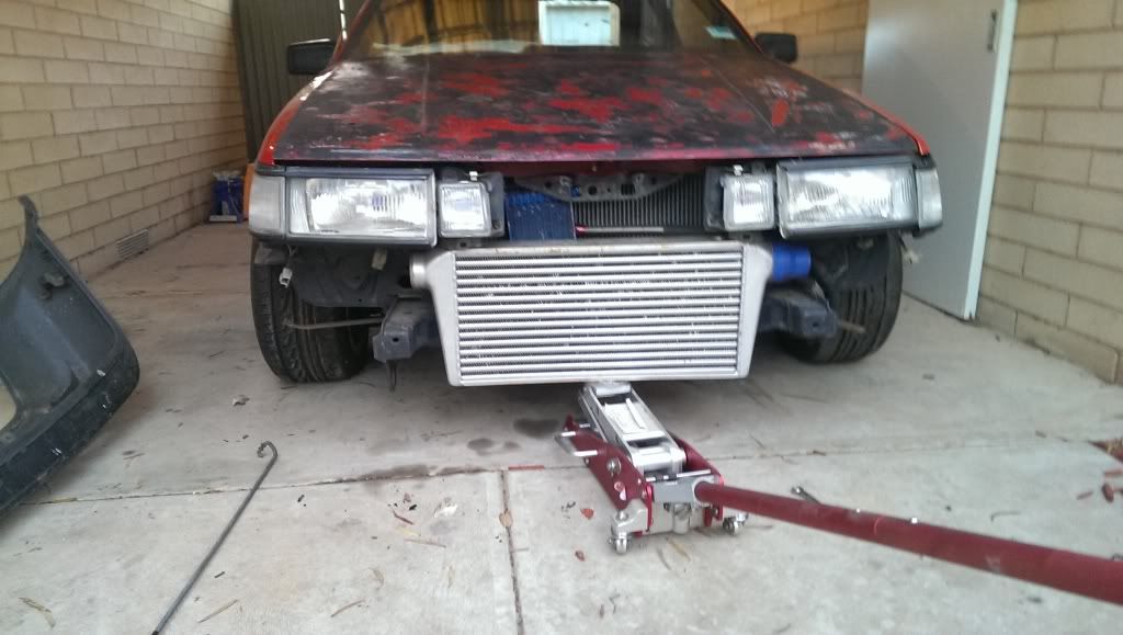

Once that was all done, I moked up all the various cooling components that will fill the front end:
And just a mock up of how it will look, bonnet needs painting and so does front bar (and a lip):

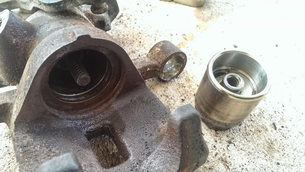

I thought id tackle the rear brakes, AJPS s13 upgrade. This stuff has never been apart before so I thought it would bring fun times:
After removing that ol busted shit, and some serious bashing and swearing I finally got this bastard out:
Rinse and repeat for the other side. Now.......it was about this time I thought "Hmmm I have no idea what diff centre is in this thing," plus I really wanted to know what ratio is in it. Considering the axles are out, its only a few more nuts and bolts and the centre will fall out. So i ripped the centre out and boy was I happy I did!!!!!!!
