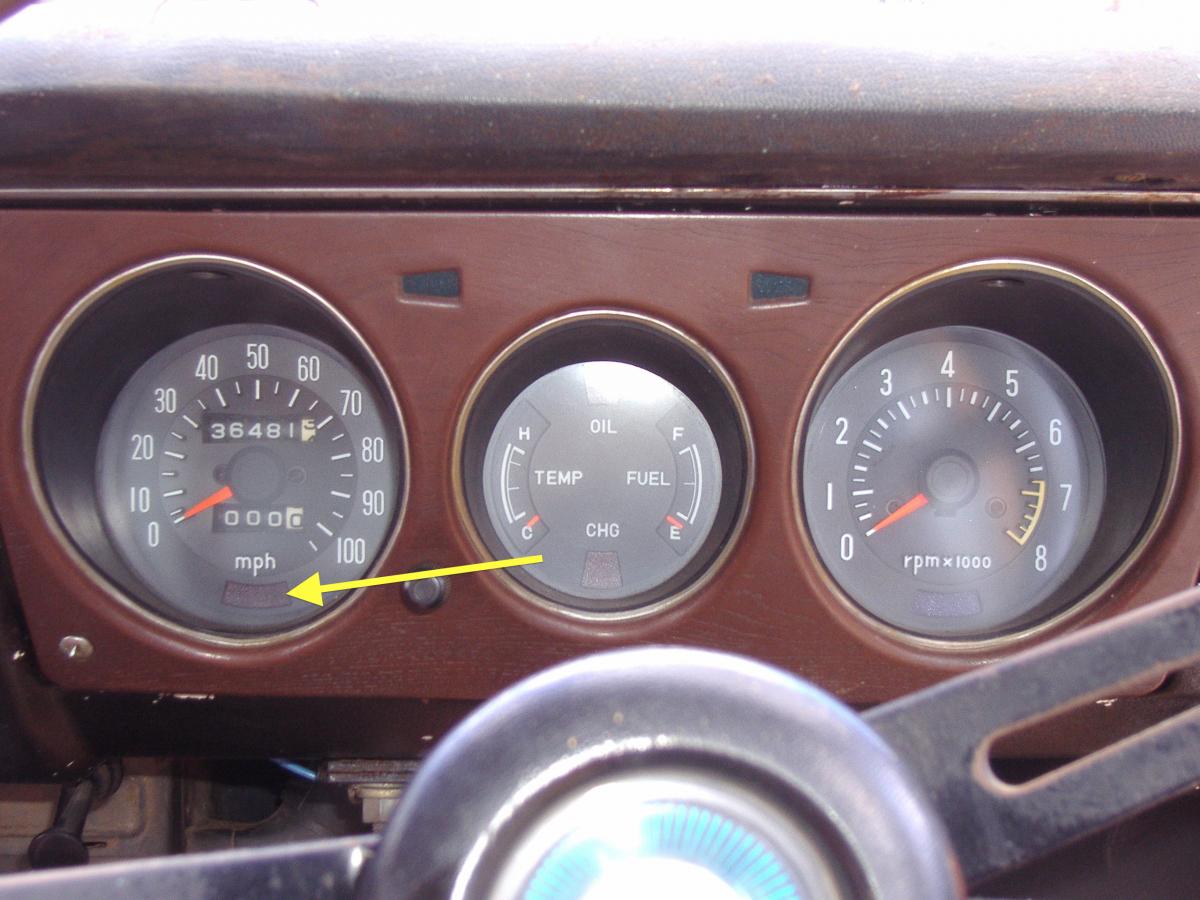

  5. Light in question is marked with yellow line. I can't quite make out what it says in this picture, and the one on my car has the red lense missing or pushed in. Currently it is on constantly in my car. Thanks. (Note: Picture courtesy of Google images).
