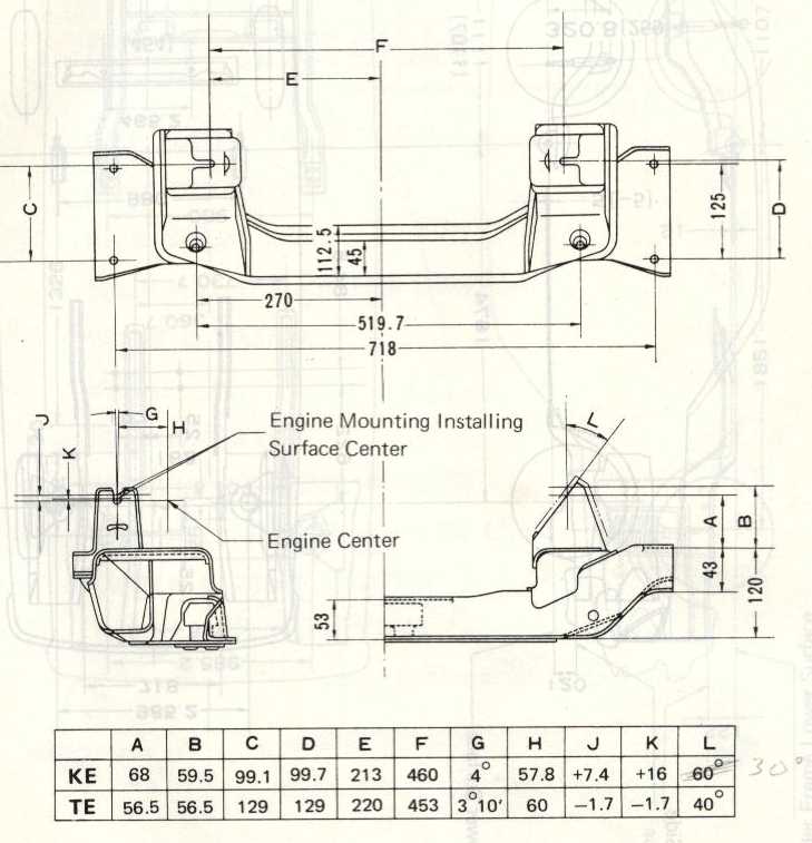

Need a quick bit of help with some dimensions please- regards a ke55, want to know overall width of front crossmember,drum face to drum face and dimension between the chassis mounting bolts,front and rear AND between left rail and right rail.Thanks
This image often comes up any time someone wants to know the difference between KE and TE cross members.
It's probably taken from the factory body/chassis manual, which come up on ebay from time to time - you'll likely need it for the rest of your measurements, though I'm sure someone here would have a copy!
