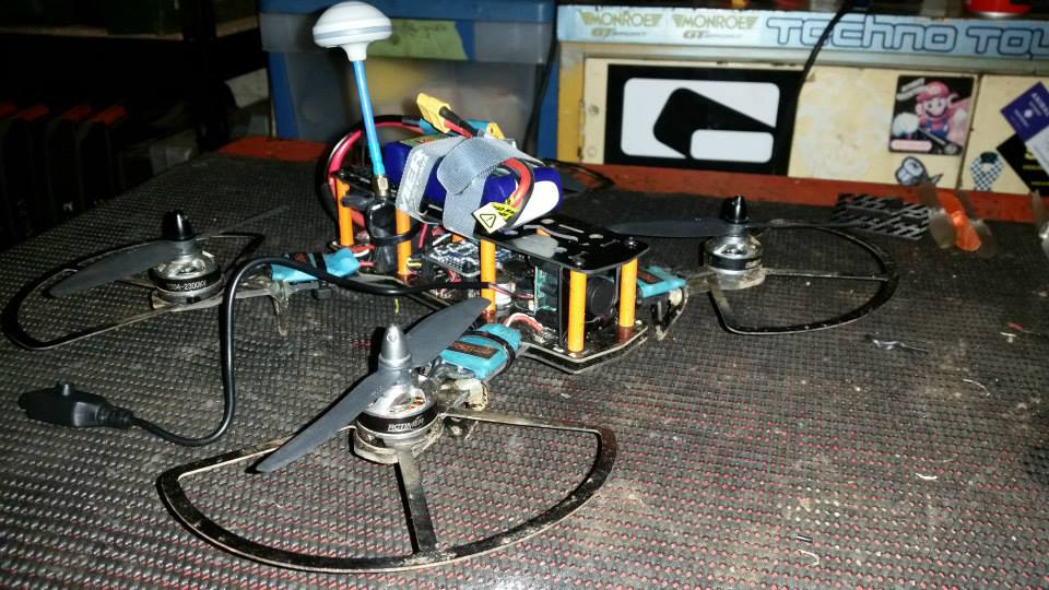

Expensive lesson learnt, Version 2 was built. Incorporating a front-mounted camera, video transmitter & a radio tracking device with a 3km range. All components were removed from cases etc & hard-wired to save weight by eliminating as much wire & plugs as possible. Also makes the setup much cleaner, no rats nest of wires going everywhere.

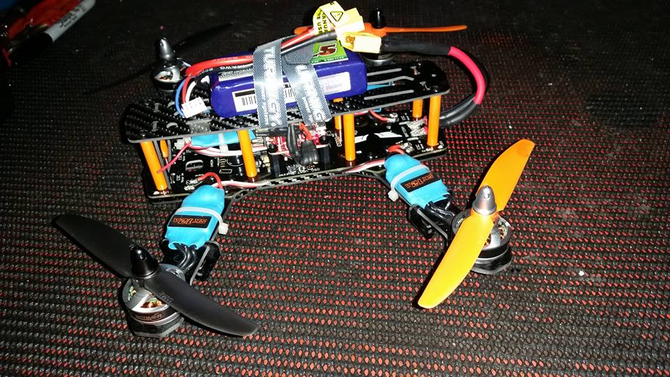

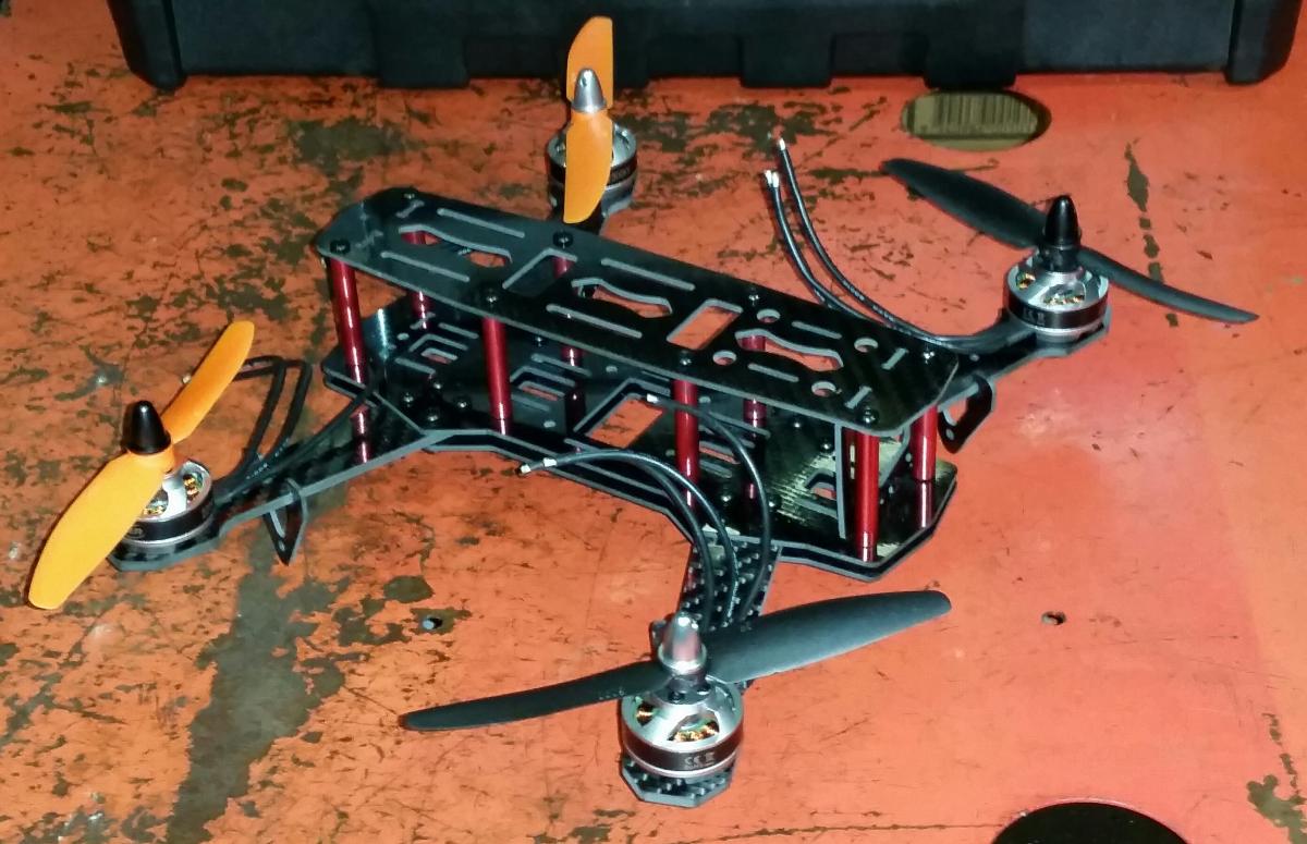

Frame
- ZMR250, carbon fibre 3mm upper/lower plates, 5mm arms & 3mm landing ‘legs’. Aluminium stand-off posts with metal M3 fasteners.

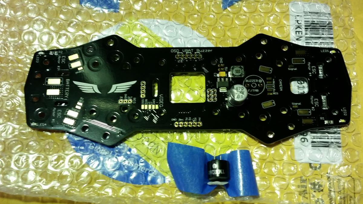

Power Distribution Board
- Team Legit Overcraft V1.2 PDB, with built in LED’s (white – front, red – rear), 100A power wires with XT60 connector. Allows for a very neat, minimal wires setup.

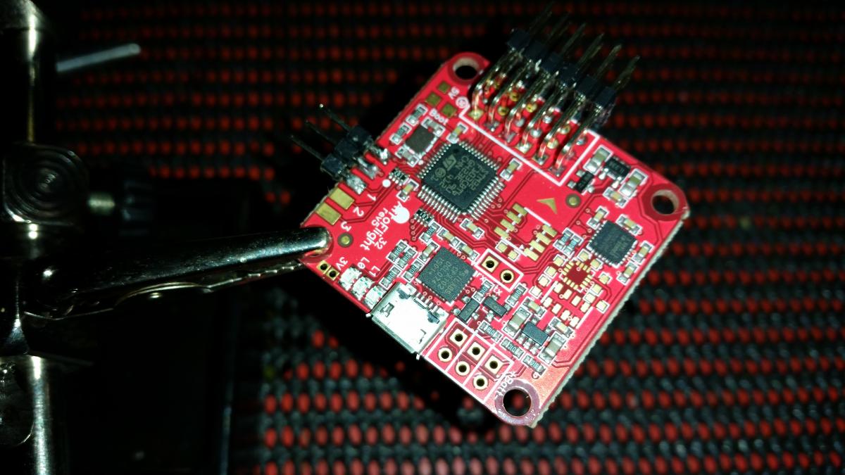

Flight Controller
- Afroflight Naze32 ‘Full’, 32 bit processor, built-in gyro/accelerometer/compass/barometer. Mounted on nylon stand-offs, more features than I’ll ever use.

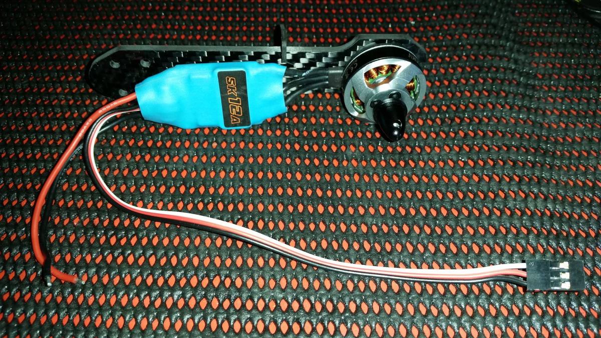

Electronic Speed Controllers
- SimonK firmware, 12A x4, modified wiring & heatshrink.
Motors
- RC Timer 2204-2300KV x4.
Receiver
- OrangeRX RX615X, 2.4GHZ 8 channel. Removed from plastic case & heat-shrinked.

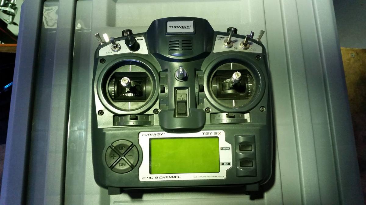

Transmitter/Transmitter Module
- Turnigy 9X with 9XR firmware, 9 channel, modified battery housing.
- Orange RX DSM2/DSMX, 2.4GHZ.
Propellers
- Gemfan ABS-plastic 5030 x4 or Gemfan CRP 5030 x4.

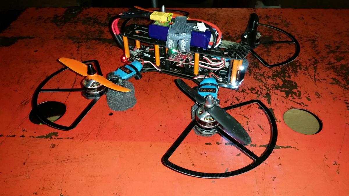

- Diatone carbon fibre propeller guards x4. Also shown here with foam landing pads to assist me in learning the art of landing, as opposed to semi-controlled crashing.

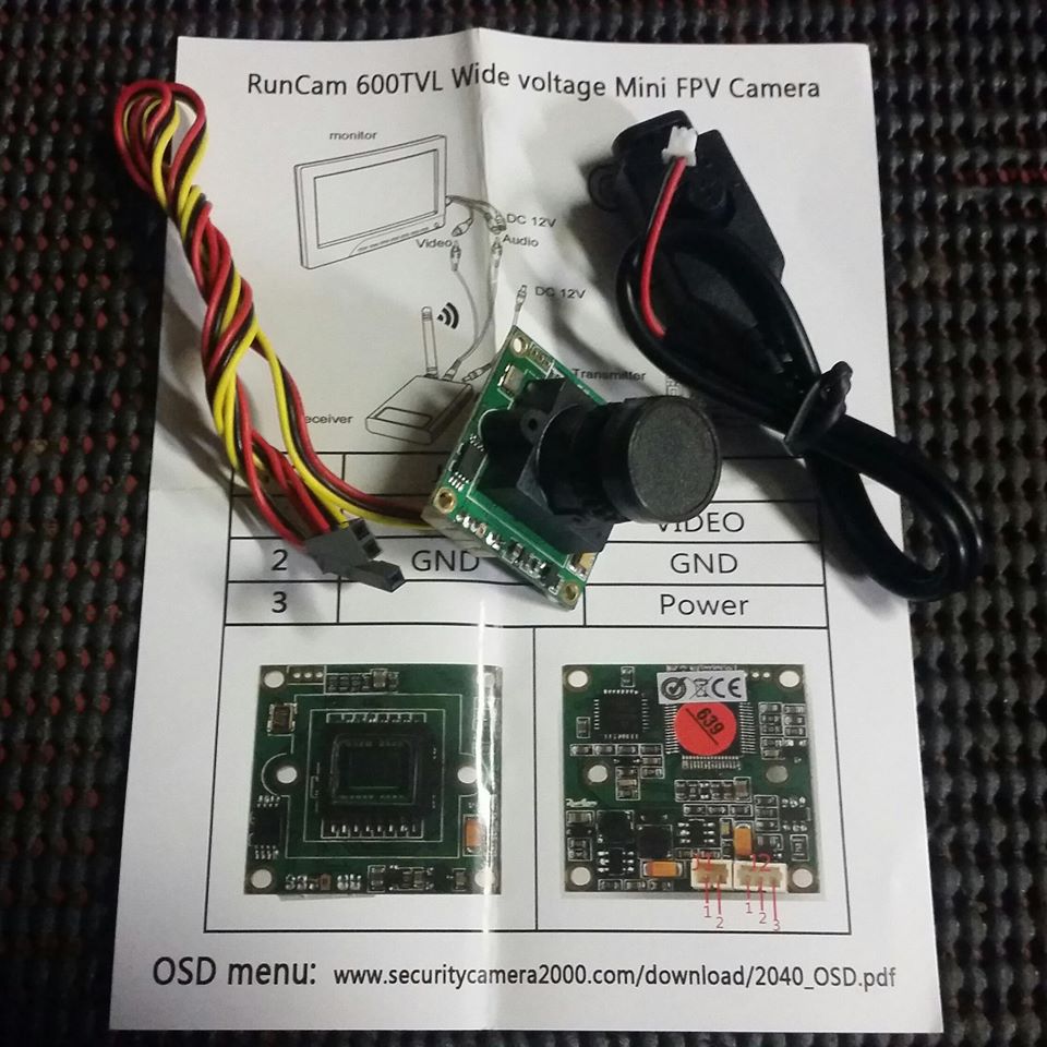

On Version 2, I added:
Camera
- Runcam 600TVL (Sony copy), 3.6mm lens.

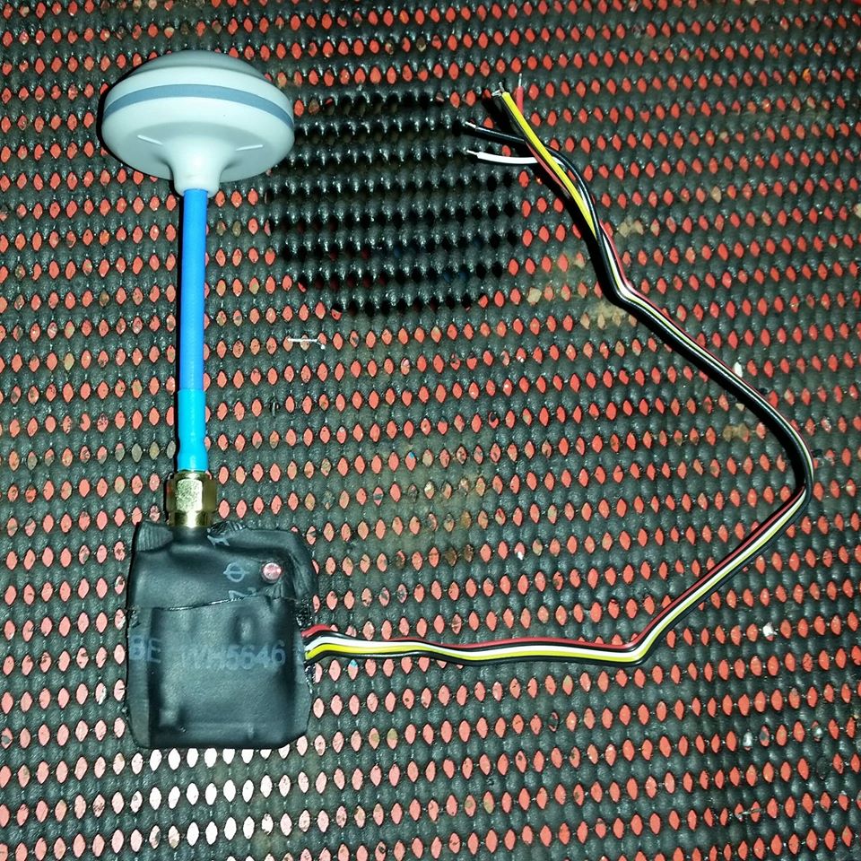

Video Transmitter/Receiver
- Foxtech TS58500 5.8GHZ 500mw AV Transmitter.
- Foxtech RC832 5.8GHZ 32 channel VRX.
- Dual-band RPSMA mushroom antenna x2.

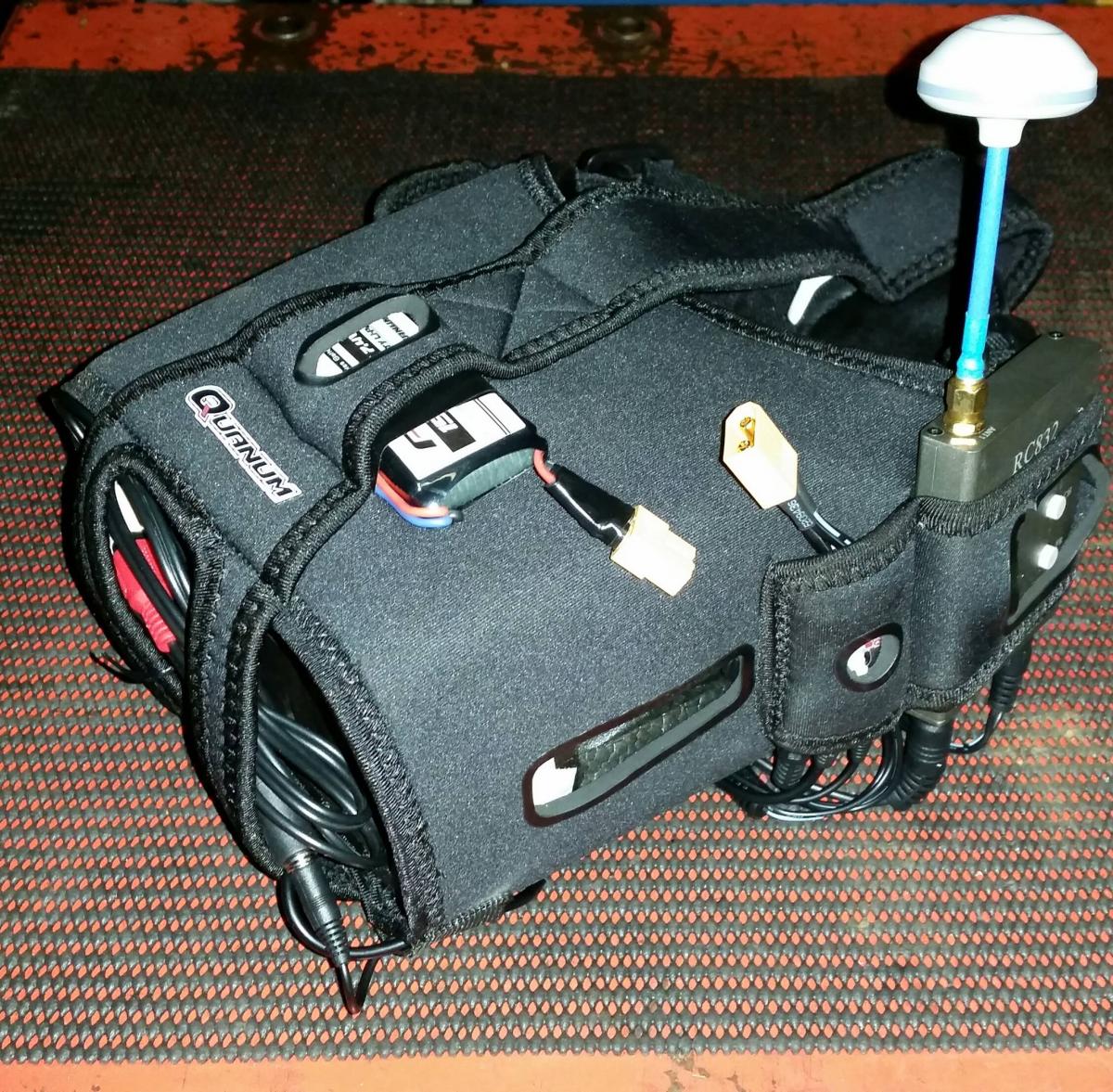

Headset
- Quanum FPV Goggles V2, 5” LCD monitor, affectionately known as a “Face Esky”.

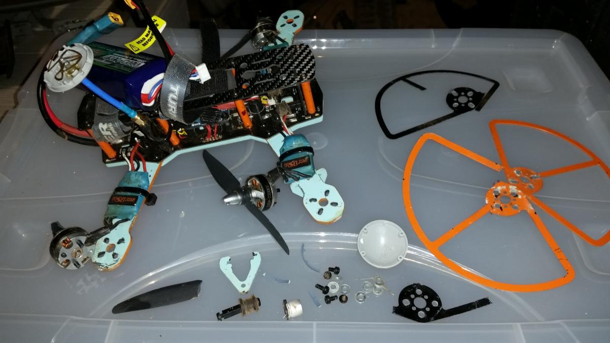

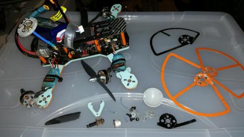

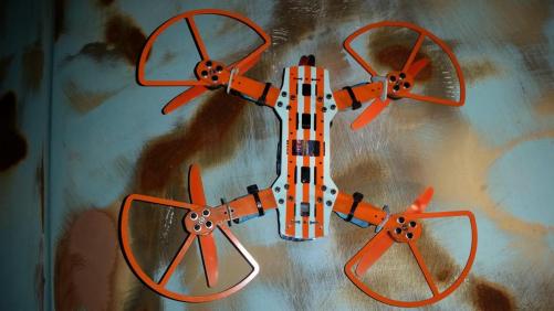

Gave FPV flight a go solo (without someone else as a spotter) for the first time on the weekend, didn't crash despite going through three battery packs (approx 7 - 9min flight time each). Then went back to free-flying & promptly launched it into my back fence. Smashed it up a bit, so while I was fixing it, I swapped some bits I prepared earlier.
post-5437-0-60481500-1440062709_thumb.jpg post-5437-0-54671800-1440062719_thumb.jpg

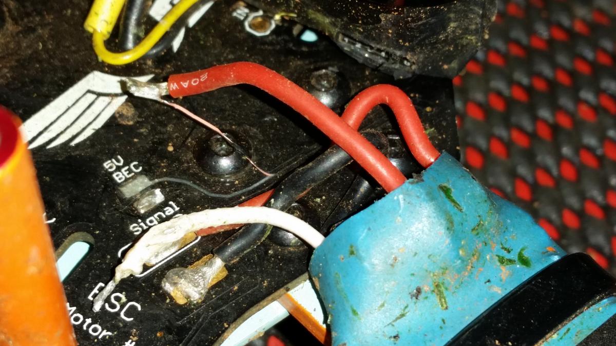

After multiple rounds of combat, it seems the magpie scored a few points. Took out the flight controller power supply & it was a straight drop to the ground from there. PDB is damaged beyond repair, now that they are available again, I have some coming from the states.

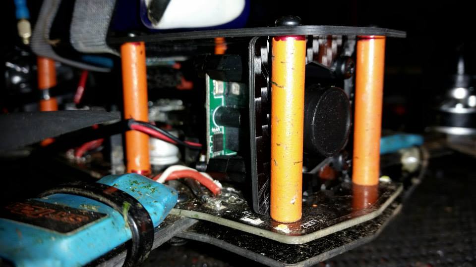

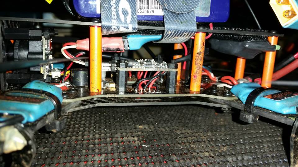

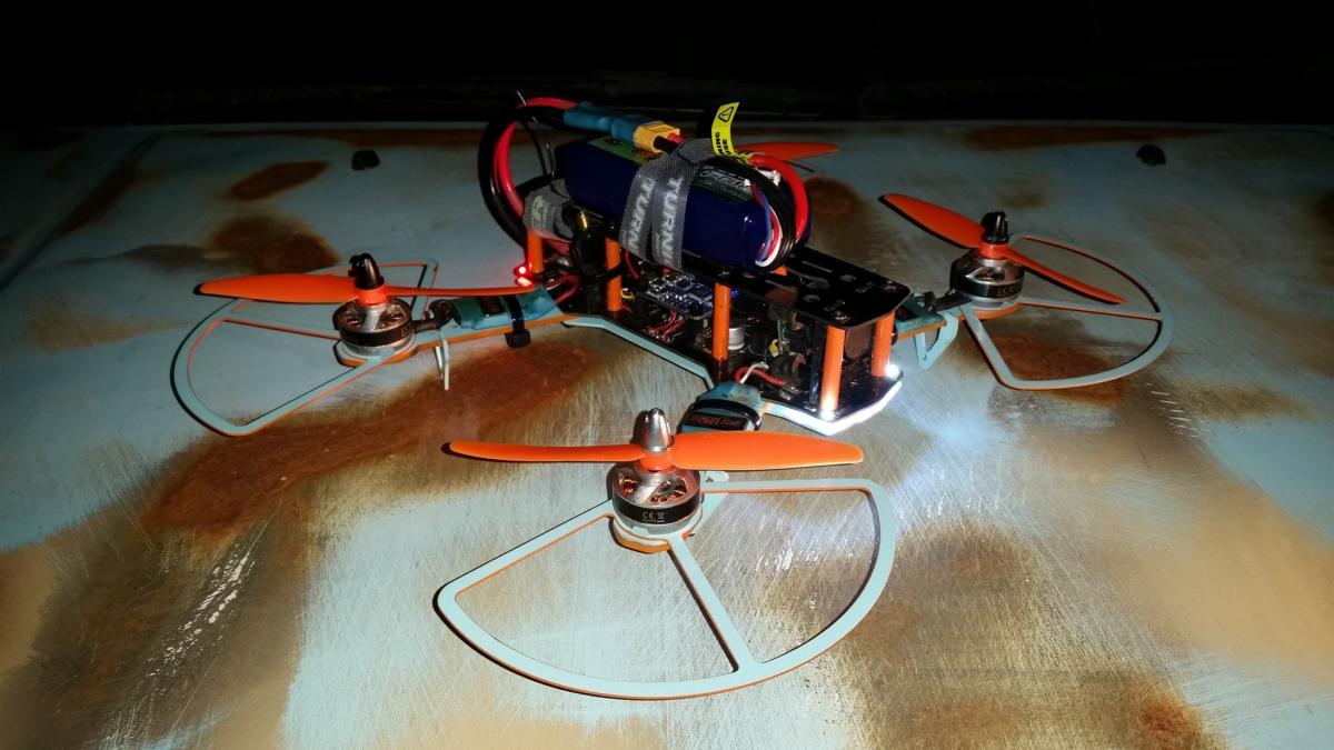

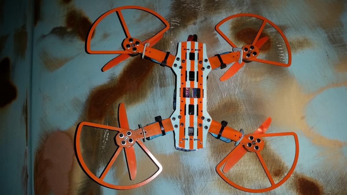

Spent some time installing some Need For Speed Underground type upgrades. Not exactly performance based, but they do make it easier to see & doesn't drain too much power in the process.
post-5437-0-80896000-1441412833_thumb.jpg post-5437-0-63128100-1441412864_thumb.jpg
post-5437-0-33464200-1441412917_thumb.jpg post-5437-0-58183500-1441412987_thumb.jpg
post-5437-0-76679300-1441413108_thumb.jpg post-5437-0-51068300-1441413146_thumb.jpg
I didn't know pizza places made motors...
Put it on some scales, full flight weight comes in at 642 grams, 199 of which is the 2200mah battery. The 1500's are 129 grams, not much but noticable when flying, about 7-8 minutes flight time from them & 10-11 minutes from the 2200's.
