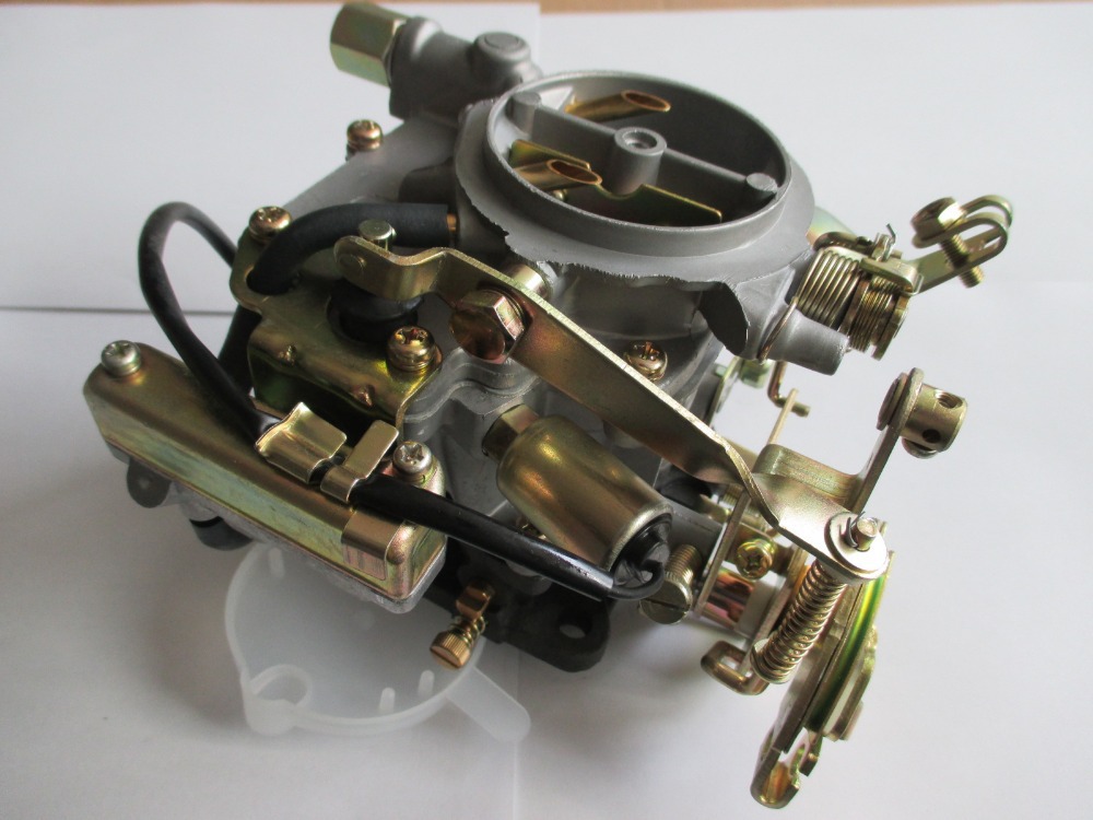

I got myself a 4k carby to replace the forklift carburettor some monkey had retrofitted but this carby that i bought is the most simple f all the 4k carbies i have seen online.
It simply has one vacuum port from just next to the fuel inlet which I have taken apart and confirmed is connected to the vacuum port just above (before) the throttle plate,
There is also one well below the throttle in the rubbery adaptor plate between the carby and the manifold. (manifold vacuum).
I can not get my vacuum advance to work properly.

I can not determine what the difference is between my carburettor:

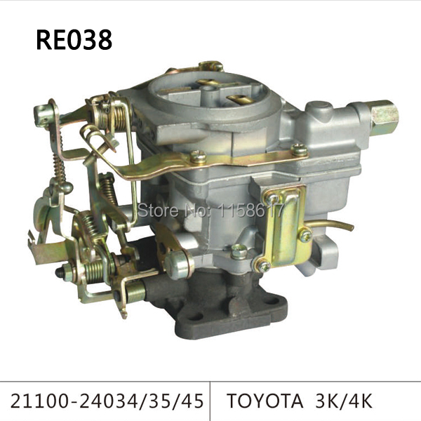

and this common variant:
