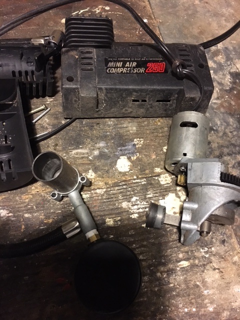

So I managed to overheat my mini compressor recently with the result that I now have no compression!
On strip down, it appears I have glazed the bore and worn the ring.
I was thinking I could hone it with my hydraulic cylinder hone, but not to sure how to sort the carbon ring. Any ideas?
  • 2 months later...
piston ring from a whipper sniper?
what size bore?
