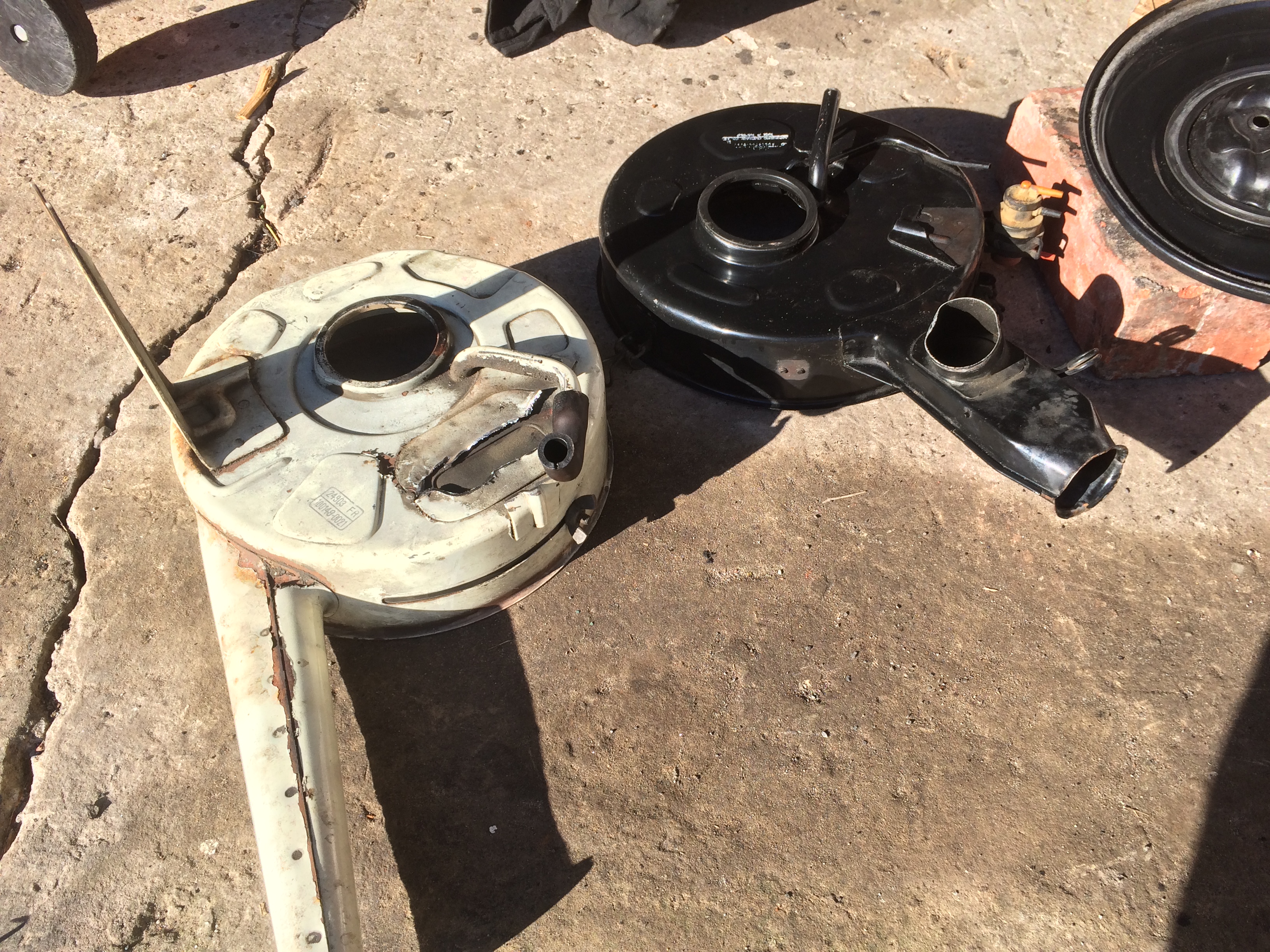

I've put a KE70 4k into my KE35 but it didn't come with the air filter. I tried to put a 3K air filter on and the heat riser duct was getting in the way so I cut it off, but the accelerator bracket and throttle position diaphragm on the carby gets in the way.

3k's run an early type carby which is a bit different that the 4k one. Just find another air box from a ke70, there are quite a few wrecking around. Or else, you can just use a RamFlo type :)
Found a KE70 air filter box today. Installed it and all good.
The KE70 one has more of a protrusion where it sits on top of the carby. Also takes a flatter air filter compared with the KE3X one
