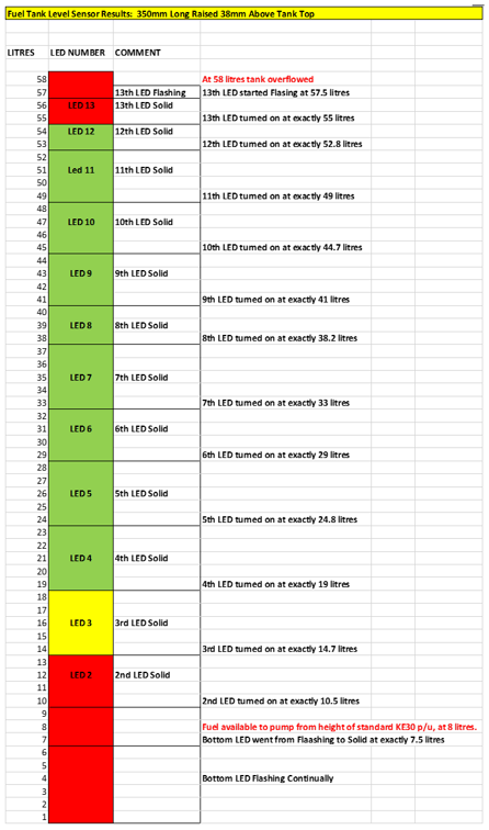

My careful testing, was not too scientific, or in a laboratory, but it worked. It took over an hour to do this simple test, as the water had to be added a litre at a time, so that the water trickled into the tank, & didn't cause any "waves', or create disruption of the  water level surface.
The results of the test were very encouraging, although I won't be able to use all 14 off switched level point in the sensor, as the lowest one, is below the point, where fuel can be sucked out by the pump.  I could possibly lower the pick up point a bit, but think, I'll just stick with 13 switch points rather than the 14 available.

I was pleasantly surprised, that the two top LED & switching points arrived, before the tank filled. As soon the last top LED illuminated, at 57.5 litres, I stopped filling.  I then took the central pick up assembly out, & believe it or not, the water level was less than 1 cm below the top of the tank.  I carefully added more water, & after half a litre the tank was just over flowing.  The positioning of the top , or highest switching point, is nearly perfect.   It also indicates the tank is closer to 60 litres than I thought.
The useful capacity of the tank with the standard pick up point, is about 47.5 litre, or 45 litres, if you want to avoid running out of petrol.

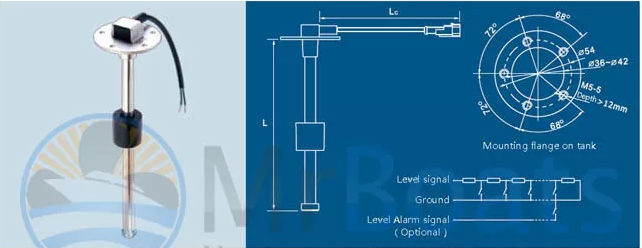

I've just come across a diagram, on the net, that depicts how the internals of these fuel level sensors work.
It appears it is a set of magnetic reed switches, that switch a string of resistances, in & out of the circuit.

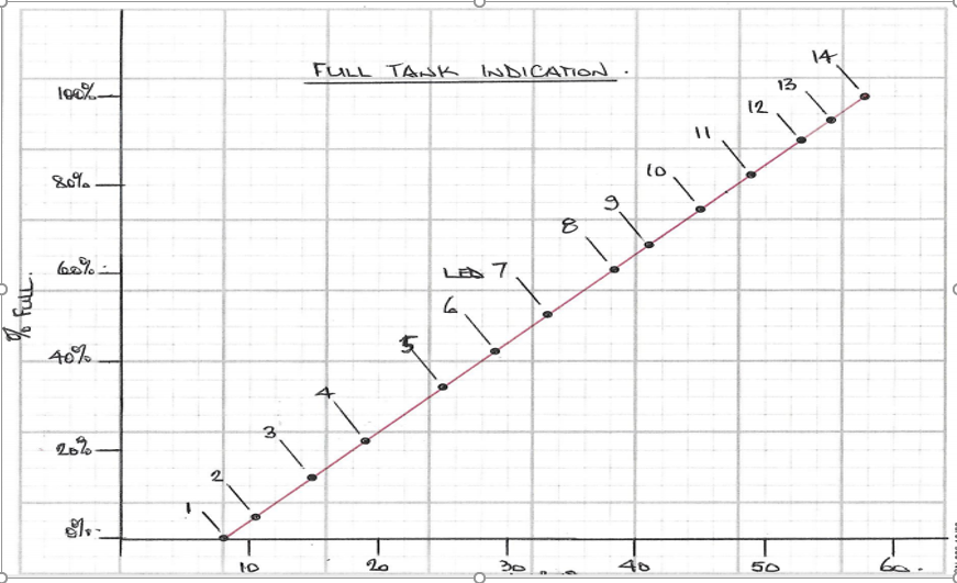

I plotted out the results on a bit of graph paper, to see what the linearity was like.
As the last 8 litres of the capacity of the tank is not usable, I have made that point 0% full.
If the linearity was perfect, then the spacings along the red line, of the LED switching points, between 0% & 100%, would be equally spaced.
It was never going to be perfect, as the positioning of the reed switches inside the vertical Stainless steel tube, are not equally spaced, as depicted by the bits of tape I stuck on the tube, at the point, where the switches actually switched.
The spacing between LEDs 4 & 5, & LEDs 7 & 8 switching on, are a bit wider than the others.  The switching points, right at the bottom & right at the top, are a little close together.  I could also not utilise switching points no: 2 & no: 13, which would linearise it a little better, & just use two less LEDs.
So I think, I might just pop it all in the car, & drive it around for a couple of weeks, or a few tank fulls, & see what it "feels like", in practice.
It's got to be better than the original needle gauge on my KE30, & much more reliable.
