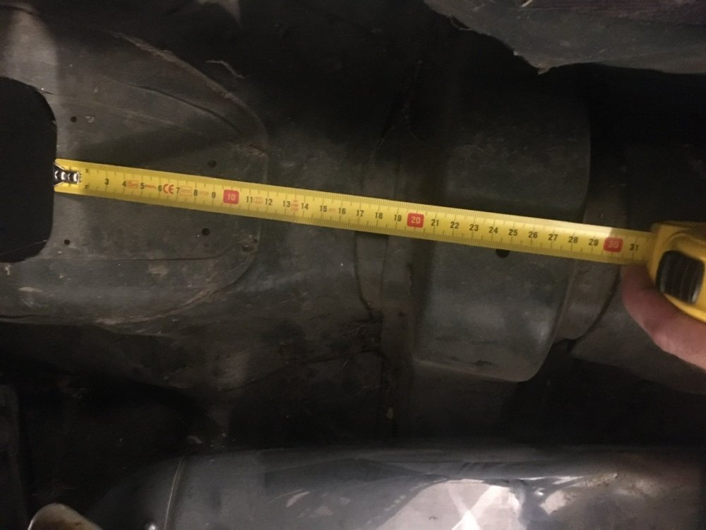

I have a ke25 that is getting a 2tg and a t50 trans. Does anyone know if i need to move my shifter hole backwards? if so, how much?

2 hours ago, parrot said:
DB28264C-86AC-41D9-BF07-BA6C92592CA5.thumb.jpeg.eb99e55e72f672bbf1bcddf4ff529e7a.jpegCD15EDED-2772-4040-926F-D535F863BB81.thumb.jpeg.87f8d35999c2446d898ef3cf6fb3f047.jpeg
Note I’ve measured to the centre of the factory hole in the centre of the tunnel reinforcement
Thank you!! This will definitely help me :)
Hmm i checked now. This is exactly the same measurements As in My ke25
