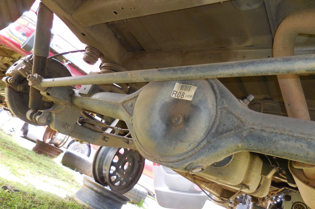

I took the easy route and used a Celica, also wider but nowhere near the arches with stock rims.  However the Hilux seems to be the most common conversion, although if you're at a wrecker take a look under the newer vans.  There are 5-linked rear diffs with disc brakes under some of the vans, and they look lighter than the Hilux.
