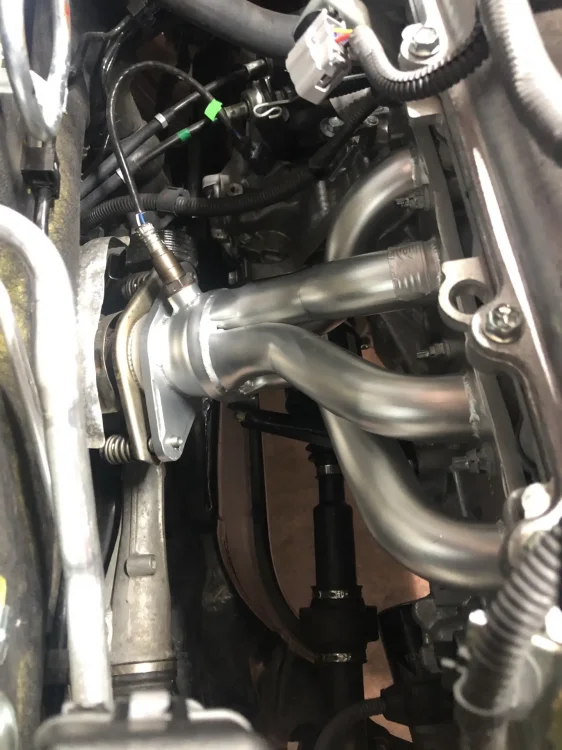

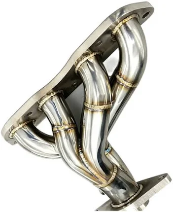

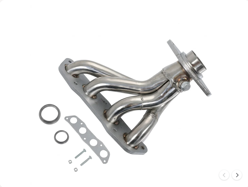

Saturday at 06:23 AM2 days Author comment_738743 I've been trying to find information regarding modifications for this car. There's a lot of dead ends. In fact nearly everything ends in a dead end. Most likely because the strict standards placed on these cars regarding noise and emissions. But.... we don't care about that much do we?So exhaust is next. Thinking a 2 inch mandrel system with Lukey megaflow resonator in the mid and muffler in the rear. I'm pretty desperate to change the headers as well. It has some bloody hideous pressed metal thing with a close couple catalyst. The headers are dead set hard to find. There's some junk on ali express or baba and a couple of providers in the US that don't ship to Aus. monkeywrench racing and performance chip tuning.Then there's Lotus. The 2ZR-FE and EC60 6 speed was also used in the S3 Lotus Elise in a supercharged configuration putting down 245hp and 275hp depending on the option. Internally identical engine and gearbox. Just a blower and a tune. But damn that shit is priced out of this world. Something like 9000 euro for the supercharger kit. I've hit up Genie about a set as well. We'll see how that goes. I'd be keen to keep the close coupled catalyst setup with a tight little 4-1 header to keep it all factory looking and avoid having to do any wiring or ecu stuff at this point.I've read the 1zz uses the same intake and exhaust flange design also. Not sure I want dive into that either. Edited Saturday at 06:30 AM2 days by GJM85 Report
Saturday at 09:51 AM2 days Author comment_738744 Maybe this one.https://rrrshop.co.uk/collections/2zr-lotus-parts/products/pb-racing-exhaust-manifild Report
