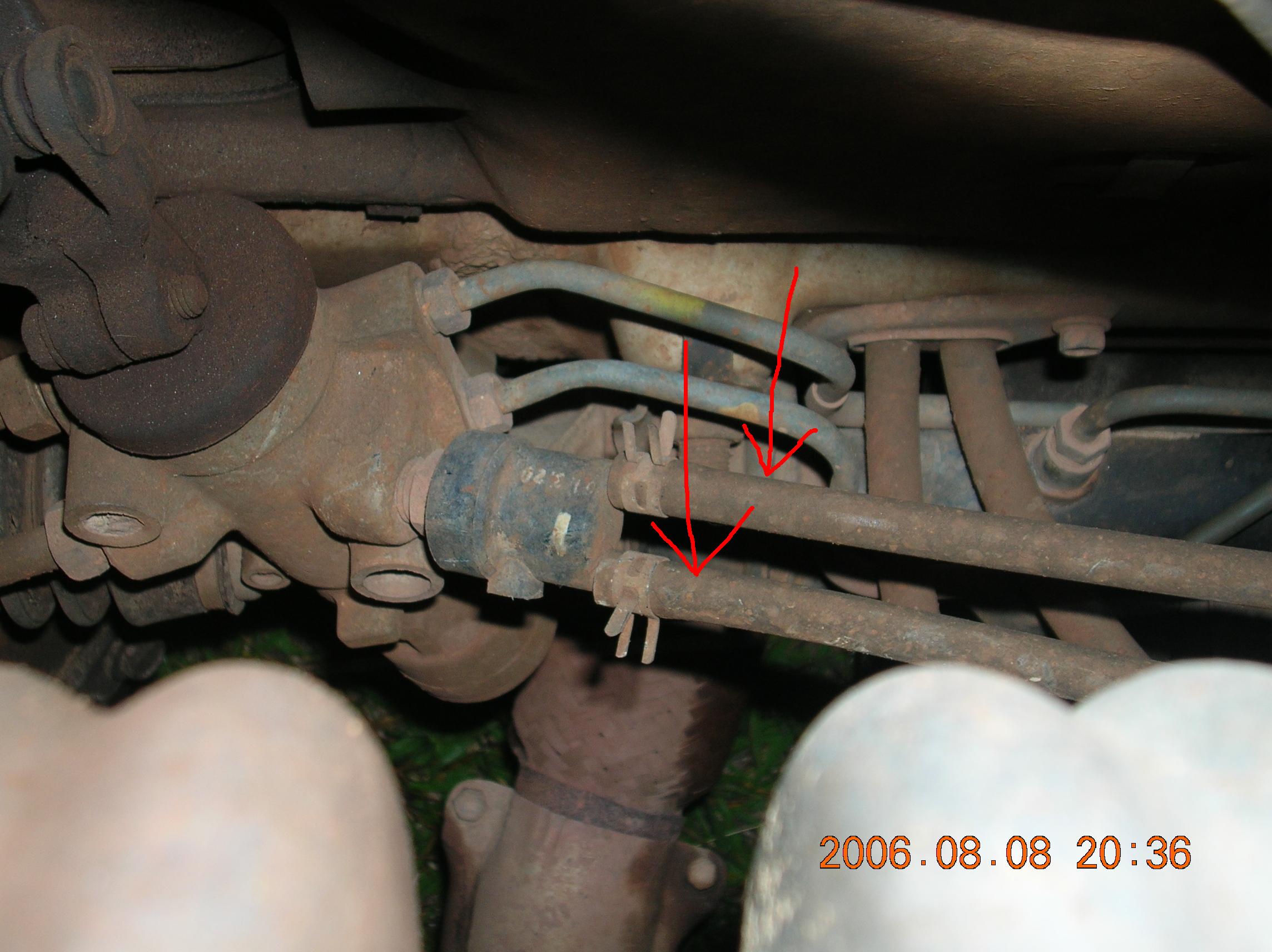

ok heres pics 2 prove!!!
the hoses go from the steering rack to the intake part of the injection rail!
the arrows point out the hoses n were they go
well thats what people told me it was. Its the sports one with all wheel discs, 4age, alloys, sports steering, stut braces, all that jazz.
any idea y it would have a vaccum line in the steering rack

Well mines has power steering and i was told it was optional on the CSX. ill let you know what happens as my new steering rack doesnt have a spot to put these hoses.

The new rack is power steering off a csx and mine is the power sterring twincam every thing looks the same on the apart from those hoses Do u recon it'll fit ok?
i pulled off one of the hoses n yes its a vaccum. when you take the hose off it wont idle properly, block the hole n it goes normal.
in that case plug the hoses ;)
just make sure you check bother, so you know for definate they are both vacuum lines :P
actually, rather than plugging them just get a bit of hose and run it from one to the next, tidier that way...

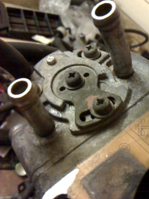

my gze has it as well as me and medicine man found out any inside it there is some sort of adjustment.undo that screw and that little plate turns id say, I'm not goin to do it since i don't know what it does. I'm heading down to toyota tomorrow to find out.by the way this has power steering. :)
Edited by too quick
well toyota was no help.repco and auto1 said idle compensator so irokin was right. :laff:
