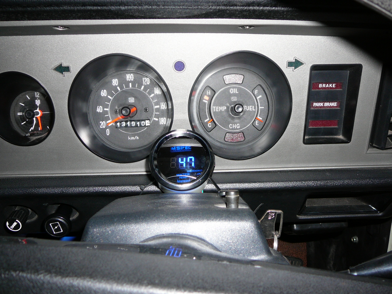

i was sick of my 4k showing 3/4 temp and scared its gonna overheat/ blow a head gasket. so i went down to my nearest autobahn and found this autotechnica digital temp gauge for the price of $49.99

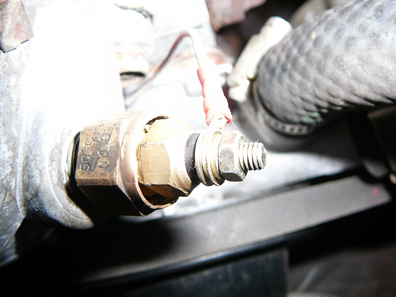

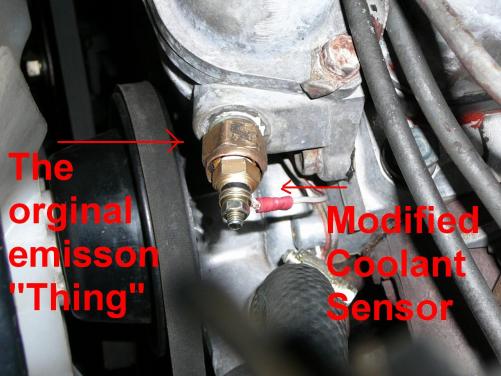

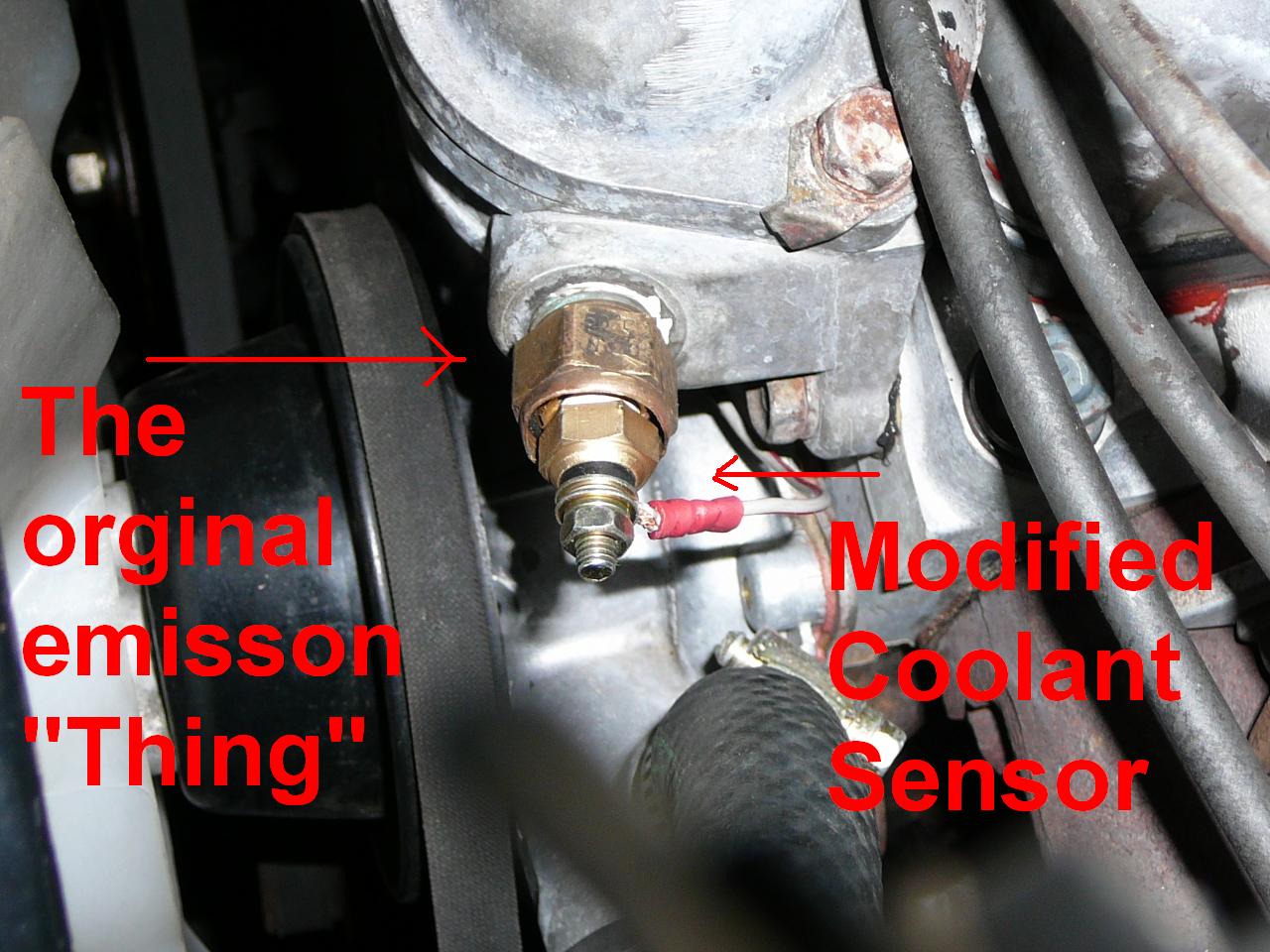

the Coolant temp Sensor for the gauge was 10mm in diameter. the original temp sensor and the emission valve was about 1/2 inch in diameter. so a simple remove old and fit new wasn't gonna work.
Modification
(difference between the ke70 emissions sensor and a ke55 is that the ke70 sensor has a 4mm hole going though it and was easier to drill)
i removed the emission sensor
drilled it with a 10mm drill bit (its got a small hole going straight through it so you can use it as a pilot hole)
tap it with same thread pitch
applied some plumbers tape
tightened it into the emission sensor
and installed into thermosat housing

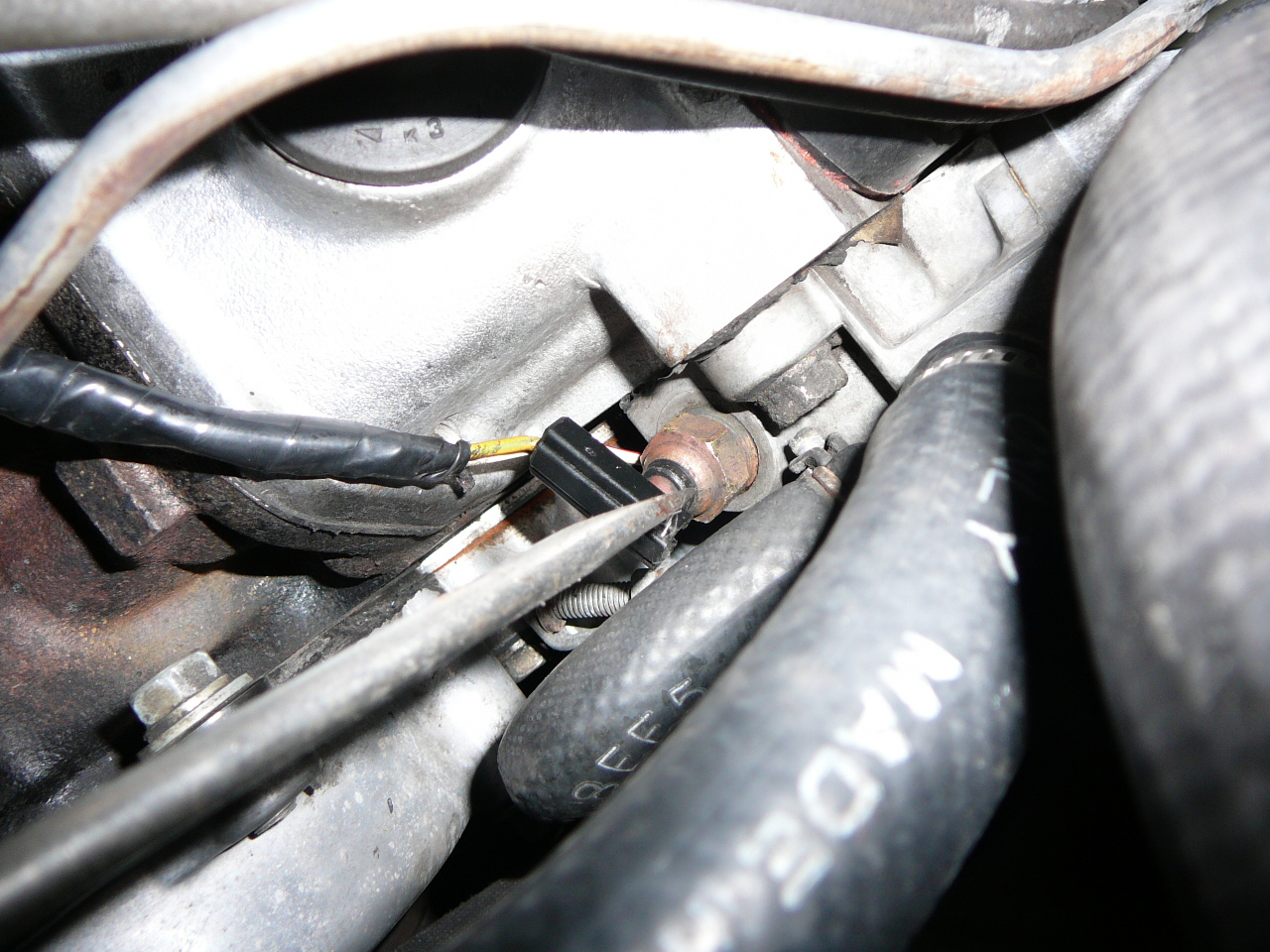

Please Run a New Sensor Wire because the 30 year old wire has probably frayed/ high resistance therefor giving you a false reading!

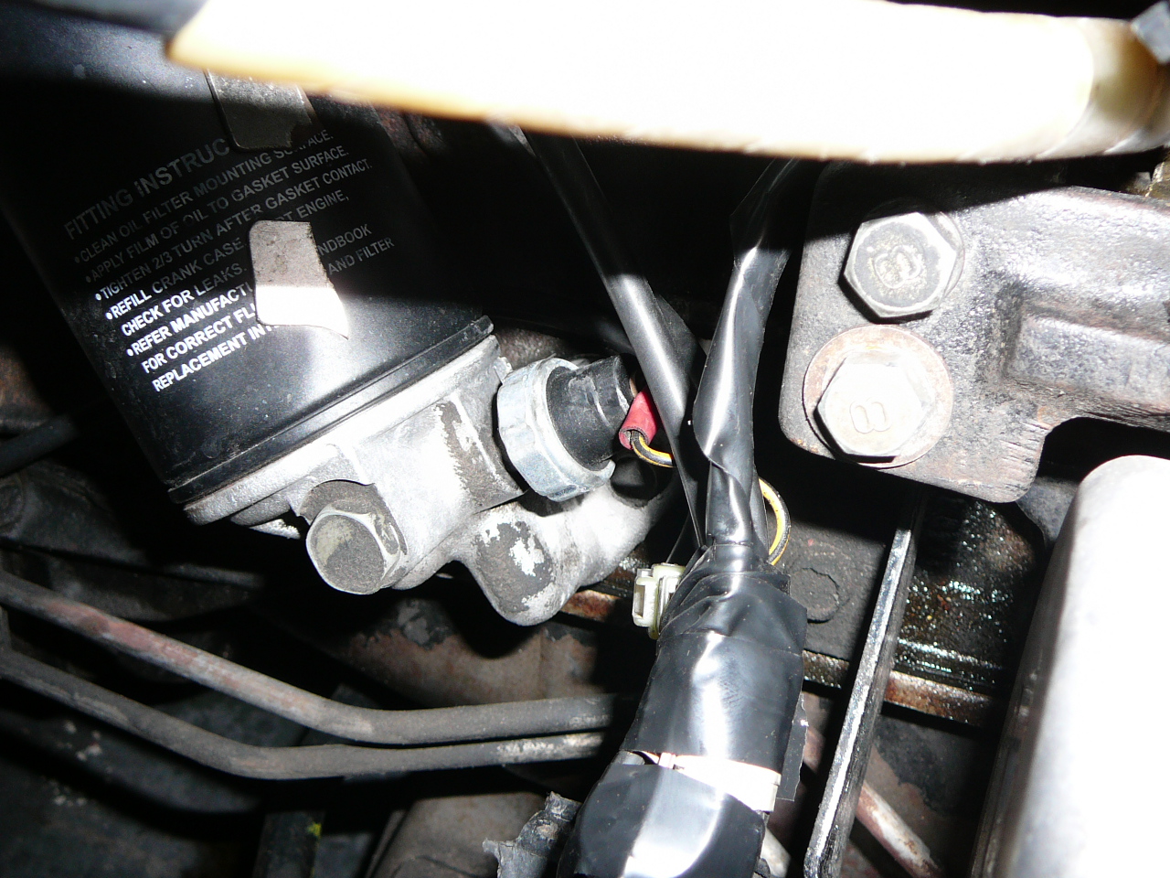

Close up of the modified sensor
Original Temp Sensor
Oil Pressure Sensor
Cable tied :thumbsup:

went for a small drive around the block, sat on 76 degrees and 79 with the a/c on (ambient temp around 25 ish?)
76 degrees and the toyota gauge was showing half way?????

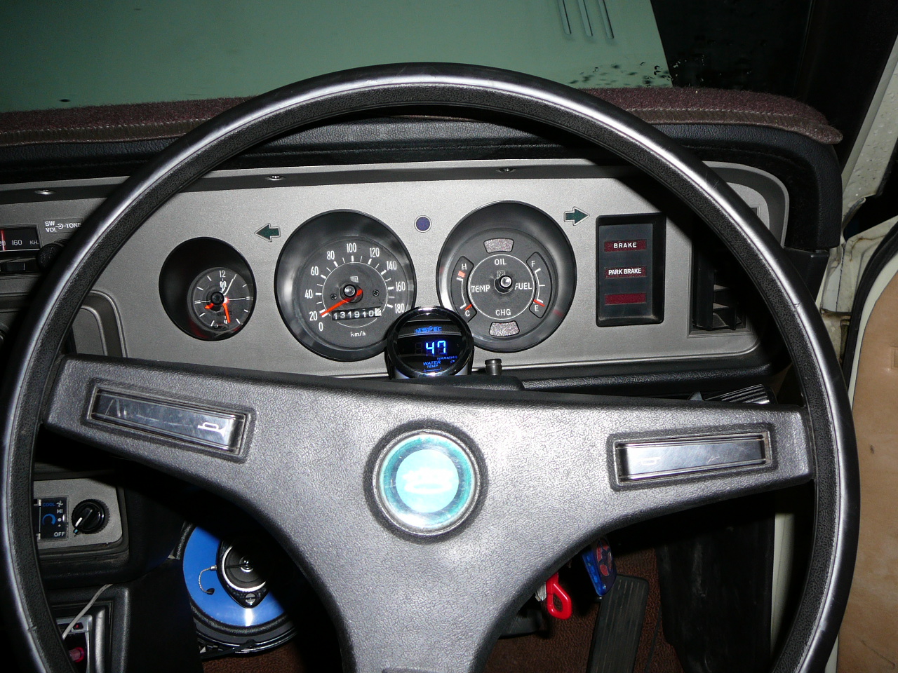

I was able to wire up 3 gauges today with this guide in about an hour and half. Oil pressure water temp and volts. i ran a single earth line to the chassy of the car and connected all three earths to this one. aswell for the ignition 12v i ran 3 cables off the one, it was much easyer this way and less mess. they work perfectly and i now know how hot my car is! :thumbsup:

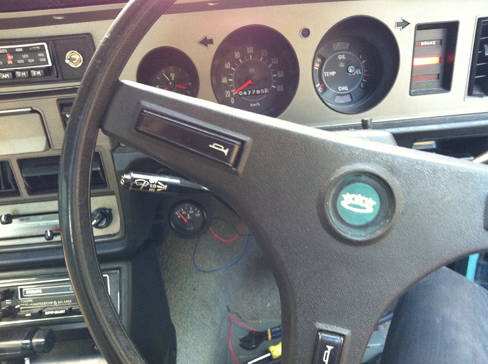

bumping an old thread here with some more info if anyone's interested. if you'd rather a needle point display that matches the stock gauges. (as towe mentioned above. it's as fast an accurate as a digital display as well) and you don't need to modify anything
I picked up a 52mm VDO electric gauge which matches the stock ke3x-5x gauges perfectly.
the good thing is that it's made to go with a VDO temp sender which fits in with a little adapter - no modifications required
prices and part numbers are as follows
gauge - 310010014 - $44
temp sender - 320.002 - $15
and whomever you buy it from should have a tapered brass adapter to bring the 1/8th thread size of the sender to M16x1.5. cost me $7
Oh yeah and another $8 will get you a tidy little VDO bracket to fit the gauge into
so all up i paid less than $75 and installed it in an hour.
same wiring Evan wrote up
1. Black - ground bolt anywhere
2. Red - power from a fuse (thanks evan)
3. Blue - sender. I taped the end of the wire to a coathanger and poked it through the rubber grommet on the firewall where the main wiring loom travels. easy as
VDO makes good parts too... i wouldn't bother with Calibre shit from SCA as it's ugly, more expensive and made in China.
here it is, I mounted mine under my choke with 2 pre-existing bolts. I gaffed those wires outta the way after this photo :y:
now instead of worrying about a very old, incorrect mechanical gauge with no numbers on it, i now know that my engine is sitting just under 80 degrees in traffic on a hot day :cool:
future plans are to take apart the dash cluster and mount this gauge were the now dead stock gauge lives :y:
