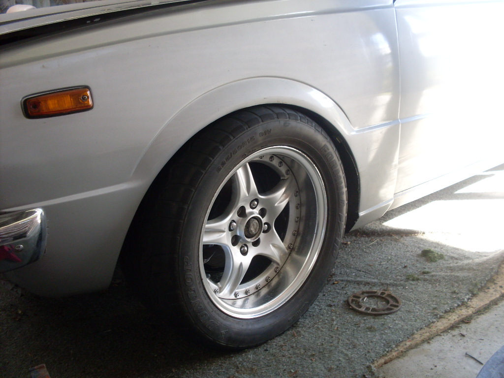

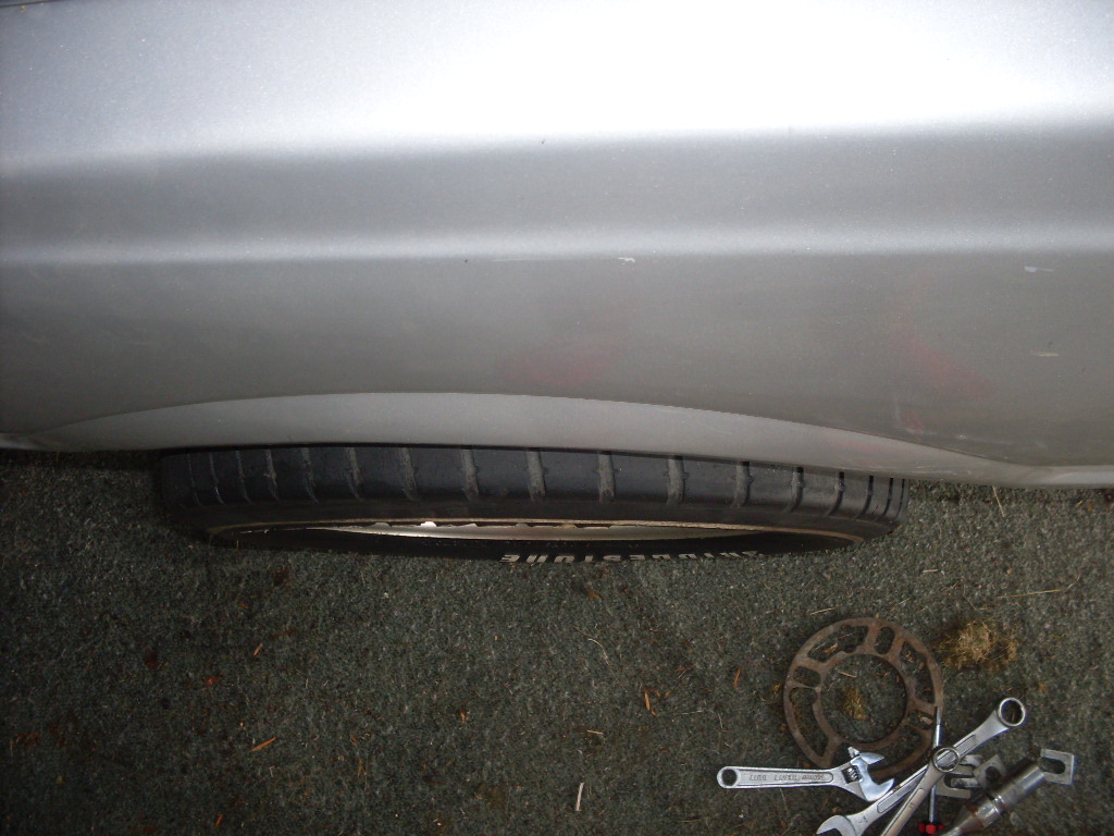

  3. got a r31 solid rear end diff on the way , went with it because they are already 4 x 114.3 stud, disc brake and lsd centers are quite interchangable being borg warner, if any ones got an idea on what lsd carrier centers directly interchangeble with the r31 open centers please let me kno as ive heard ea/eb v8's have lsds that would fit aswell as vl/vn/vs ss holdens aswell. as for my paint schme I'm going with a mettalic bright hitachi digger orange pictured below on this suburu. I'm going with these new RWD offset rims . going to have a staggerd fitment 16x7's on the front (2inch dish) and 16x8's on the rear(4 inch dish!!!) . going to be cutting down diff housing as short as i can go to get the 16x8's sitting overrated. let me know what you reckon ov my thoughts

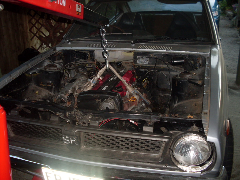

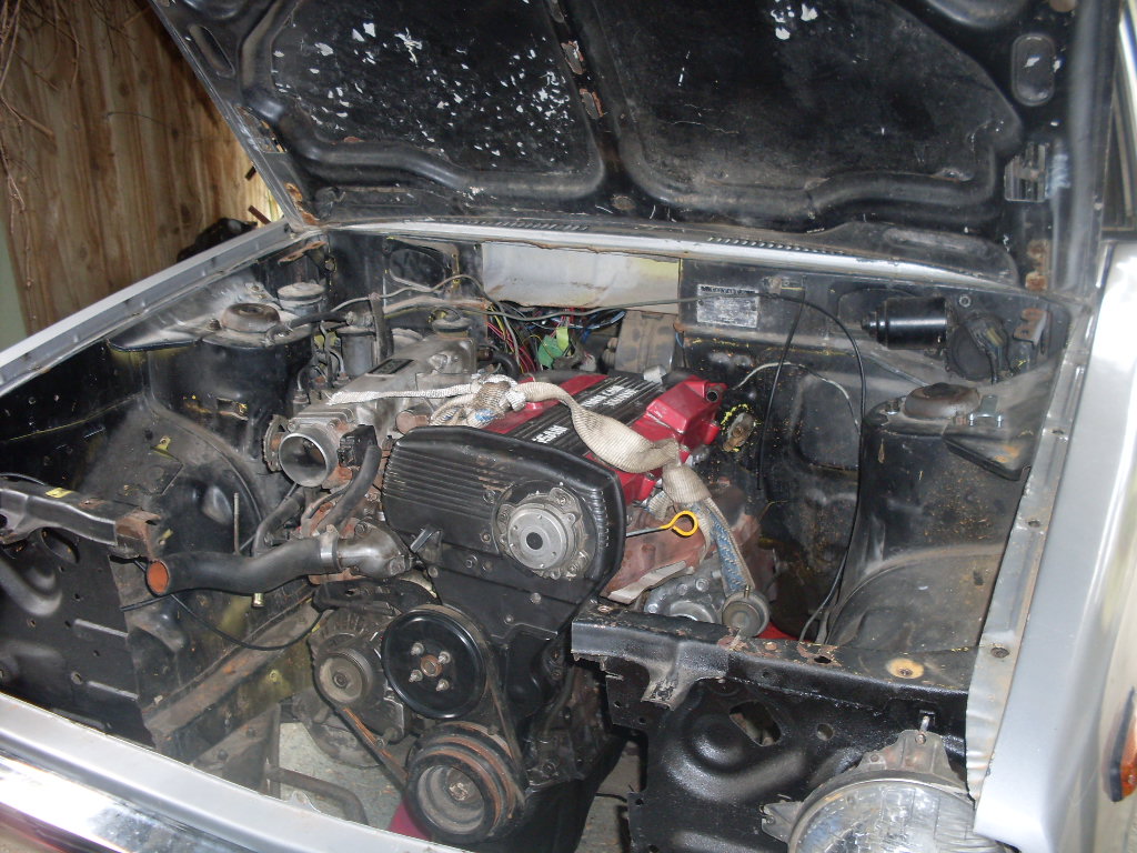

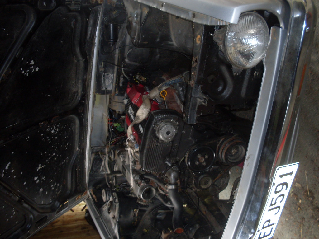

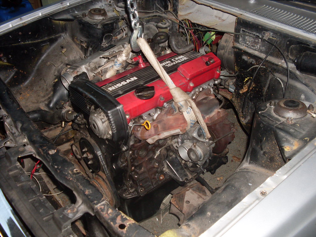

  4. bit of an update, now have some 13x7 superlites on the front just as a gauge of sizing with wheels etc.finally got around to fitting up my engine and g/box in the weekend , alot ov welding and buggering around trying to get the ca18det to fit overrated , but its all in with good clearances. engine is just a dummy fit as i will be pulling it back out to panel and paint the whole car and rebuild the engine as its in unknown condition.here are some pix

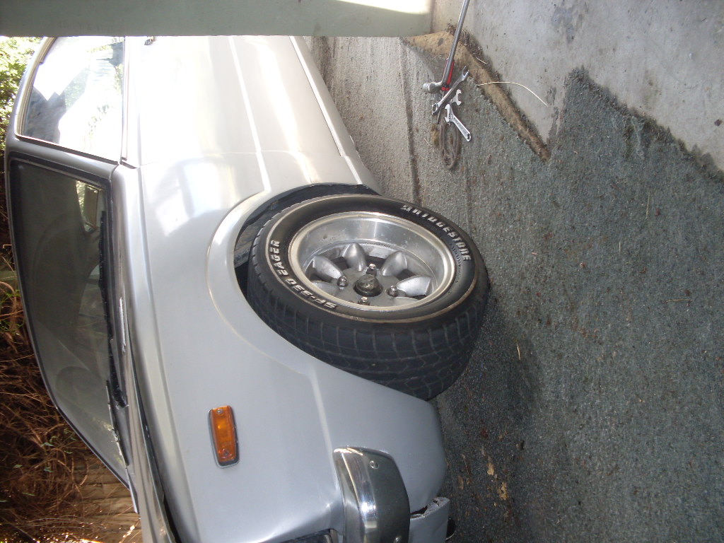

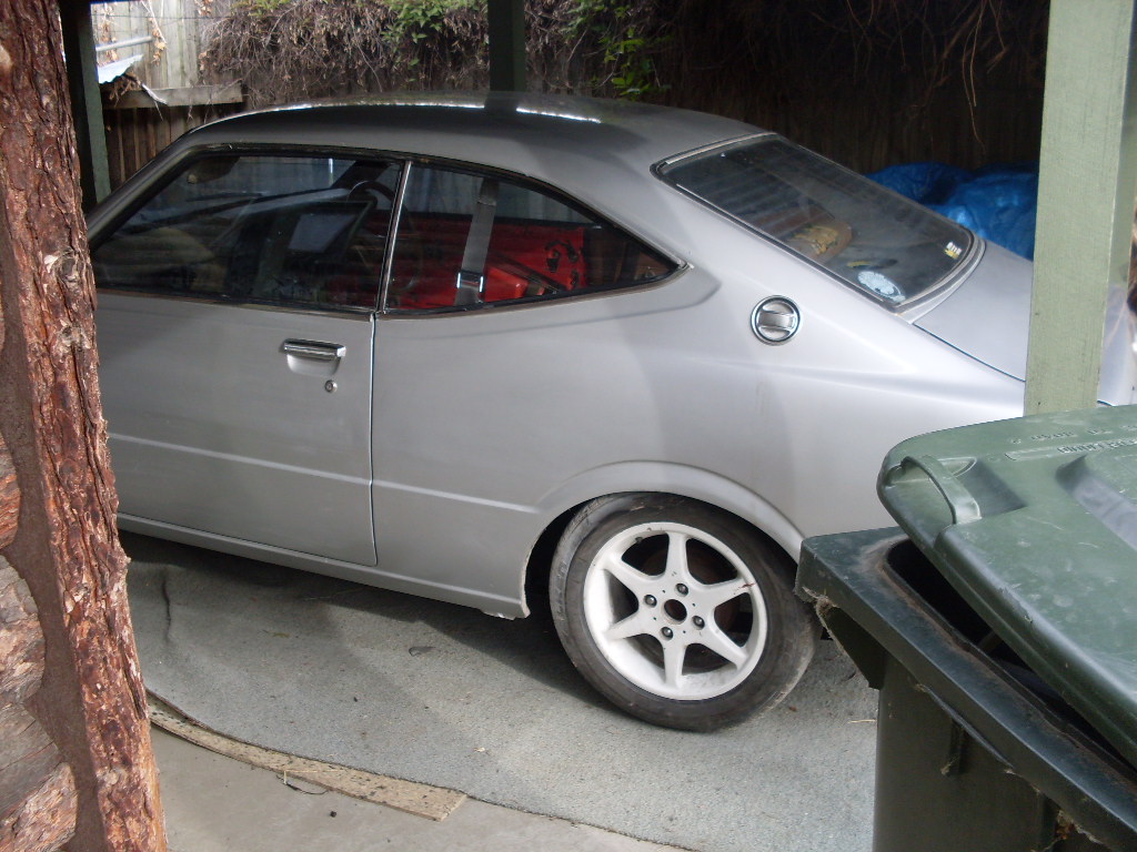

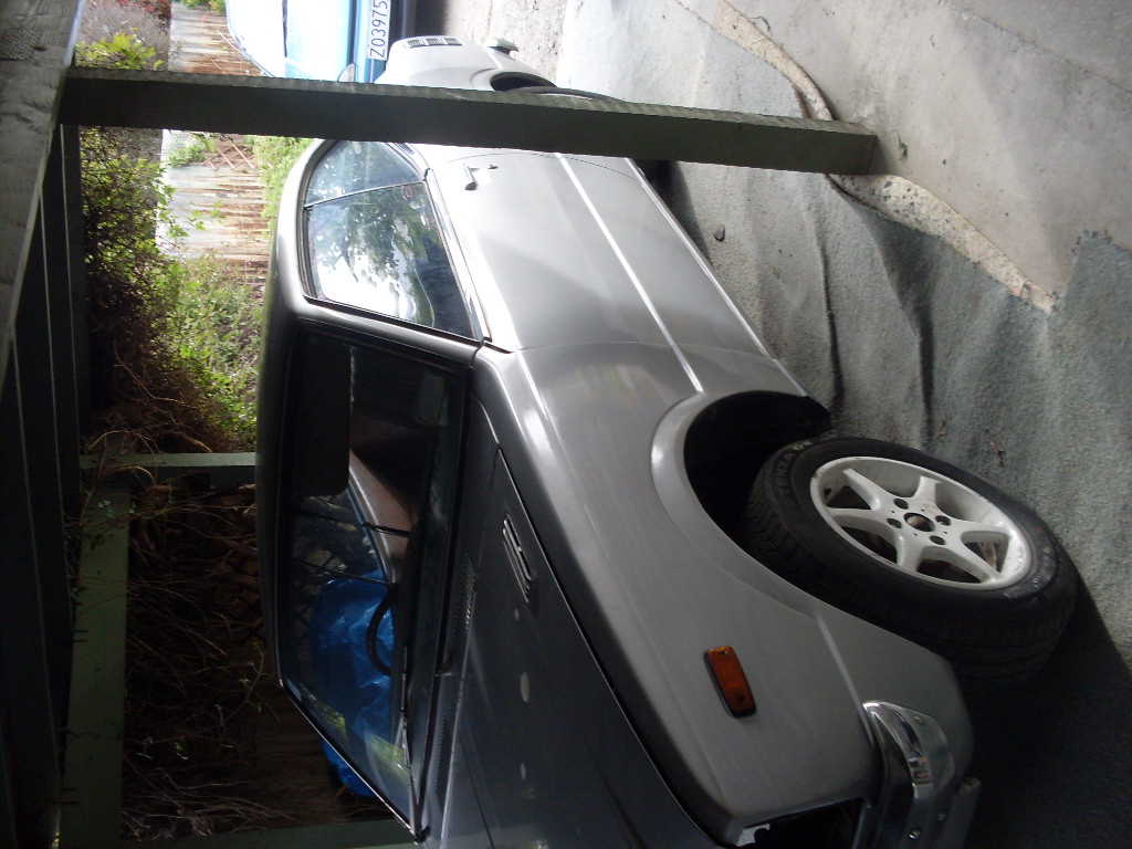

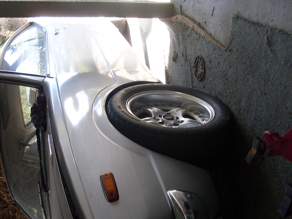

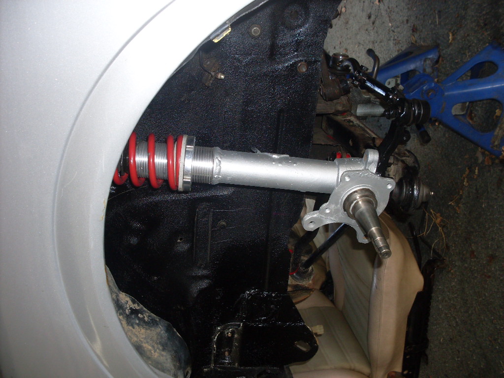

  7. got the rings i needed for my adjustable front suspension so they are all ready to go in. the struts are old ra61 celica struts with the bigger brakes etc so they should be all good.once i got them in with everything bolted up i then relised that the fwd offset mags ive got on at the moment will not fit(hits the struts derr!!!)so i borrowed some 15x7's which look huge lol .here some pix, picture of ride height is with no engine remember lol and i have still got 70mm of adjustment to go with my adjustables lol , should be low az

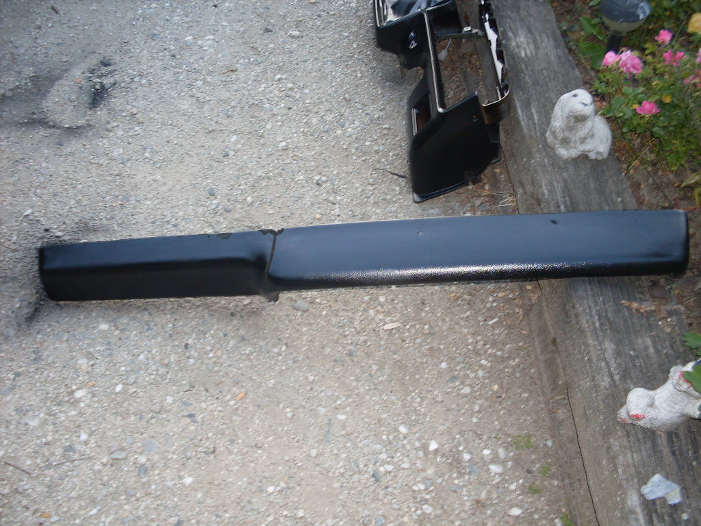

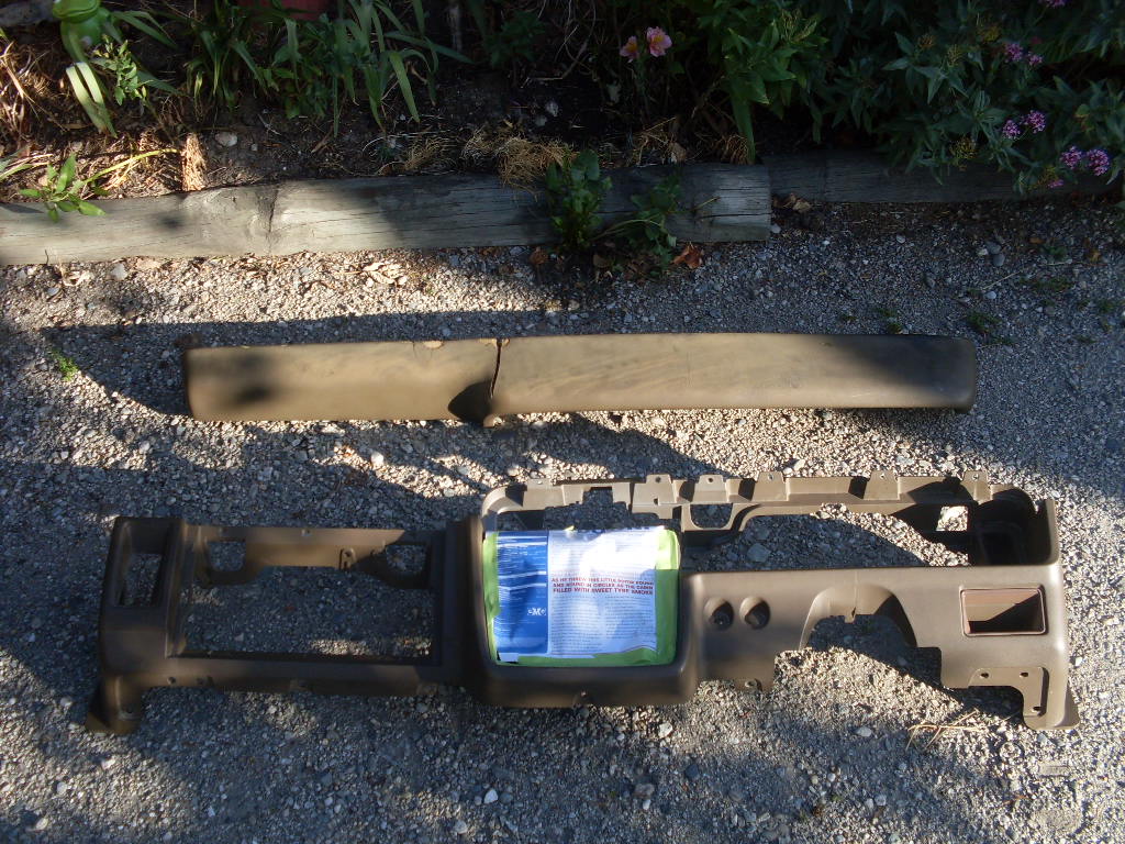

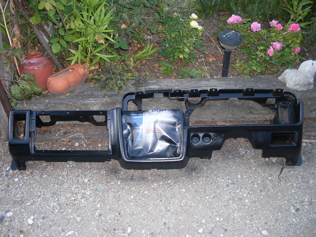

  8. removed my dash today and cleaned it down and decided to give it some paint came up bloody overrated considering the amount of time i put it into it(5 mins lol) heres some pics
  9. cheers mate will update pix soon exterior is a tad rough at the moment as I'm workingon the engine conversion side of things first. no not red interior it just the inside of my drivers door which i had to replace its missing the door card lol.

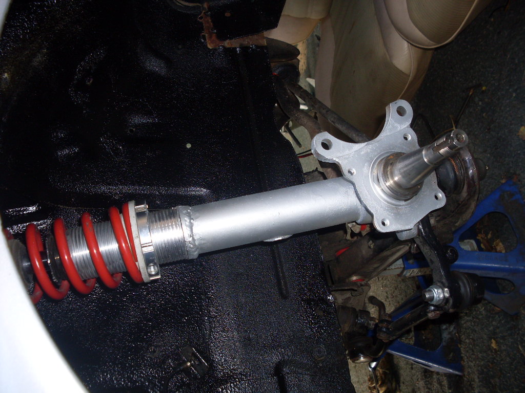

  10. by the way just to introduce myself I'm kurt from nz. making some mounting brackets up to fit the original rails off my rolla, the seats are some early model evo recaros. will post some pix of the mounts and also my coilovers soon.
  11. hey in the process of putting a ca18det in my 35 coupe will post some pix up, making up some adjustable coil overs for the front at the moment. and also trying to find a set of seats that may bolt stright on to my original rails etc so if any 1 can give me some options on that it would be great help. will keep you posted
