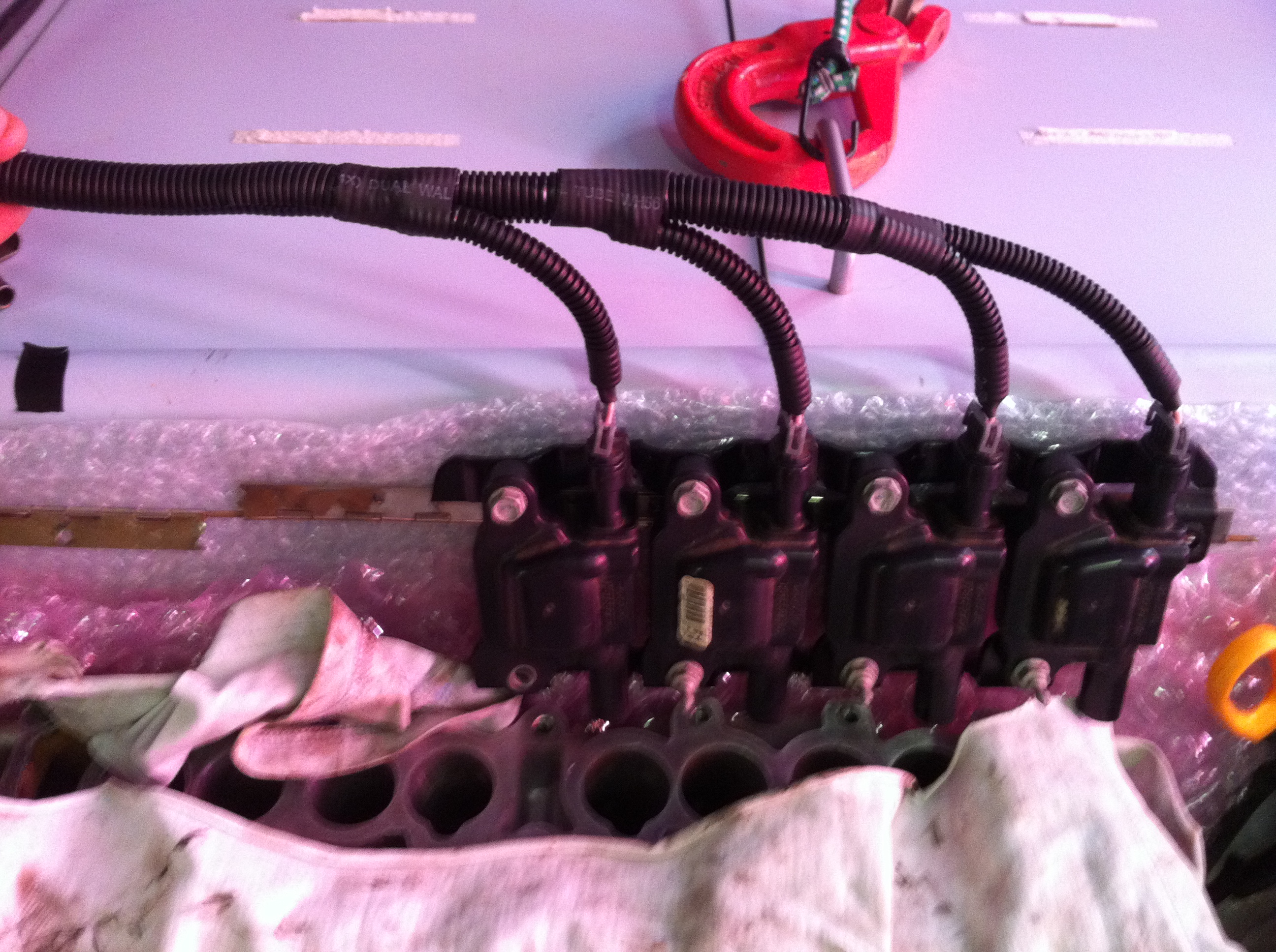

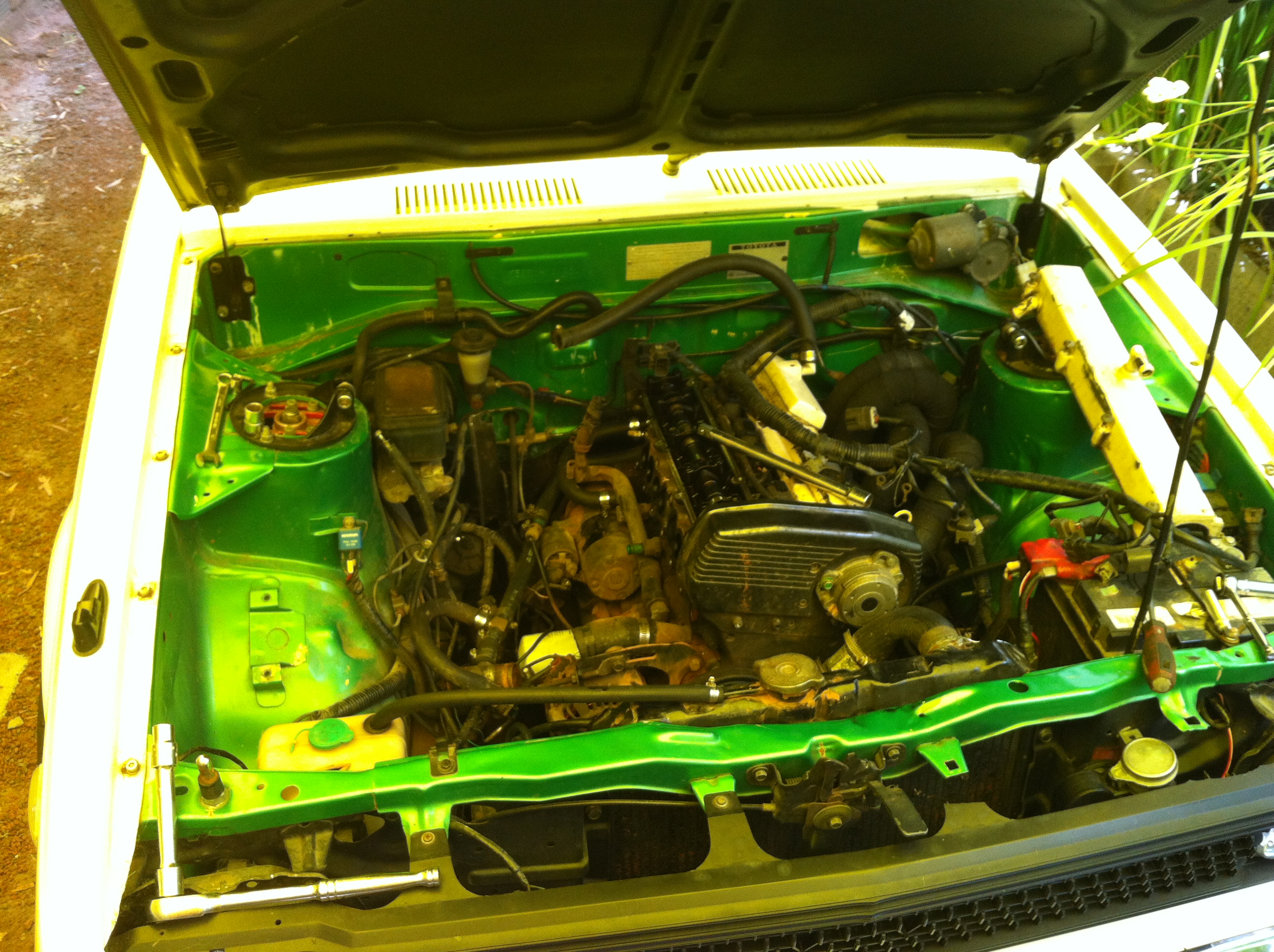

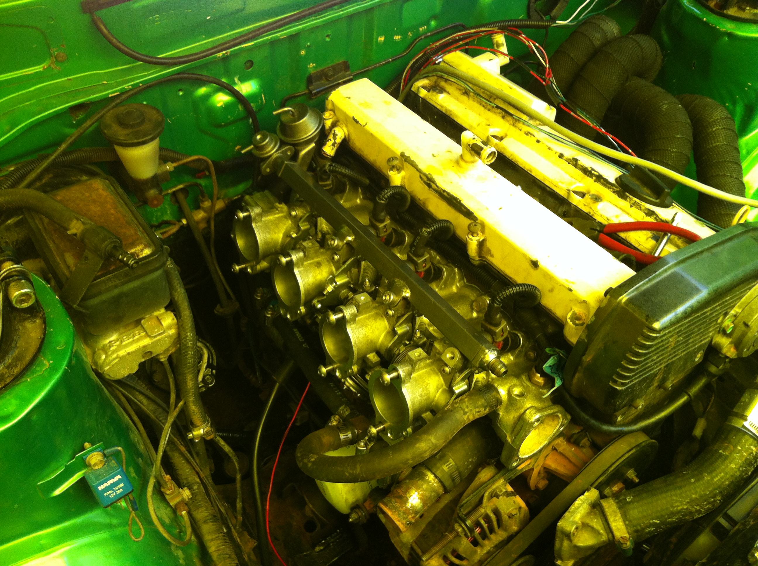

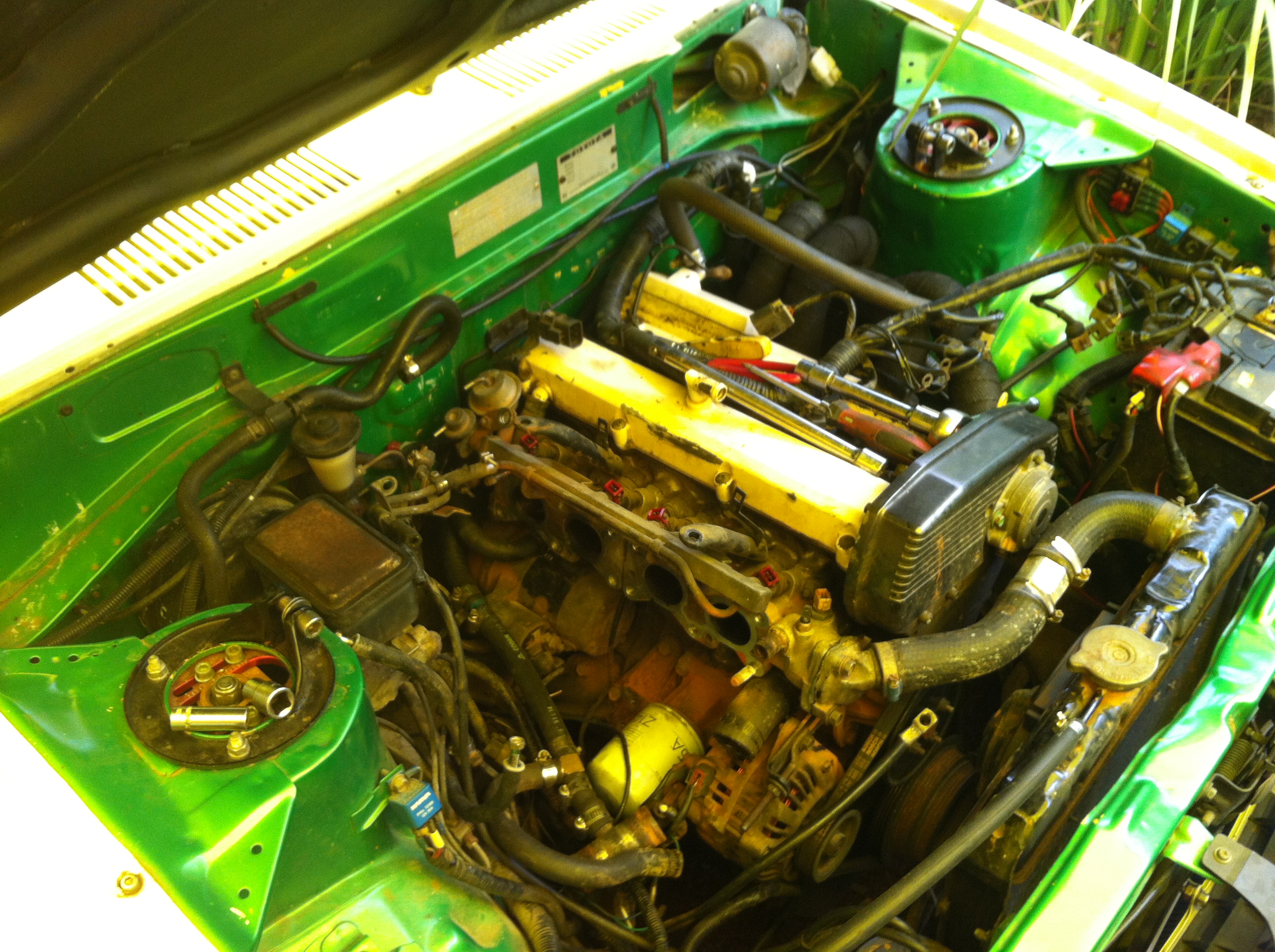

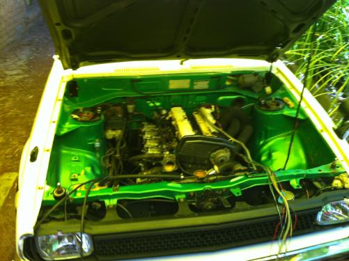

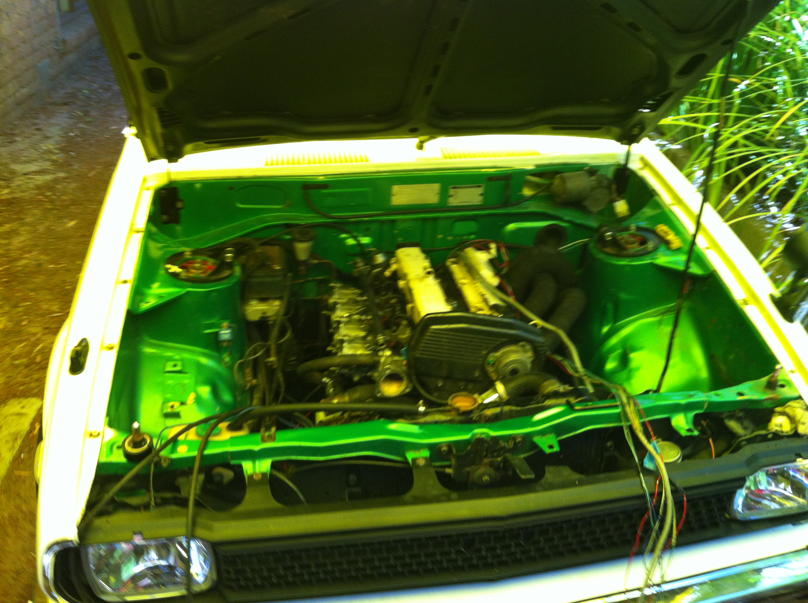

  11. hi guys, been a while since ive posted, or had any progress sadly, bought a dirt bike so that's been taking alot of my time Christmas holidays came up and i thought it would be a great time to start doing some much needed work made a bracket to mount the ls2 coils on so i thought it might be good time to replace the starter motor as is been dicking up something fierce, like starting to get really hard to start because of it, not to mention embarrassing considering the manifold had to come off to get the starter out, may as well get the quads on to aye top of manifold off bottom half off and quads on, shit yeah sorry havent got that many pics at the moment, will try to get some tomorrow just about all the looms done, just needs some tidying up, didnt want to finish it all off before i knew it ran first tried to start it late last week, had some issues, one had the fuel lines hooked up the wrong way, sadly took a while to figure out that one :bash: then when got the fuel lines worked out, the fuel rail leaked around where i welded the an fitting in the end, i didnt realise it was leaking until i tried to star the the car and it back fired, causing the leaking fuel to catch fire F#@k!!!!!! jumped out the car in massive panic, trying to figure out where the closest fire extinguisher was while trying to blow the fire out like a candle, lucky enough commitment with the blowing and it went out pulled that off and re welded the leaking bit, installed, no leaks, still no start left it for a while, broke my foot, left it longer did a fair bit of playing with settings and stuff in the haltech of the last couple of days and finally got it running today it only starts and idles at the moment, working on getting it to rev, there no good base maps for this thing so ive had to make my own maps, not easy, and there is a vid, I'm uploading as I'm typing this, will post it as soon as it come up paul

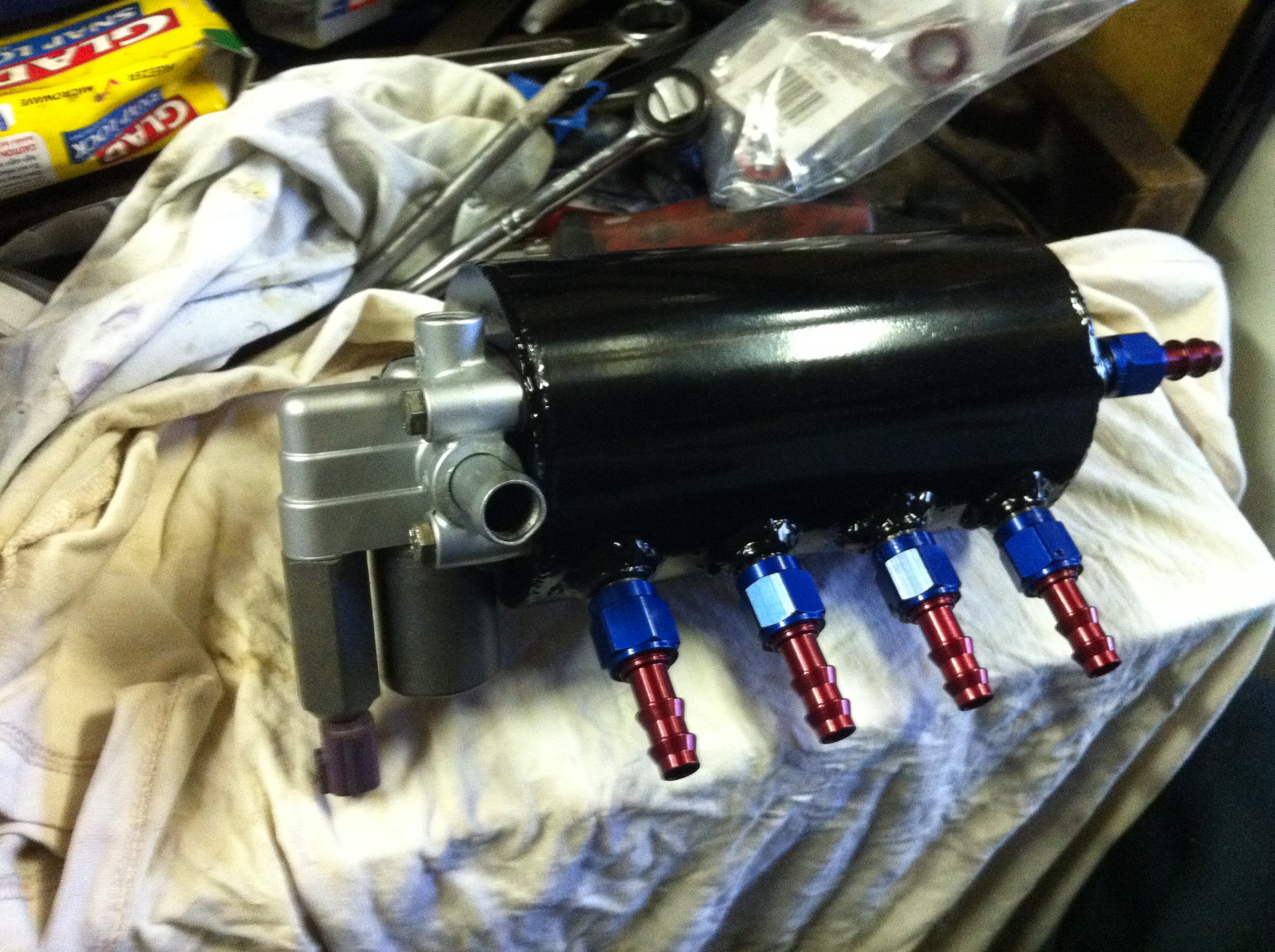

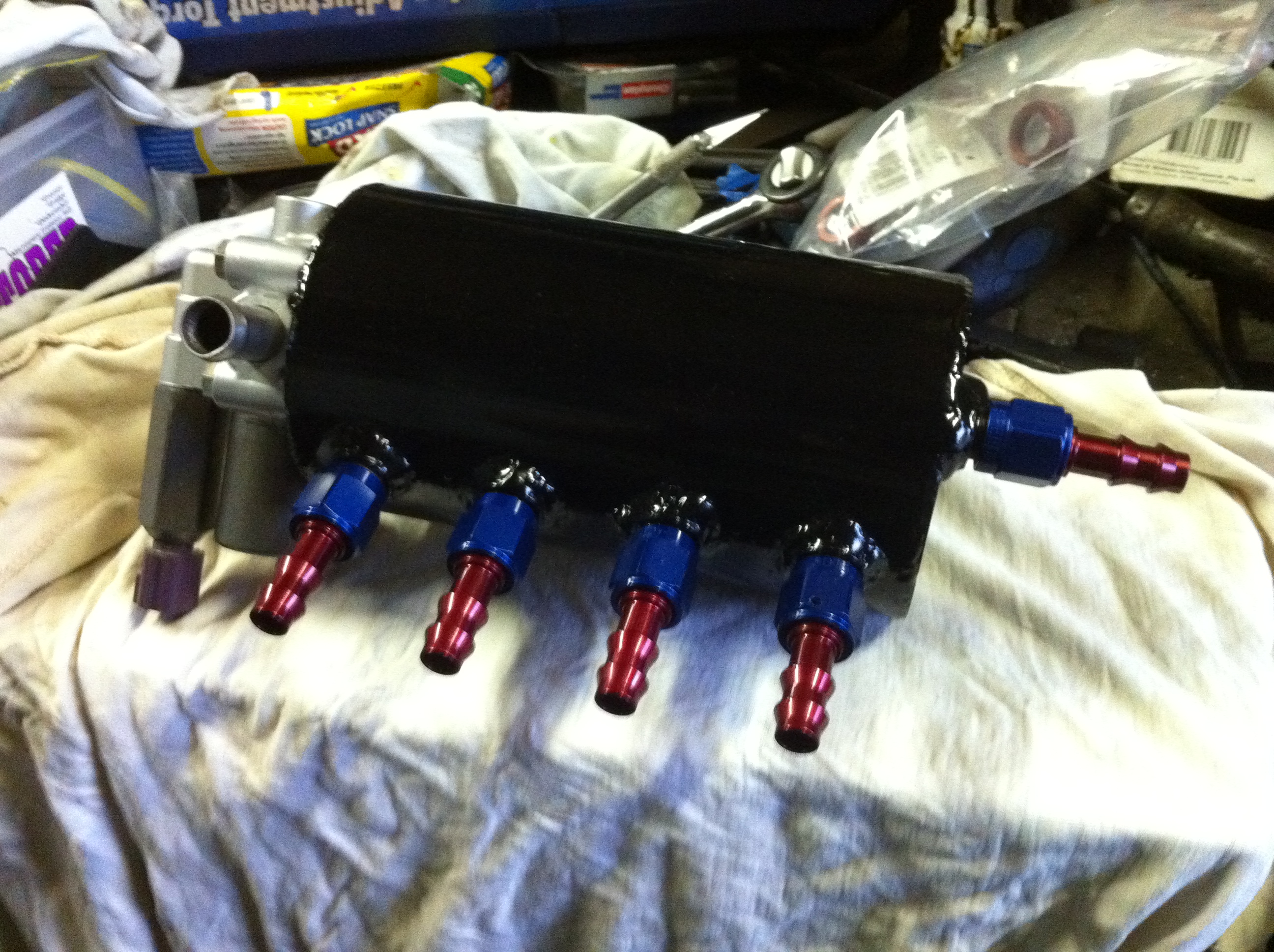

  13. alright, little later than promised, but here it is this is the vacuum canister, there is a line from every intake runner, one to the booster and there will be one for the ecu, the silver thing in the end is the idle control valve, its off a n14 pulsar, nice a simple and small, two idle up valves and an idle adjust screw the two idle valves should be good cos i have three different combos to try to get my idle up right, (one on, the other on, or both on) speedflow fittings again hahah on another note, been nominated for rcoty, awesome :dance:
