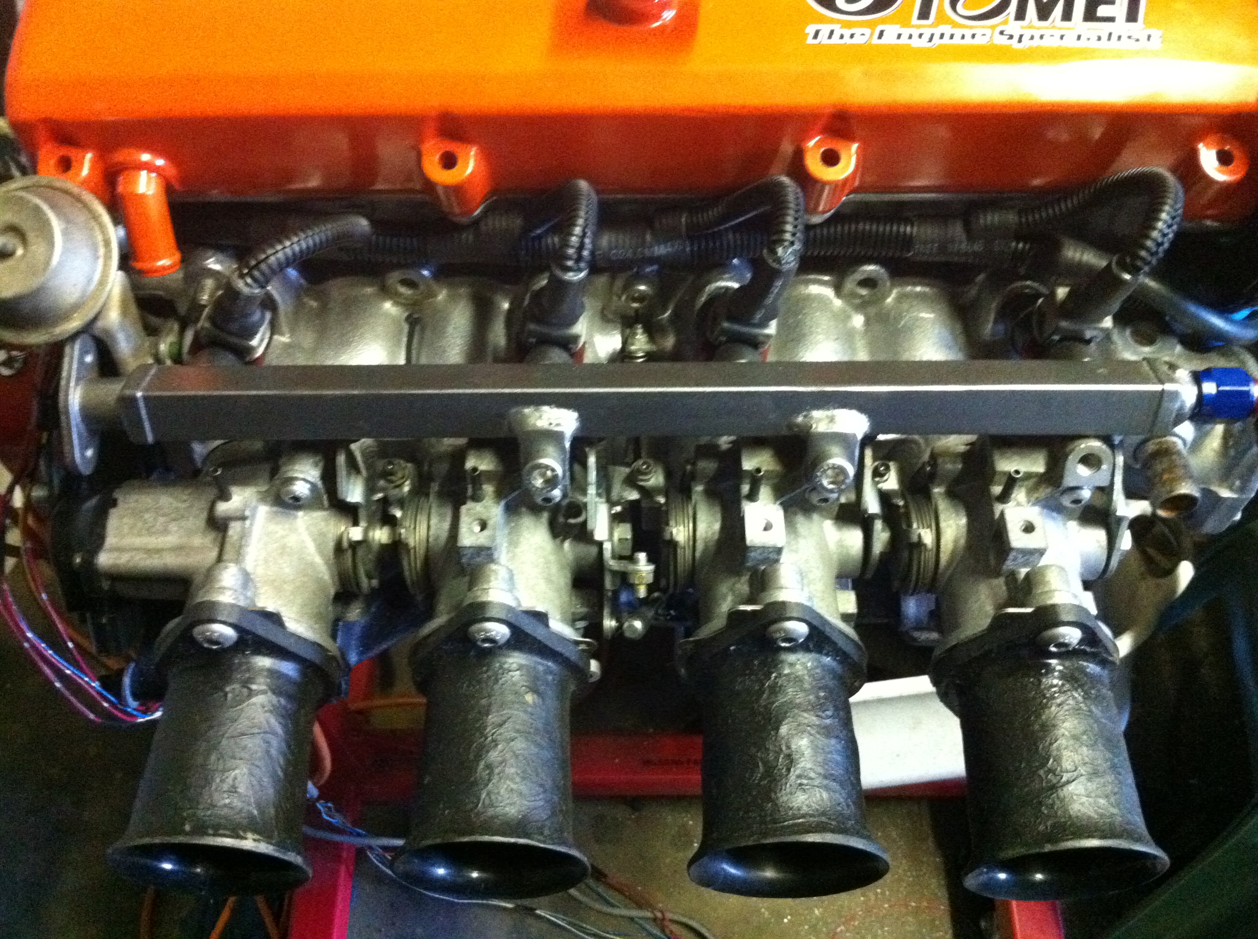

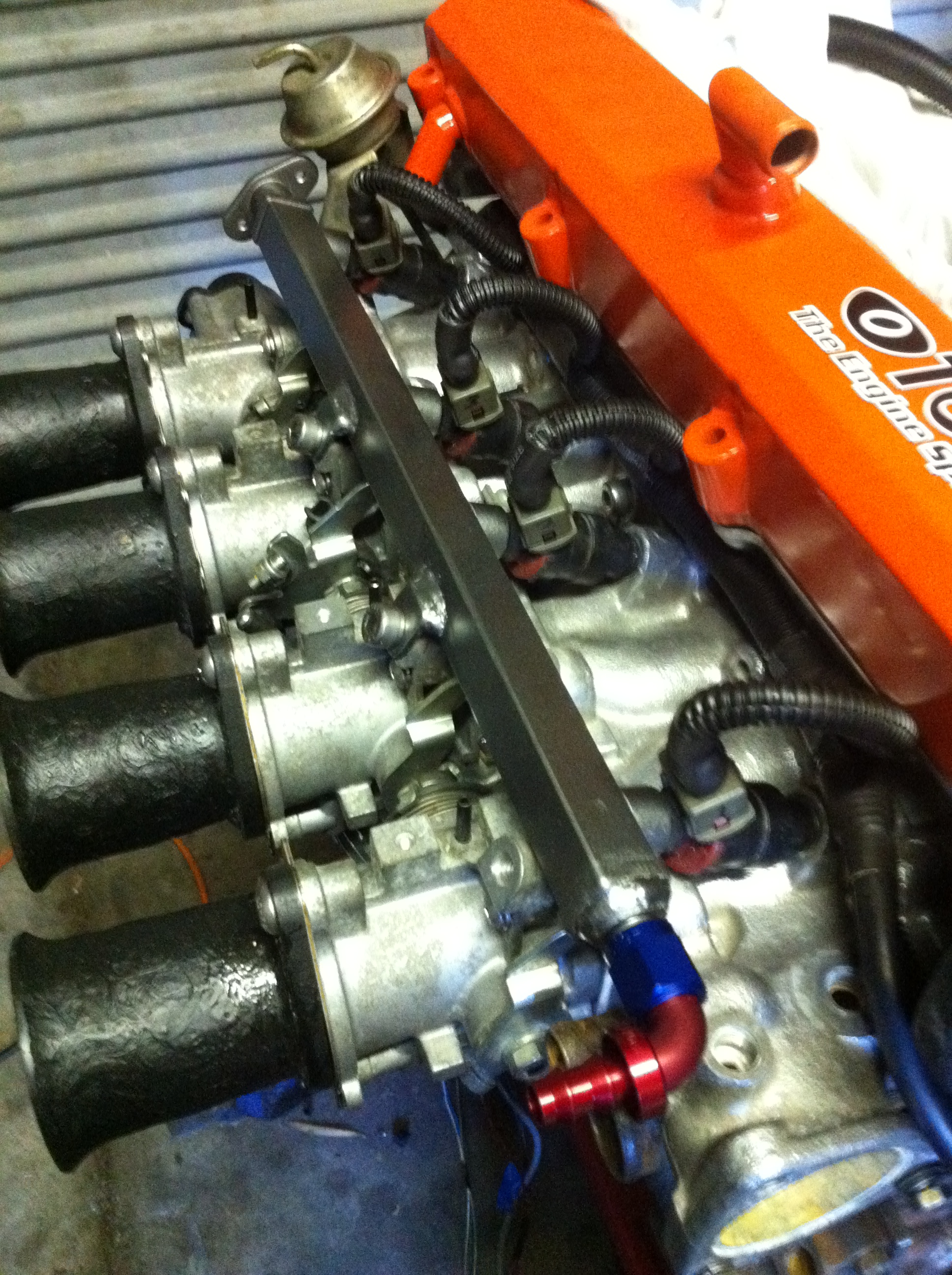

only small update for tonight, hit the piss way too hard last night, today was written off sadly (i hate wasted days) made a trip to speedpro on Friday night and bought a shite load of speed flow fittings and weld on's so i was able finish off the fuel rail and started working on the the vacuum reservoir,will get pics of it up when its done fuel rail done i love speed flow fittings paul

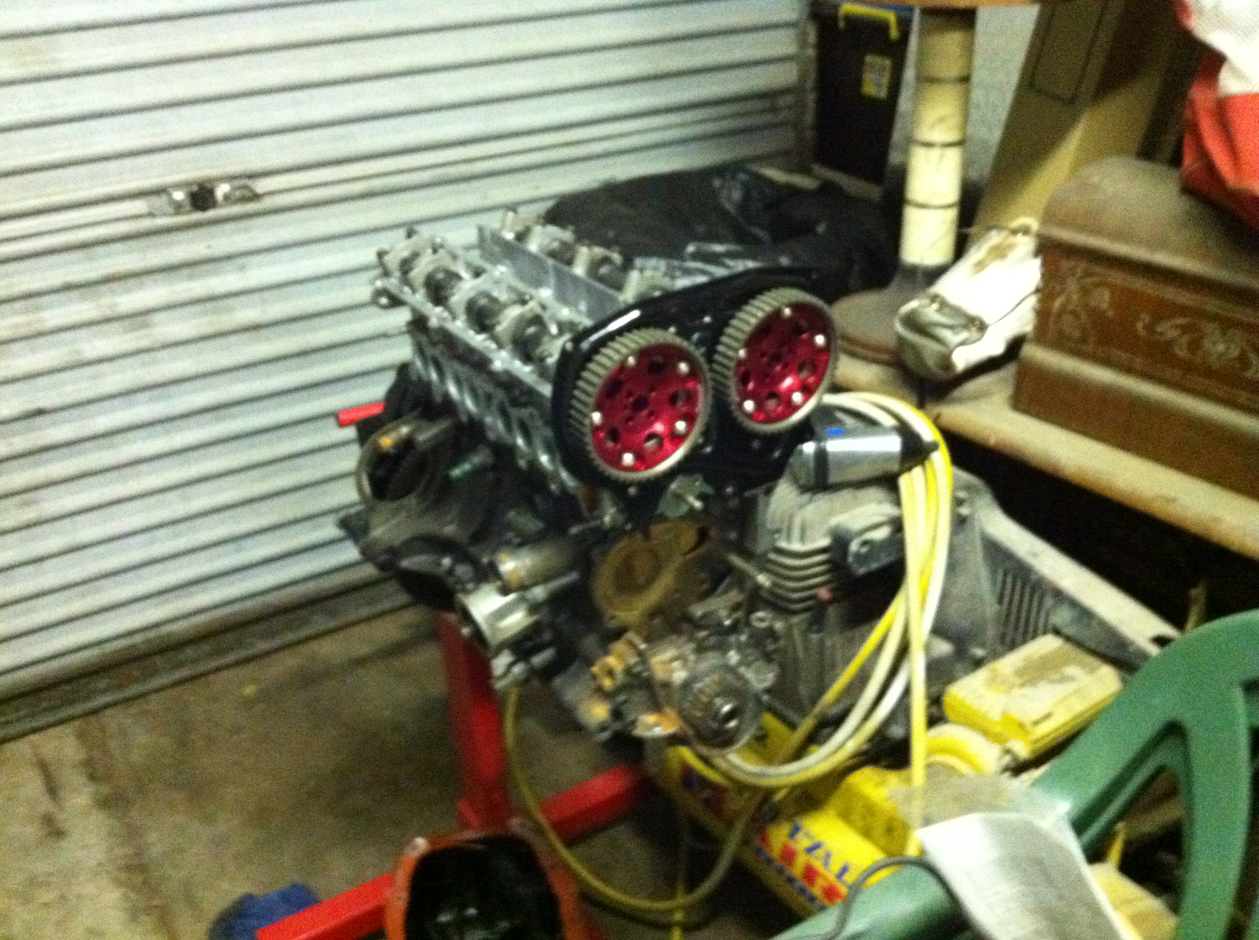

hahaha cheers guys, yeah ma can't wait, will be putting the quads on the new motor first, need to get a base tune sorted before in can run the cams in running a new motor in and trying to tune it at the same time would be disastrous paul

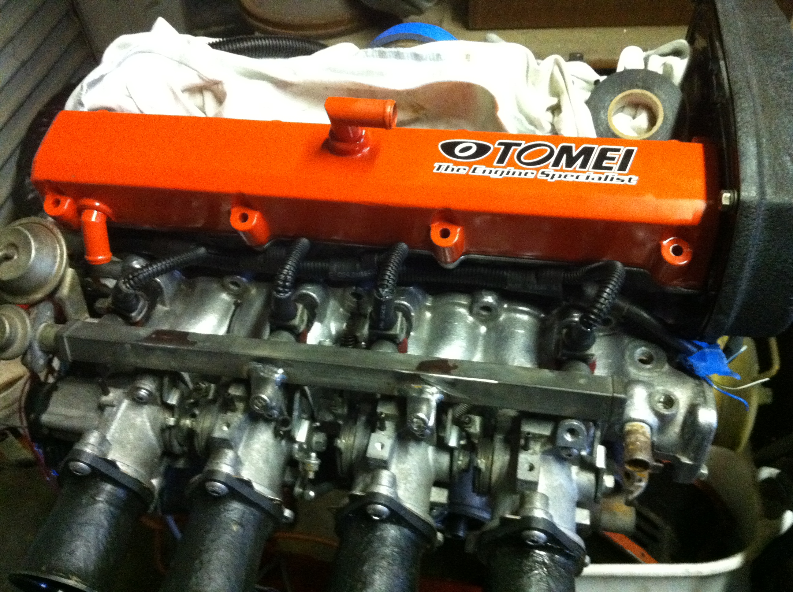

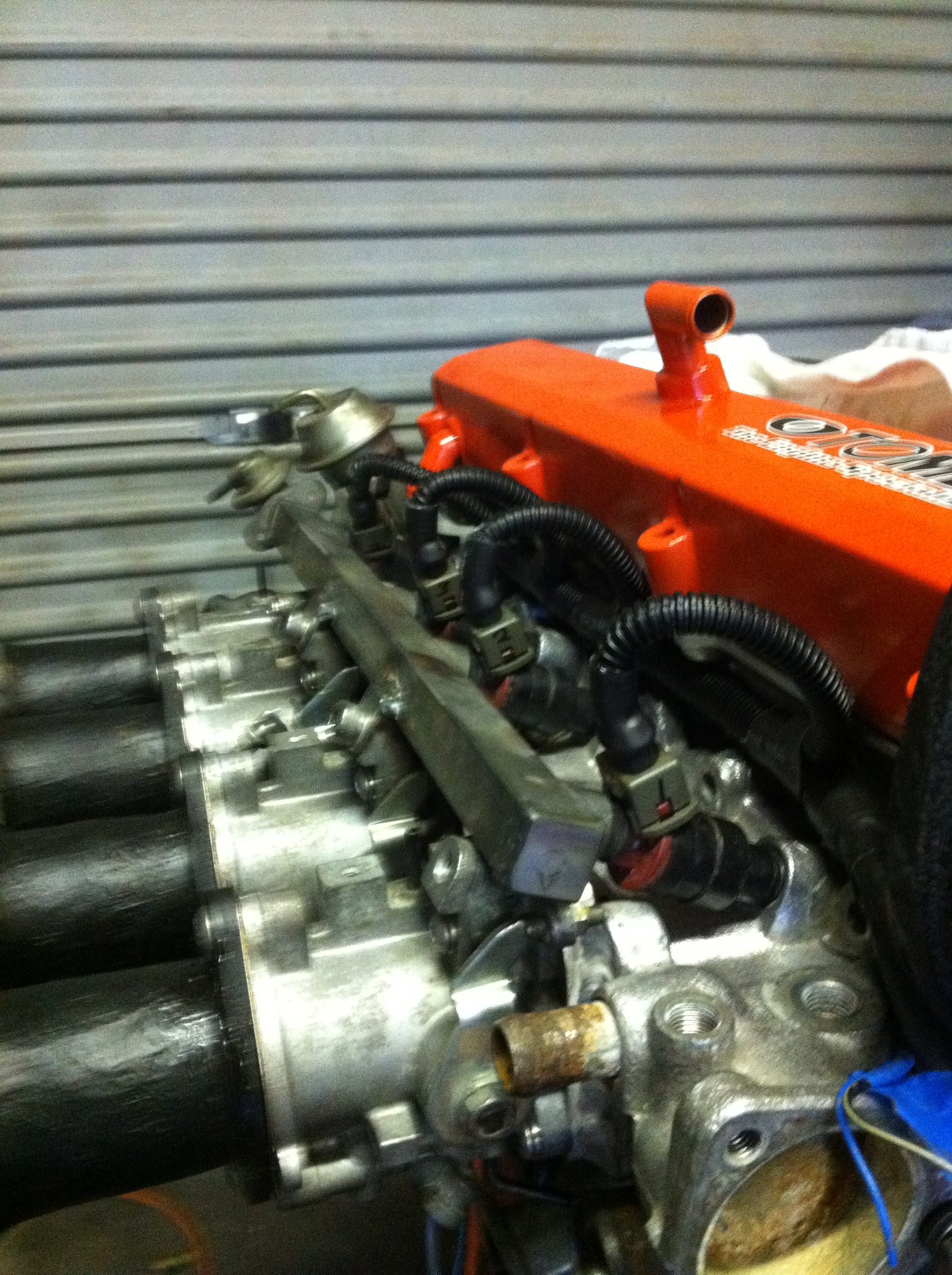

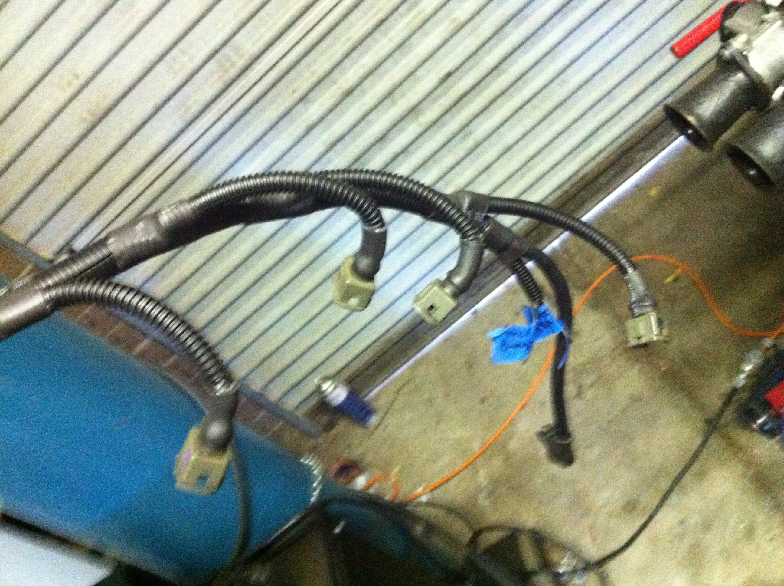

ran out of picture rooms this is with the loom on the motor, fairly happy with how neat it cam up and from the front, neat is hard, i hope i can keep it up for the rest of the loom that's in for now paul

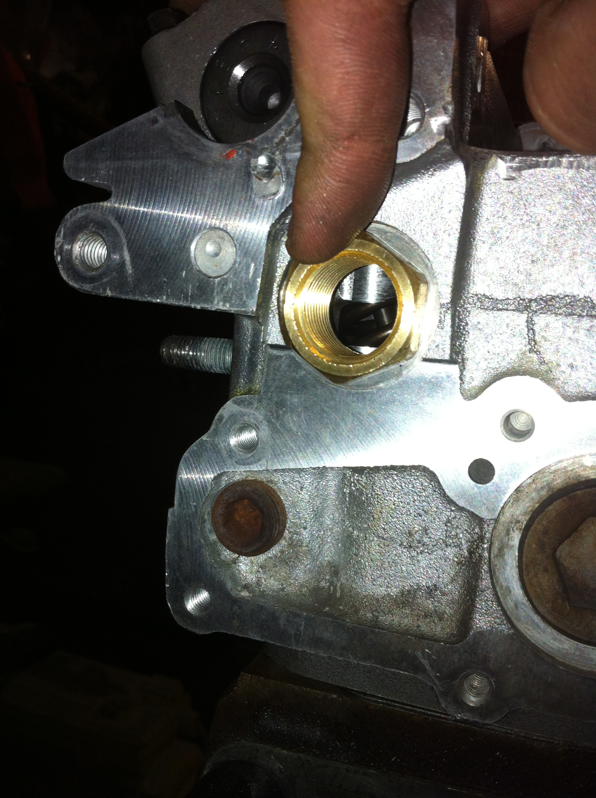

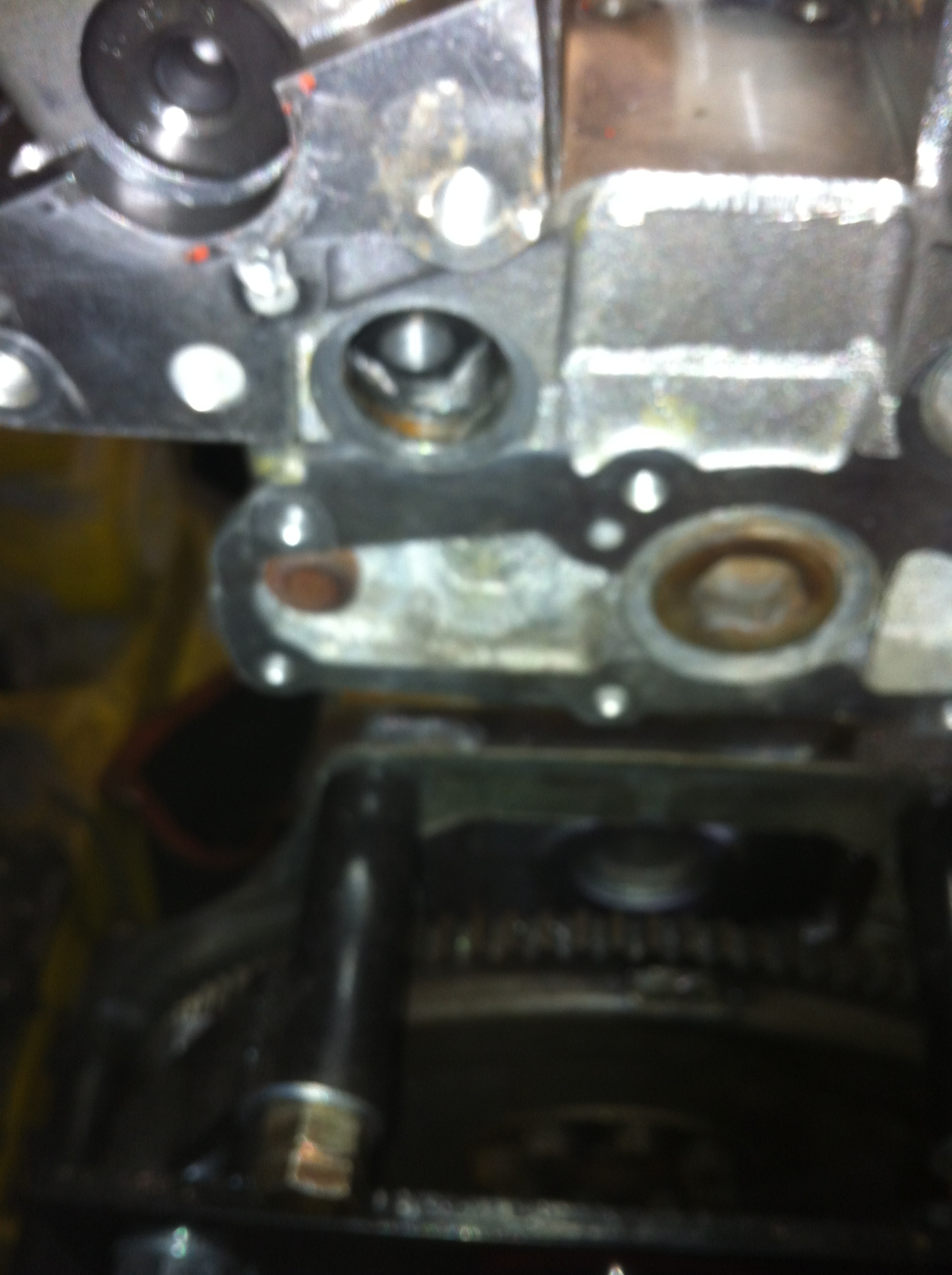

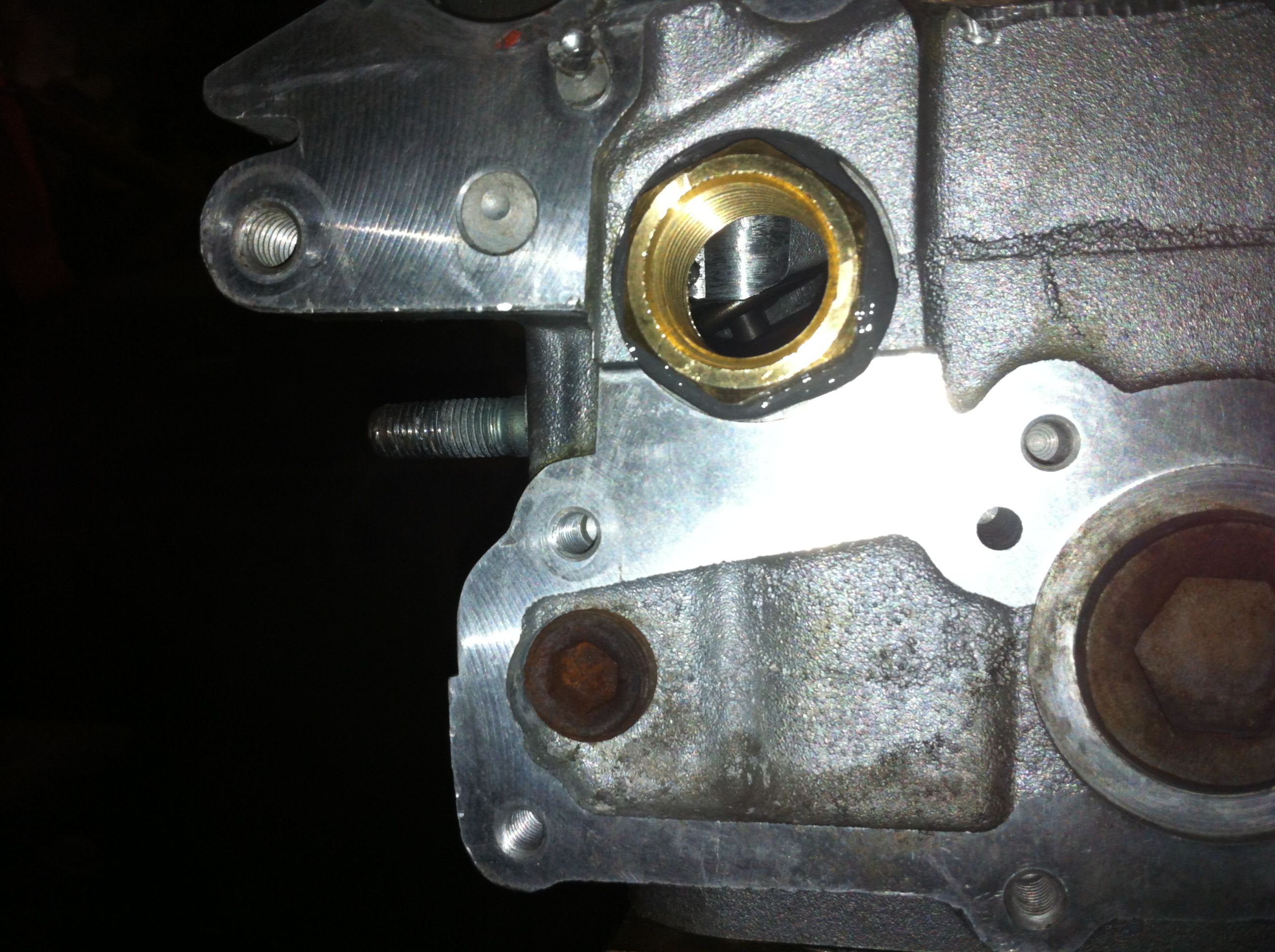

yeah looking at computers now stu, got to suss something out soon got a few things done on the weekend (was long weekend and finally wasnt working all of it lol) got my new second hand tyres fitted, stretched like a bitch, not very confident in there grip yet but maybe they'll run in a bit been working on ideas with this engine and its over efficient oil pump, they have a habit of filling the head with oil and running the bottom end dry if held in high revs, not good for me considering it have no mercy and will be 8500rpm limiter so my idea was instead of stuffing around with restrictors like the RB's (there doesn't seem to be any for the CA, and I'm not about to test something out) is making the oil drain faster so there's this hole in the back of the head which had a welsh plug in there, it opens up into the valve spring cavity in which ive grinded down a 1/2 brass fitting to fit in there and all glued in there, if i had a lathe or was patient i would have done it so it was a press fit sort of thing, but I'm not, so epoxy will do this way if the head starts to over fill with oil, i.e. the original drain holes aren't flowing enough, then opil should rise up and drain out this fitting, which will have a hose to a return in the sump fuel rain also needed some work, the original mounts just weren't going to work any more, and the feed line fouled on the #1 throttle body so i removed all the ugly old mounts and feed line and made these mounts, I'm going to run a speed flow fitting in the front end for supply fuel, i just need to make the trip to get them happy with the way it will turn out, needs a coat of paint yet tho started making the new wiring loom, just working on the bits i can without being in the car, so all the injector and cas and temp senors stuff

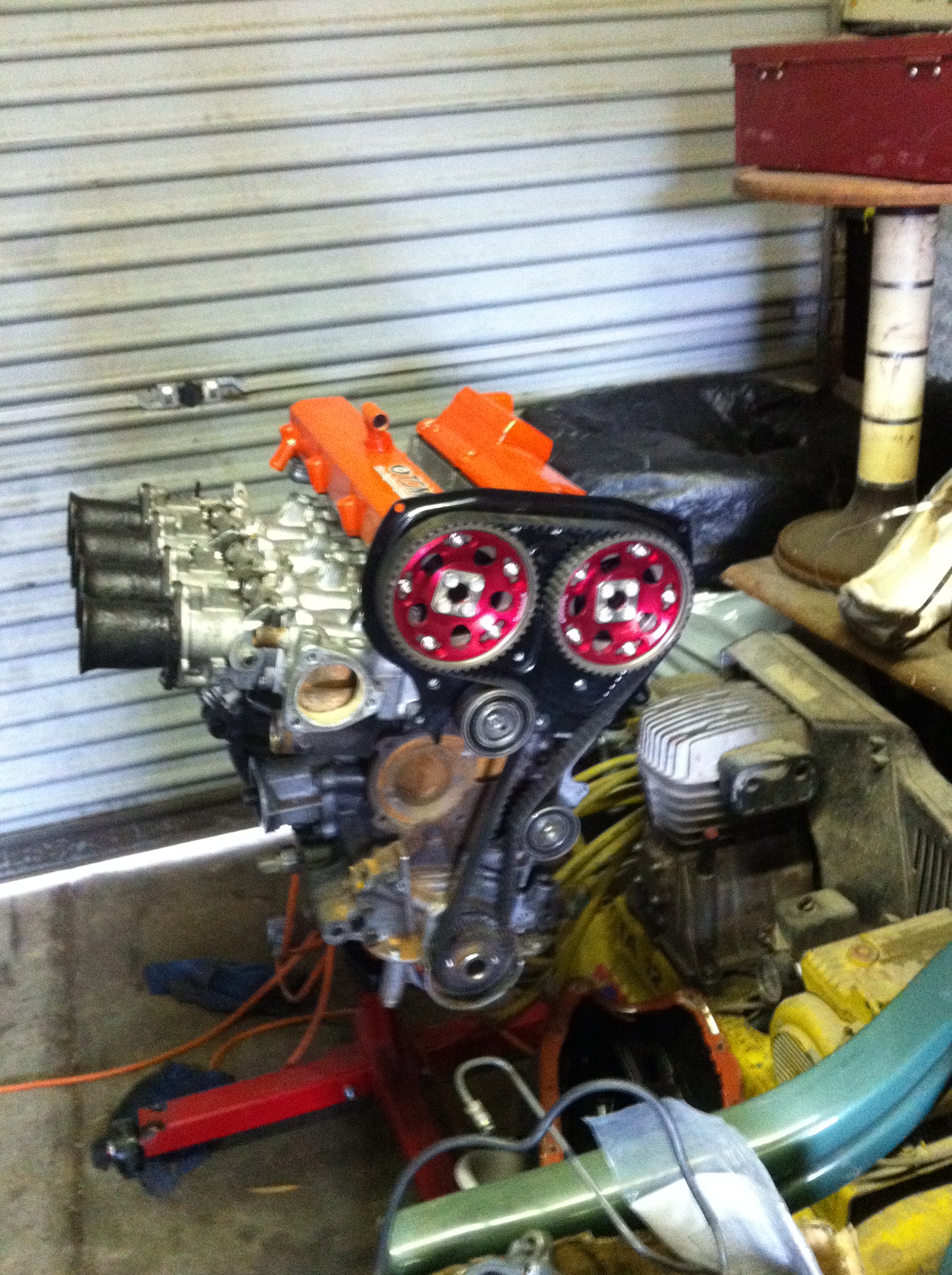

hahah yeah can't wait to have it together properly, every thing is just sitting there atm, have to heck valve to piston clearence and then take the block in to the engine bloke

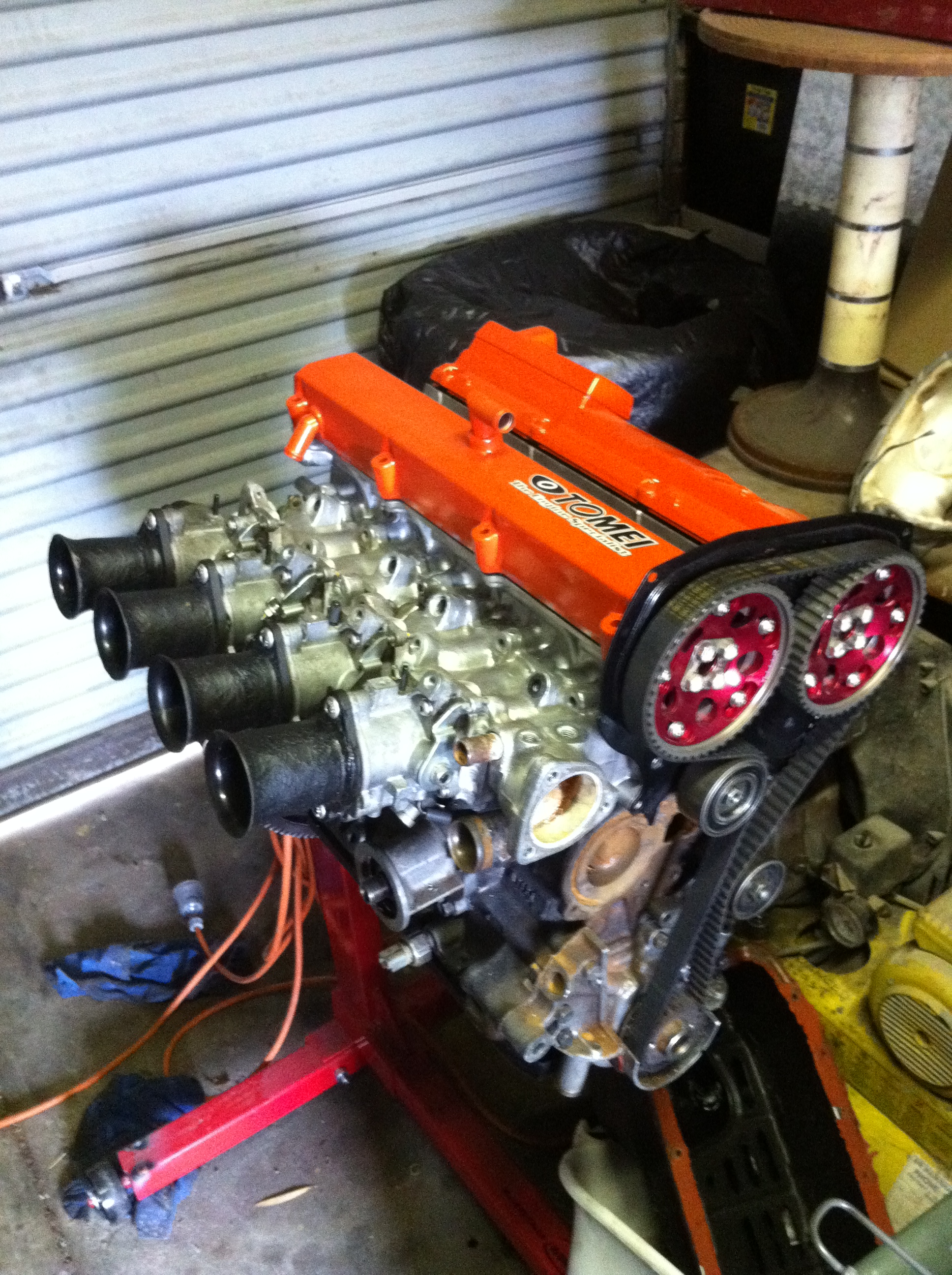

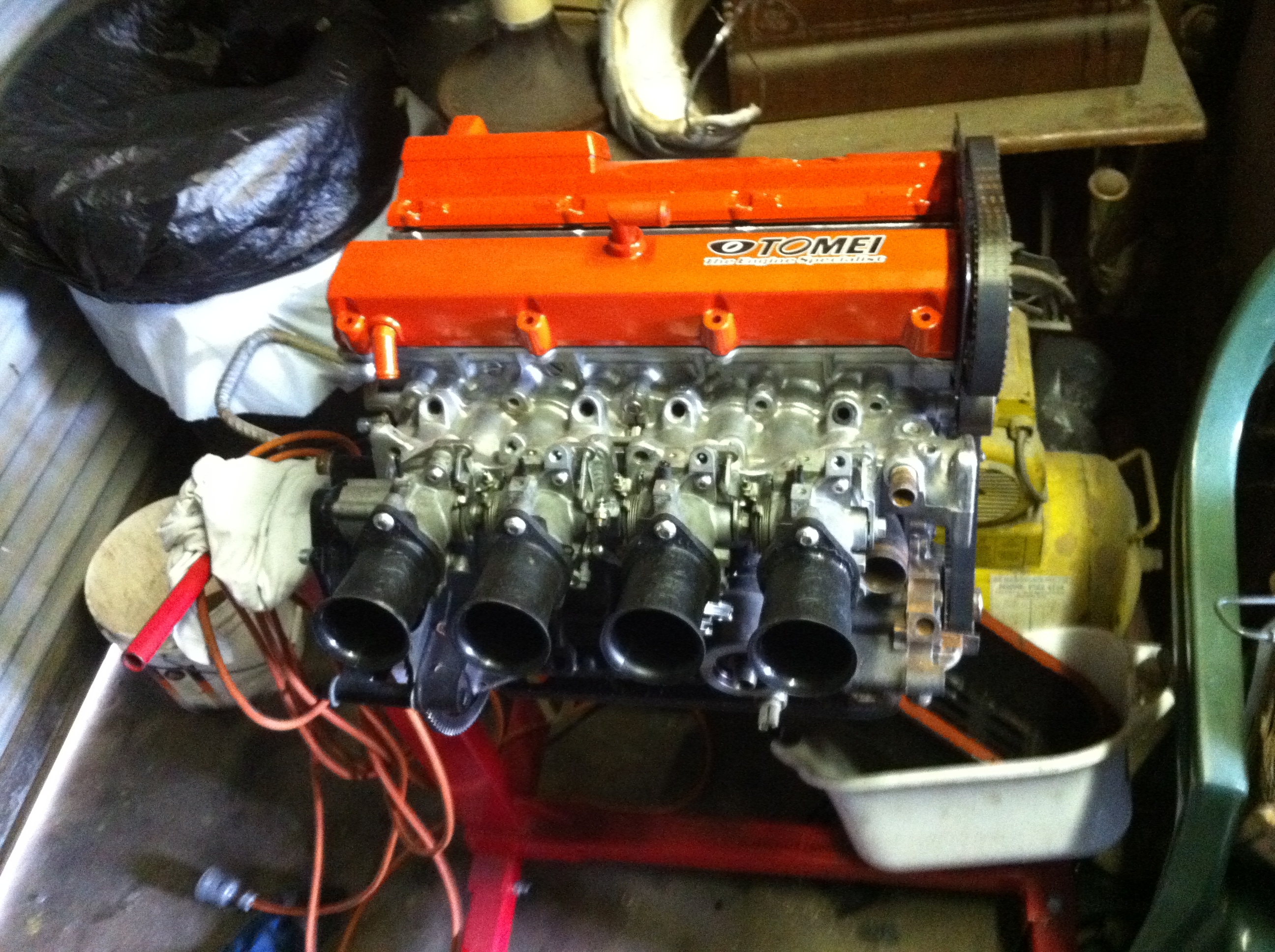

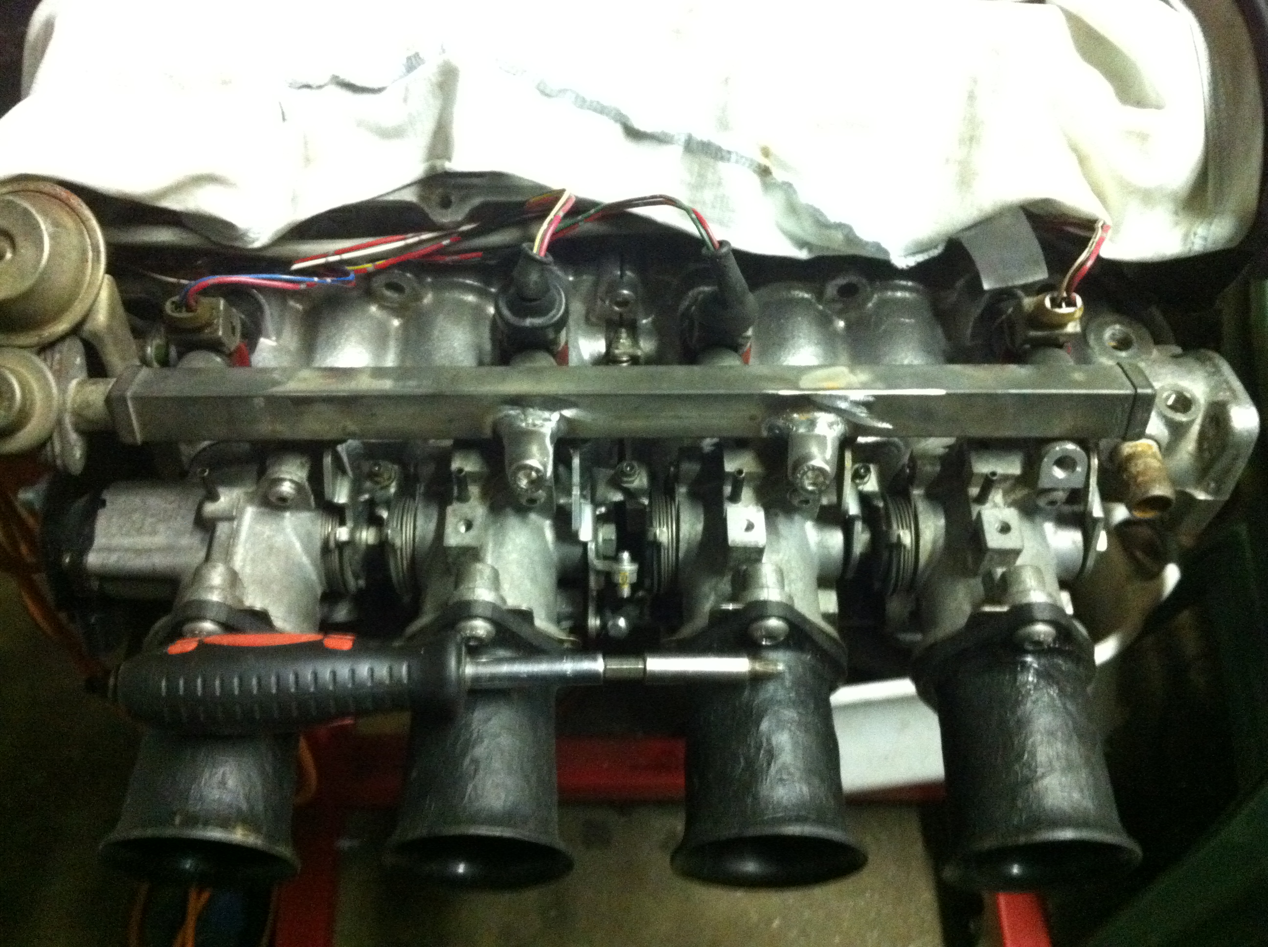

And after a few days working on the manifold, match porting all 8 runners to the head, and matching the round port of the throttle bodies to the once oval manifold, knife edged the split in the port i was finally able to bolt the quads on and the trumpets on and smash it on the motor for some, what i would say are some what horny photos :dance:

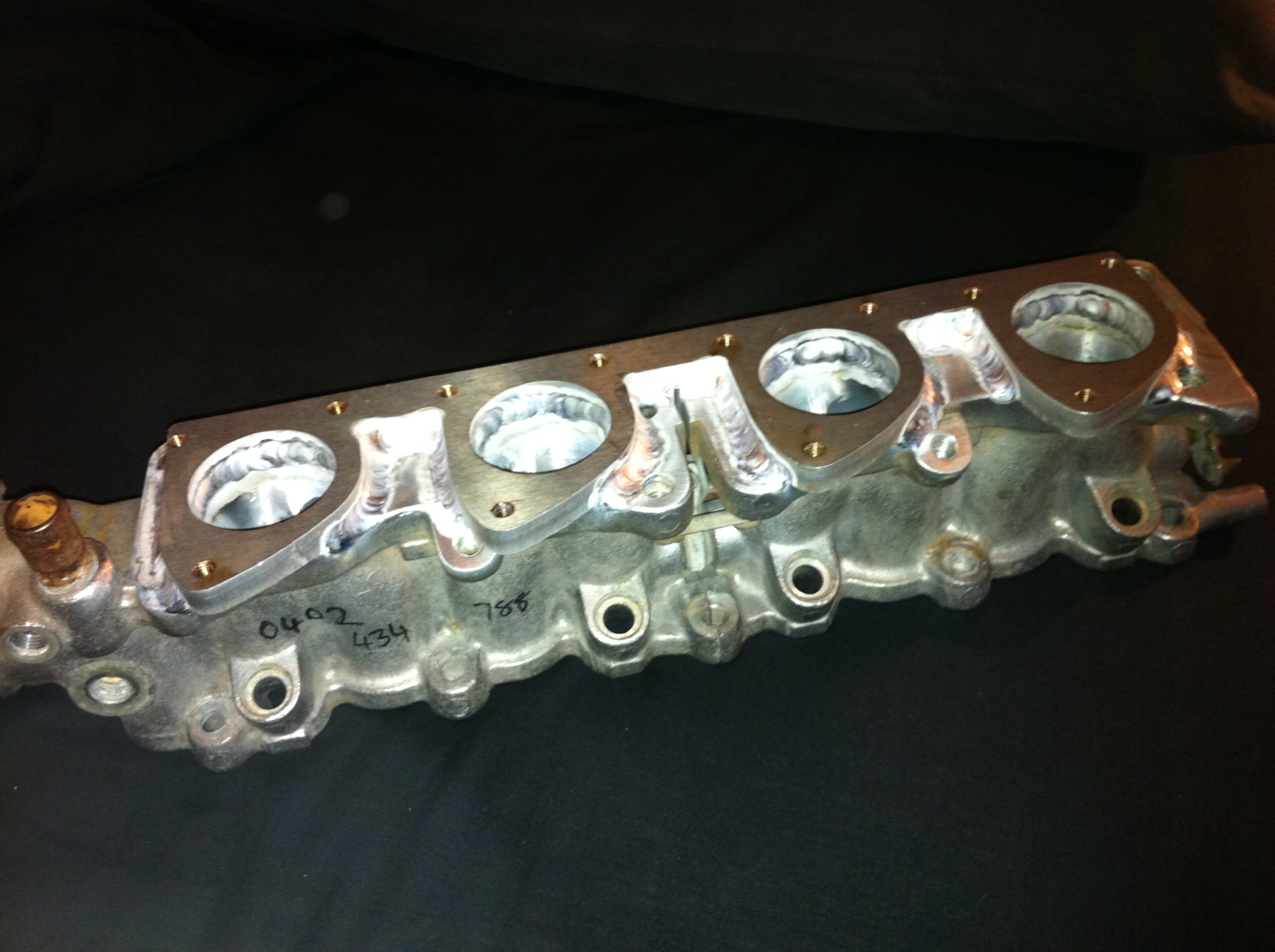

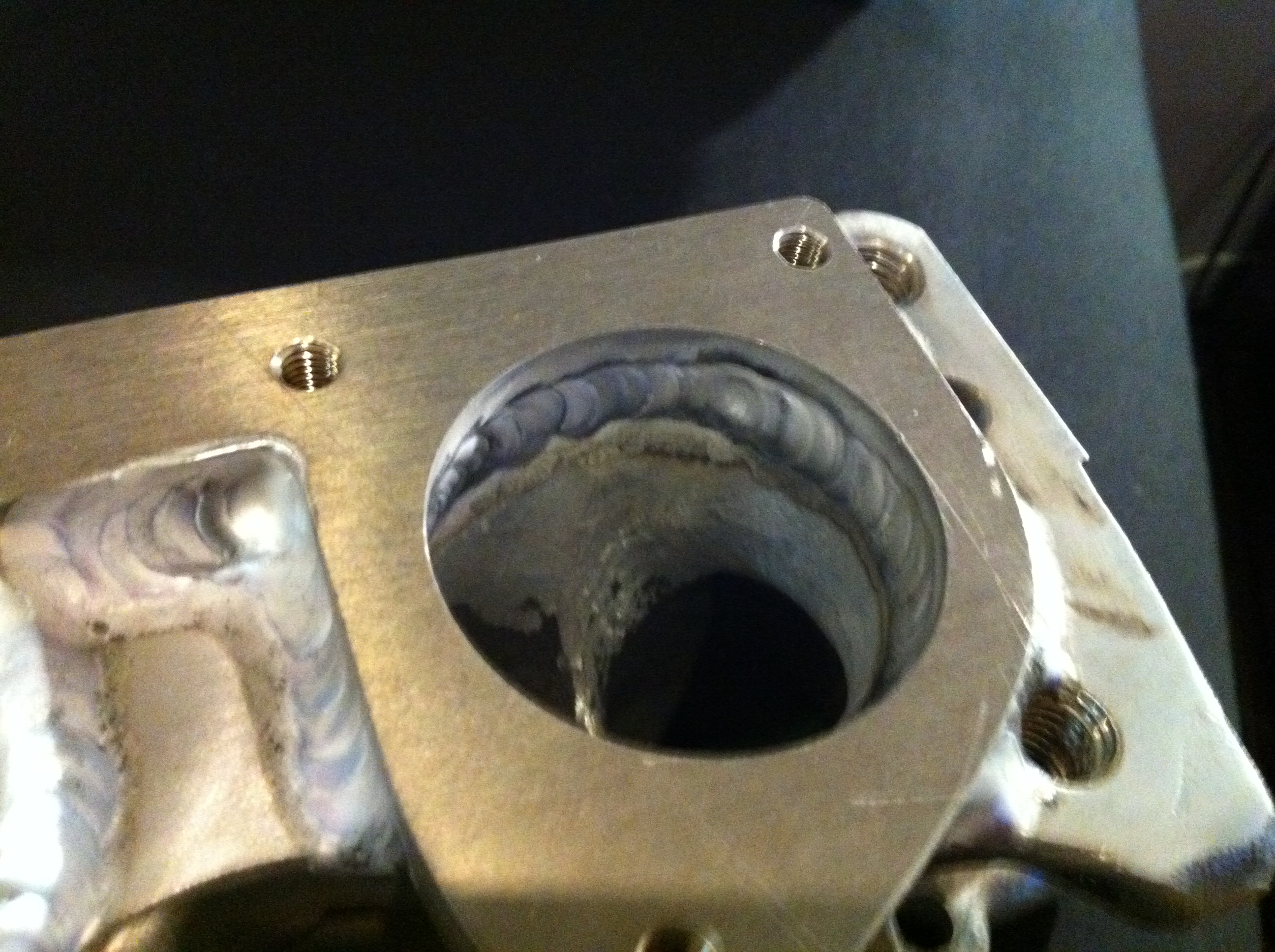

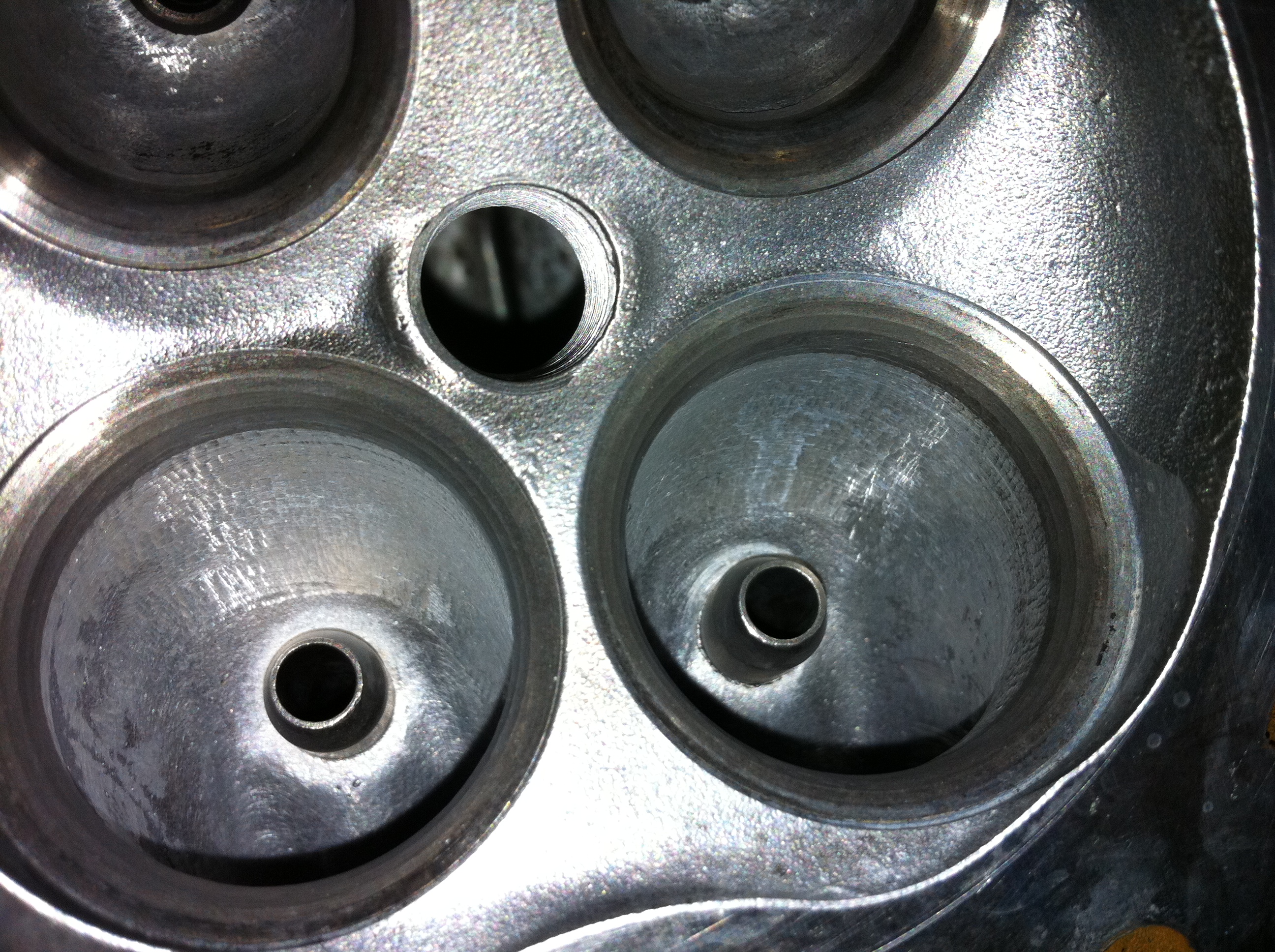

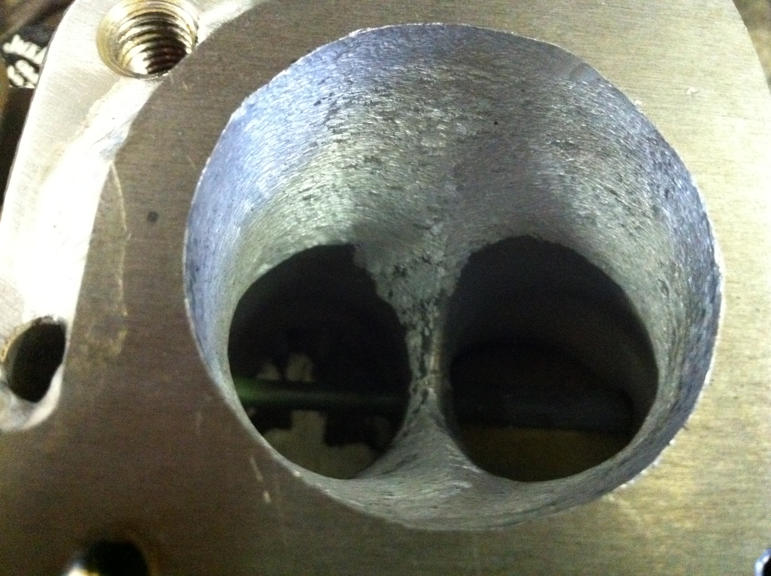

finally a decent update mate that i was getting the welding done by's welder died, so had to find some one else to do it have a friend a the local 4wd custom shop (4b fab) and he did the welding on the manifold for me, they did a top job, and only cost a cool hungy welded around the inside too grinding it out to make it all pretty again (i have since smoother all this out, just don't have photo ATM)I've done a lot of port work, and has taken some serious time, i will never ever wonder again on why porting is so expensive, because with the hours i put in it sounds cheap lol heres a pic of the work that was done in the head i also got the head back finally, had it shaved down by about 35 thou, which will give me a healthy 12:1 compression ratio, cams and cam gears are in
