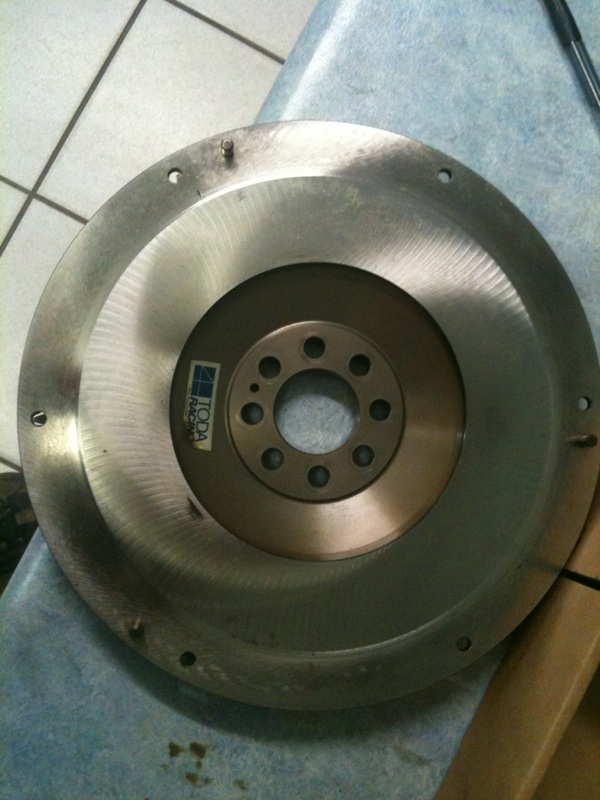

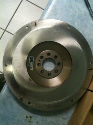

new update, haven't really done anything lately but i have bought a few things. got a new gearbox, should have that next week. i also bought this its a toda chromoly flywheel, and it only weight 5kg, factory is 13kg so should rev up a bit nicer with this sucker also collecting bits for rear end, all new nolethane bushes for the rear and new rear shocks are on order, mine old shocks have finnally given up, tyre is cutting on outer guard because of this :glare: paul

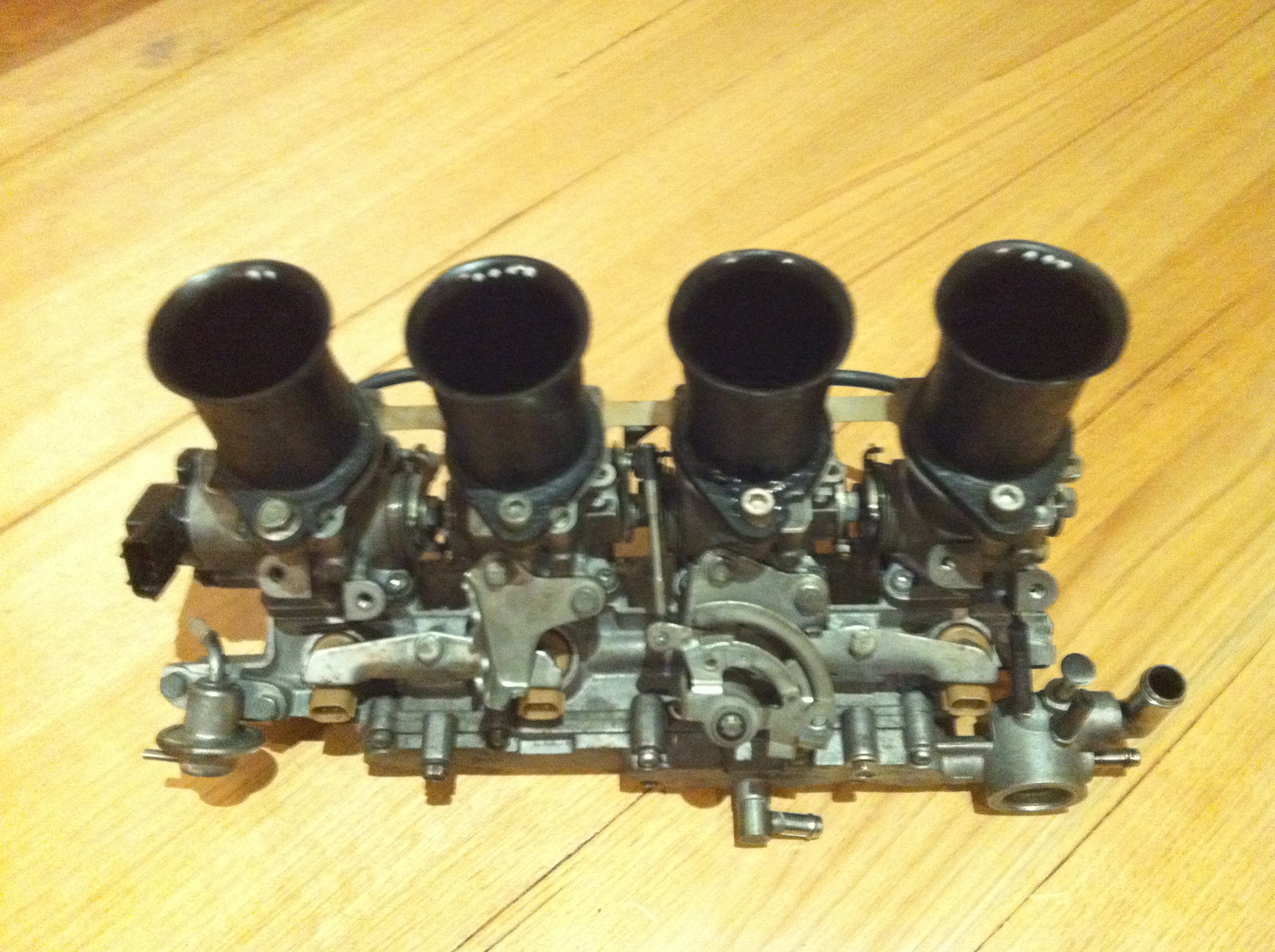

cheers mate got quads today, thought they were black tops but turns out there silver tops, not too much love lost, still going to be epic also took my second trip too dicroads today, didn't pass yesterday, and i don't think she wanted to pass me today, apparently the the car needs to have 100mm clearance fully laden, mines only just over it light, but she passed it as it was technically over the 100mm, win! might fix a few of the things that hang before i lower it again, saves the hassle, vicroads chick reckons i'll still get hassled as it is

lol, yep, my mind has been made up today, lashed out and bought a set of black top 20v quads and manifold, thinking about cams and comp while its apart getting fixed, but just collecting part atm lol, my ebay spray booth (read crappy tent/gazebo) did alright, this was all on a scoria drive way, so it can be done, there are a few bits I'm not completely happy with but this has been my first full respray and ya have to start some where yeah she is. its kinda weird getting tips from an attractive 18 year old girl on how to paint your car, lol she did a great job, specially since we had the wrong hardener for the weather, but fark I'm stocked with it=)
