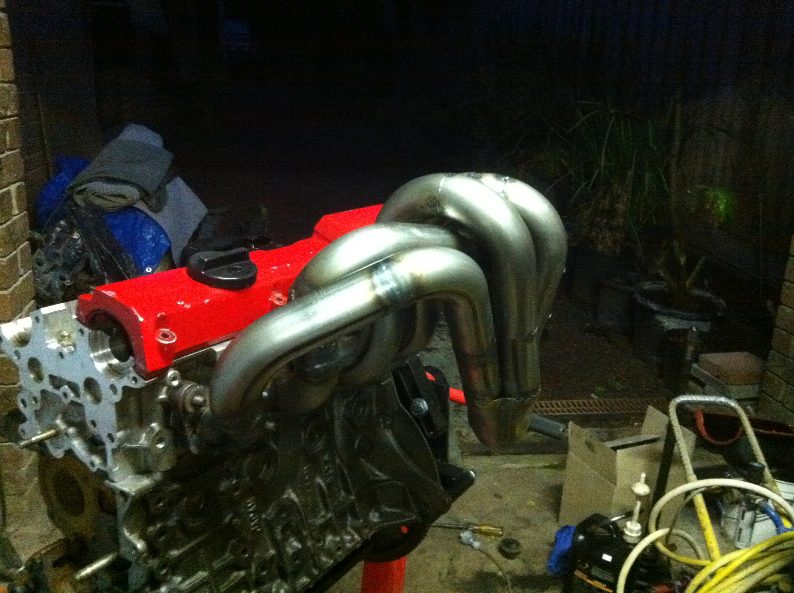

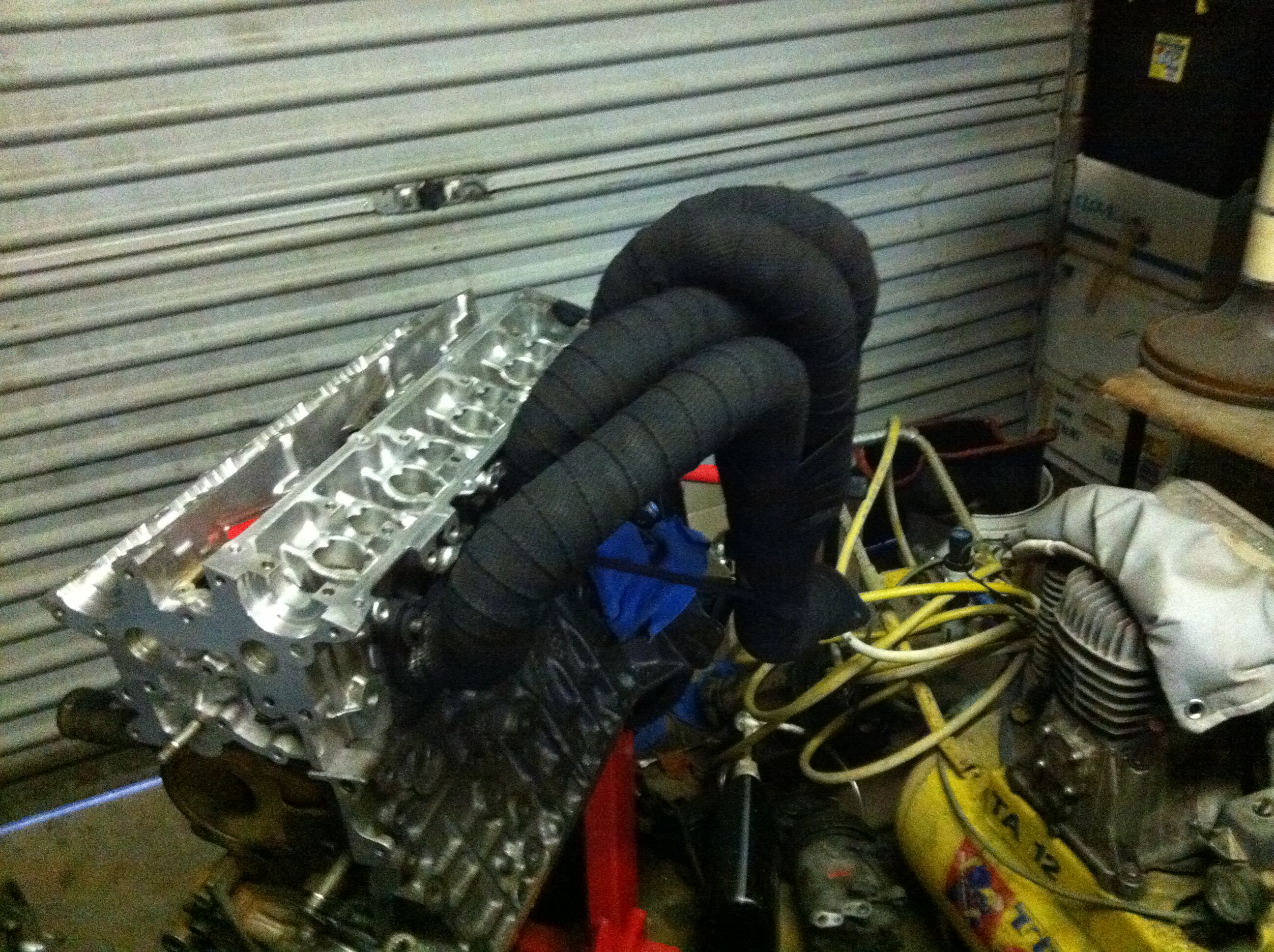

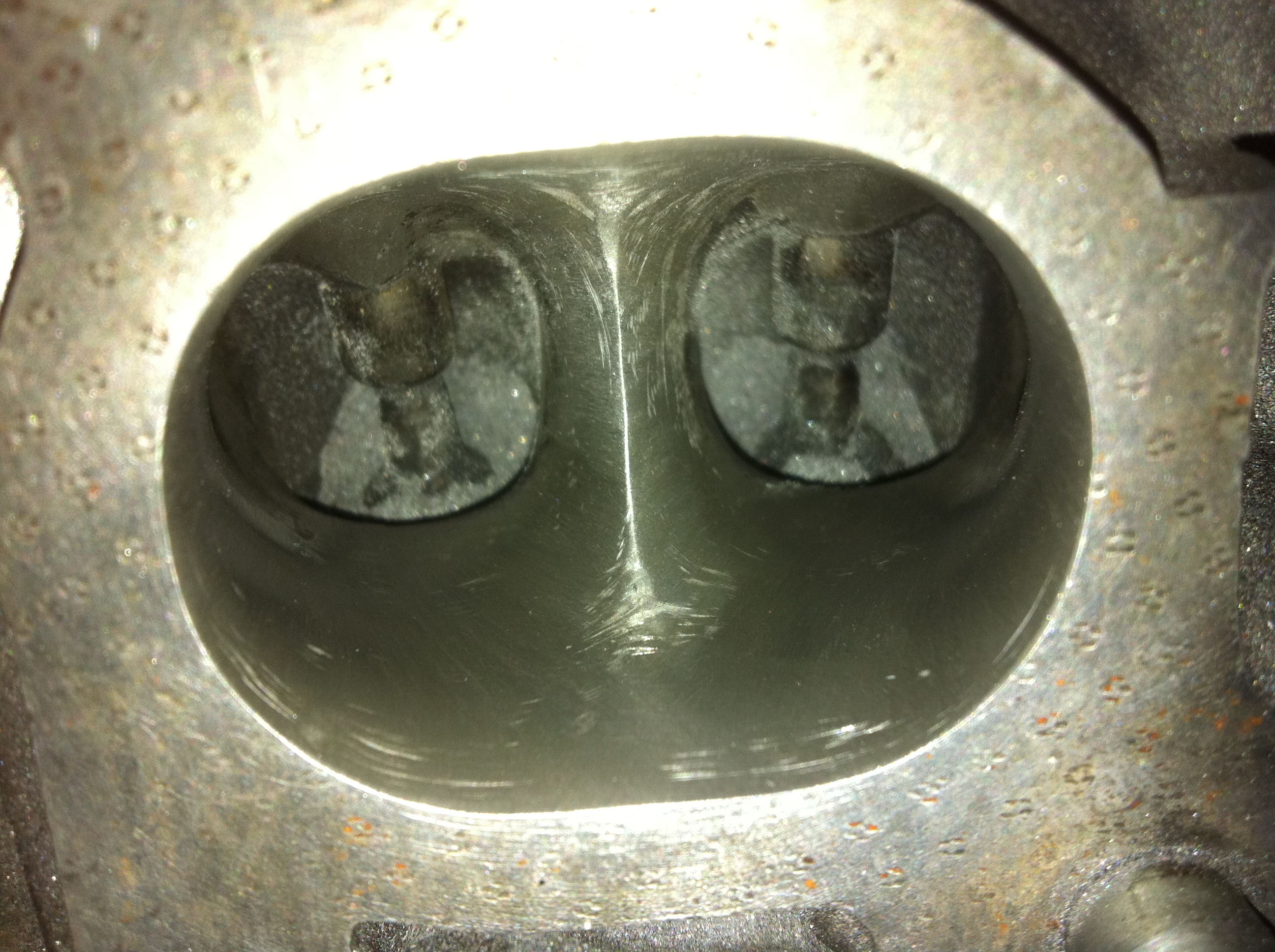

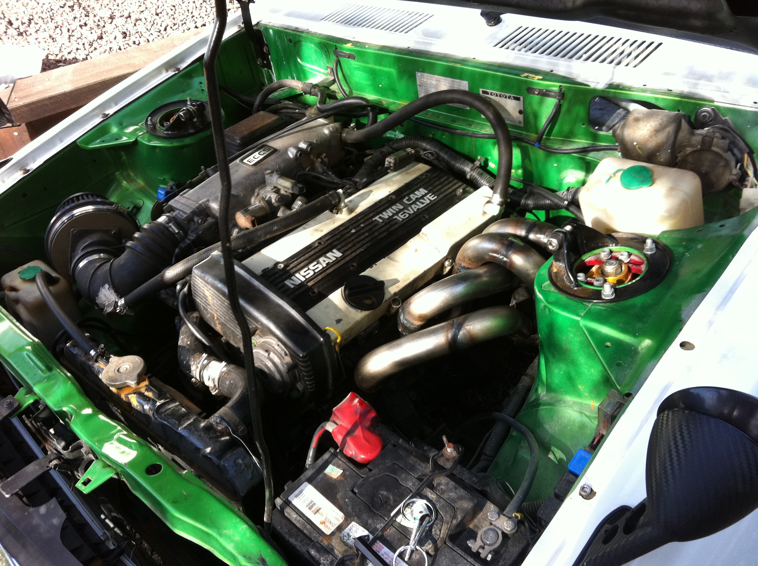

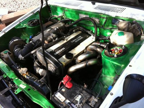

  15. update time head is finally done with the match porting and clean up, didn't get too drastic, just took out the rough bits and fixed the shit castings, it looks like its had a fair bit of work around the valves already and they a have a had a three angle job done on the seats shouldn't be long before it get sent to my head head man for machining as the valve springs have arrived just waiting on the camshafts that i have ordered there some tomei camshafts, biggest hydro ones they do, 8.8 lift and 270 duration, apparently good for 3500-8500+ which 8500rpm is where I'm going to set my rev limit shouldn't be an issue either as ive found that the new motor has arp rod bolts :dance: also been very busy with the tig, extractors are done, wrapped, painted and fitted while being built test fit in the bay and all wrapped and painted their equal length and tuned for about optimum power around the 6500rpm mark, thought this would be good even area on where it would make its power with good leeway either side when i had them fitted had and extra muffler fitted which has cut the noise done a bit, good for when i get the quads in there, bit nicer on the daily drive too also got a trd 2 way lsd from a zenki gt-apex, which i pulled down and cleaned, and just double checked everything is right, looks brand new inside, just waiting on the rebuild and solid pinion spacer kit from the states think thats about all for now paul

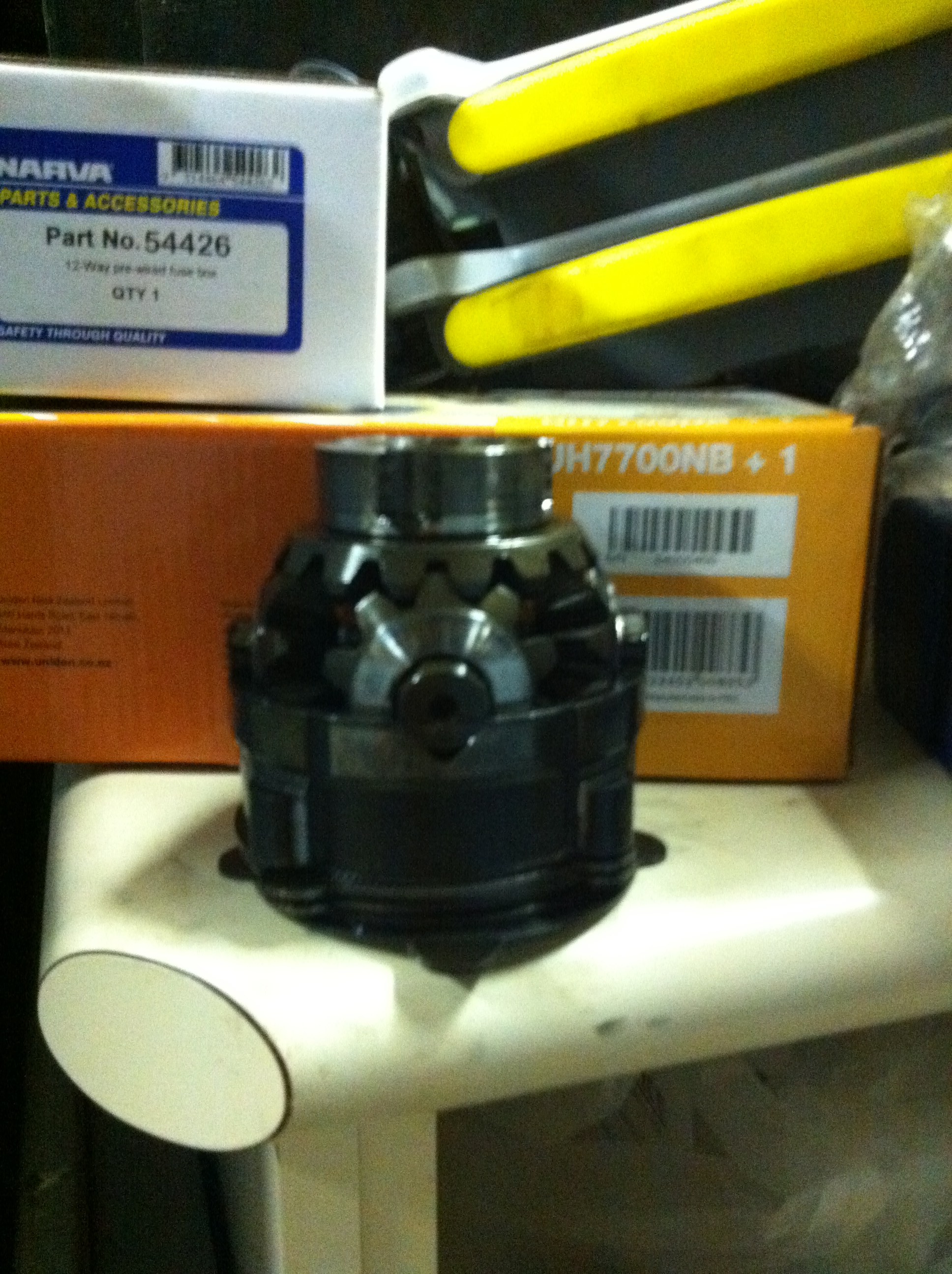

  19. grave dig, but i bought kangaroosa's, the bearings died when i ran it dry on oil, then sold it to mate, and the guy he sold the car to just sold the car on ebay and listed it had the "lsd" so it seams to have lasted, needed new springs when i got it thinking of getting a new one now

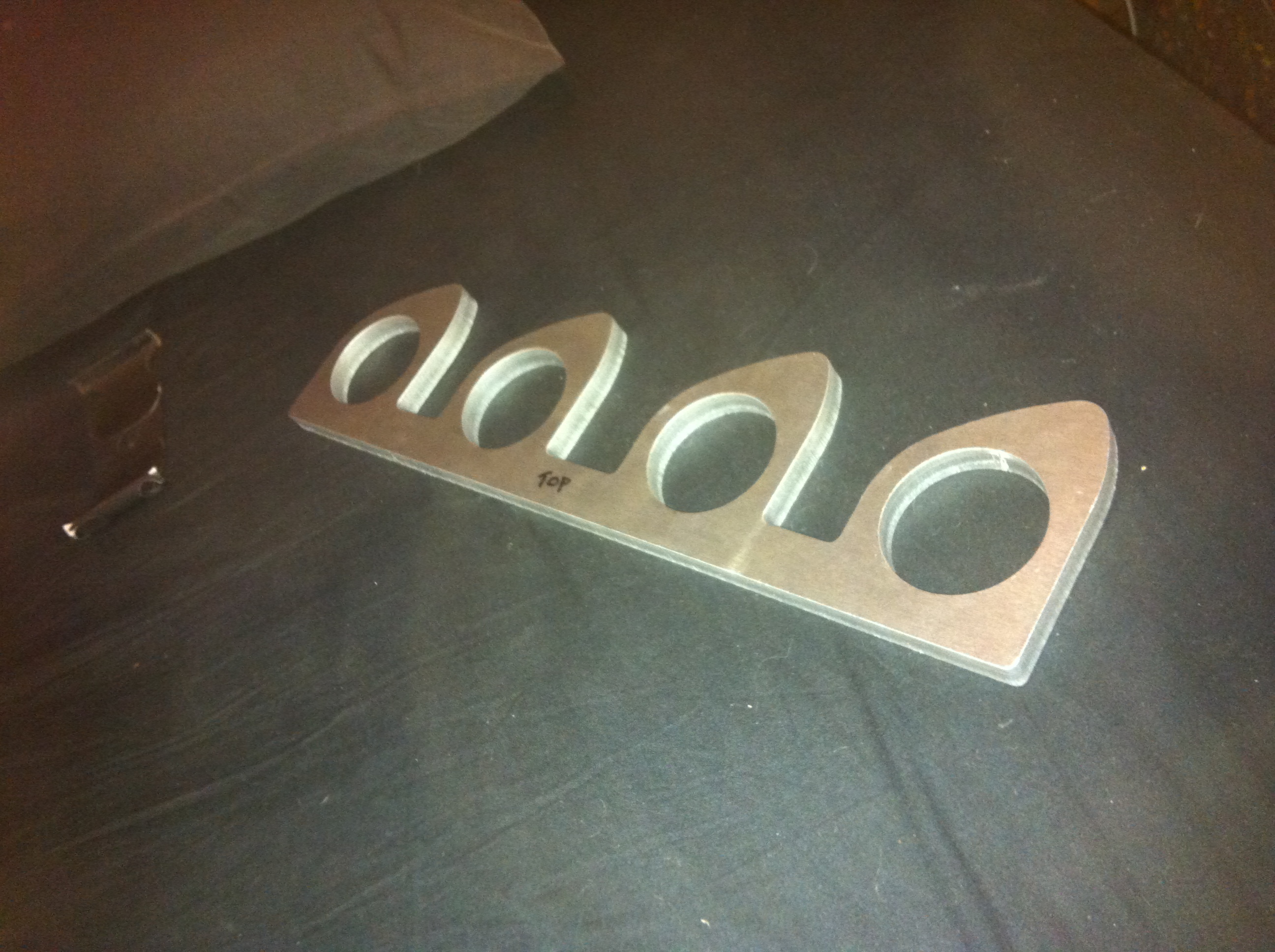

  21. could also trye st.George tryes in Sydney, yes Sydney, but was cheaper than anything i could find here:-/

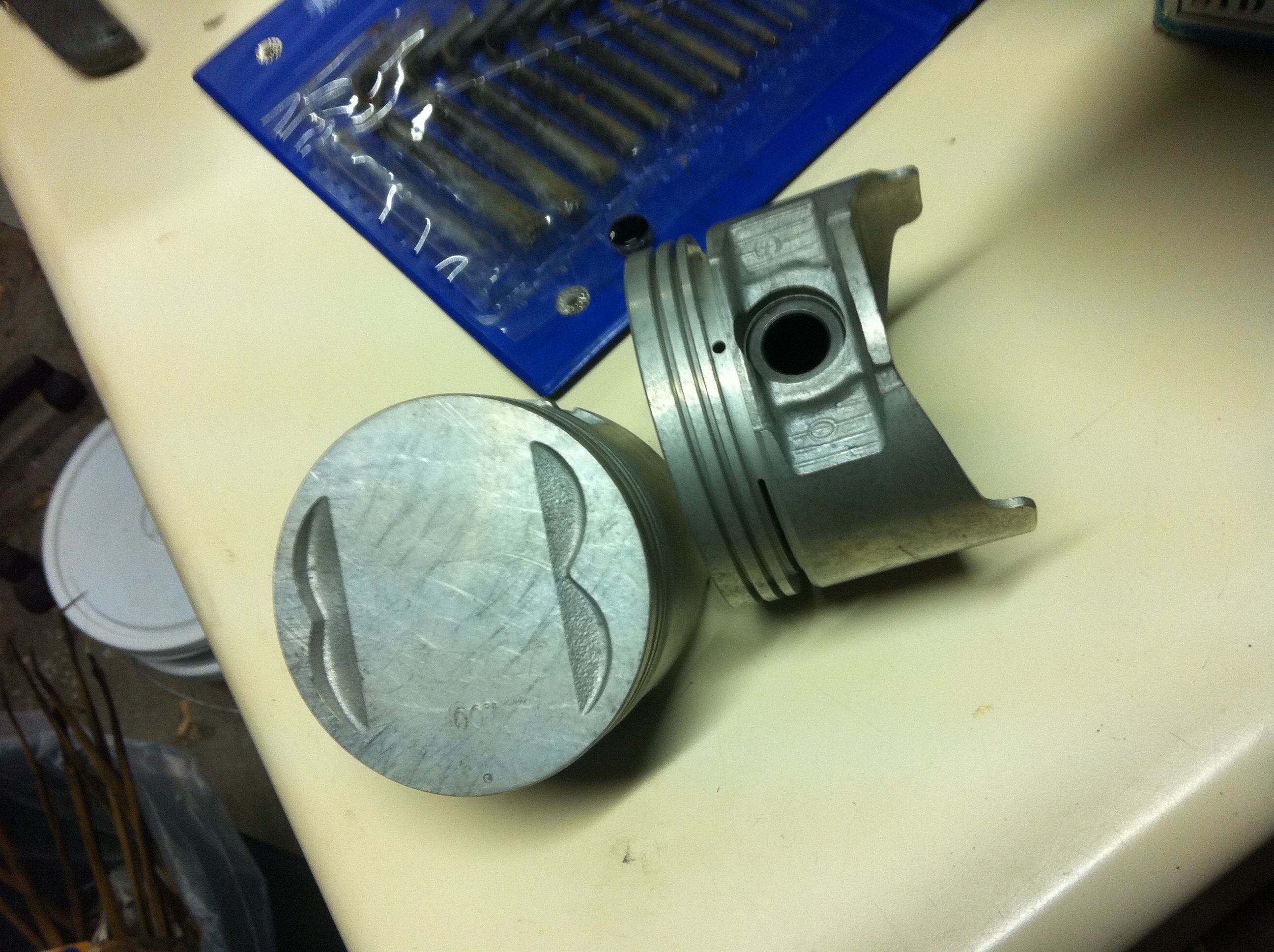

  23. little update and maybe some help? bought a new motor last week to save the rolla being off the road for the rebuild started pulling the motor apart and it seams to have had a bit of work done, over sized pistons already, only .50mm but still good, and metal head gasket, win! my question is does any one know if ca18de have dome top pistons factory? or are they flat top? done a bit of searching and can't find a decent answer paul

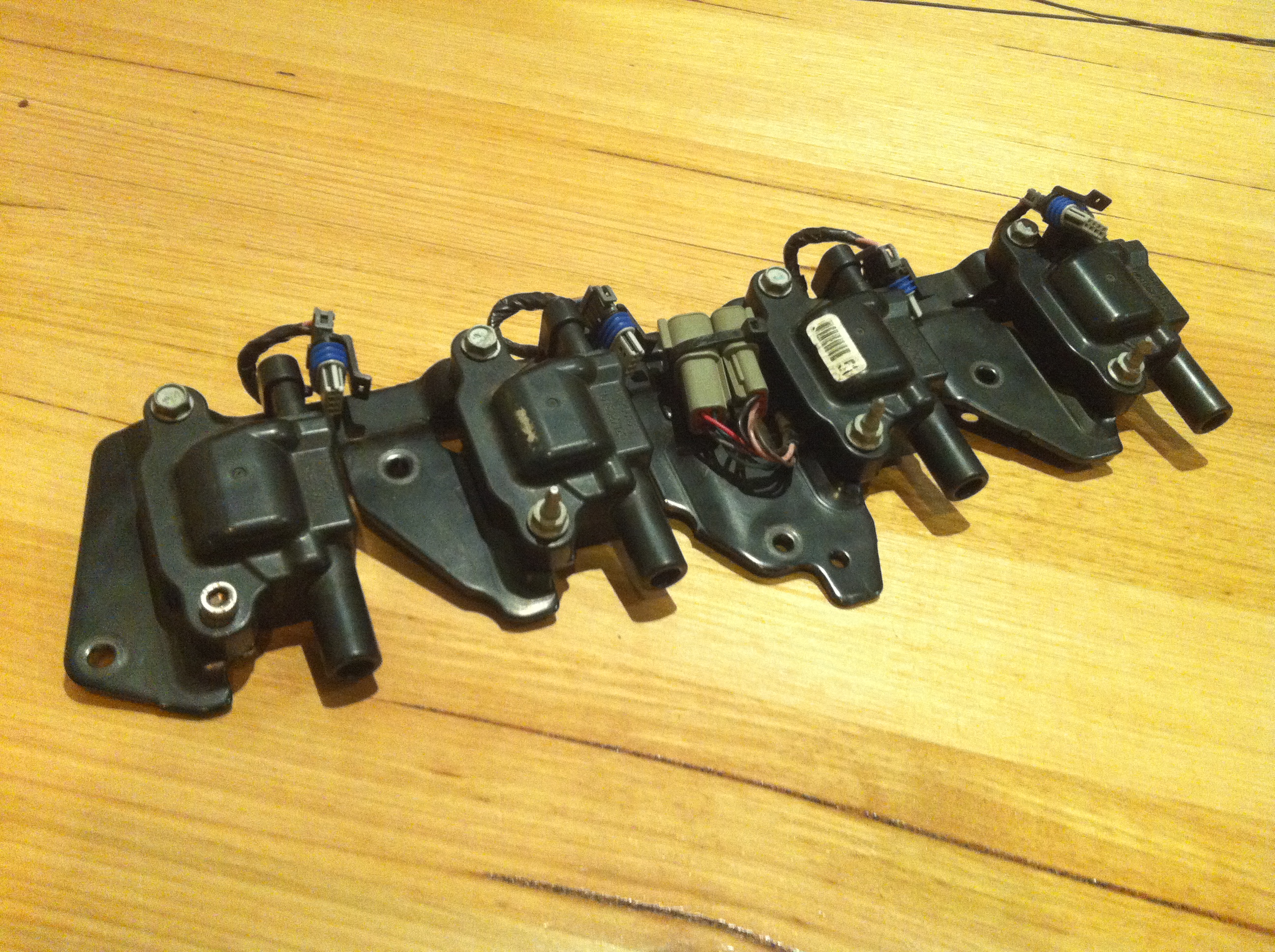

  24. yeah full set for a ls2, so i have 8 with the two looms and brackets decided today to triangulate the strut brace since i have some rod ends left over also forgot to add i got pistons, 1mm over sized, doesn't leave any room if i damage one but brings up comp and the displacement by about 50cc paul

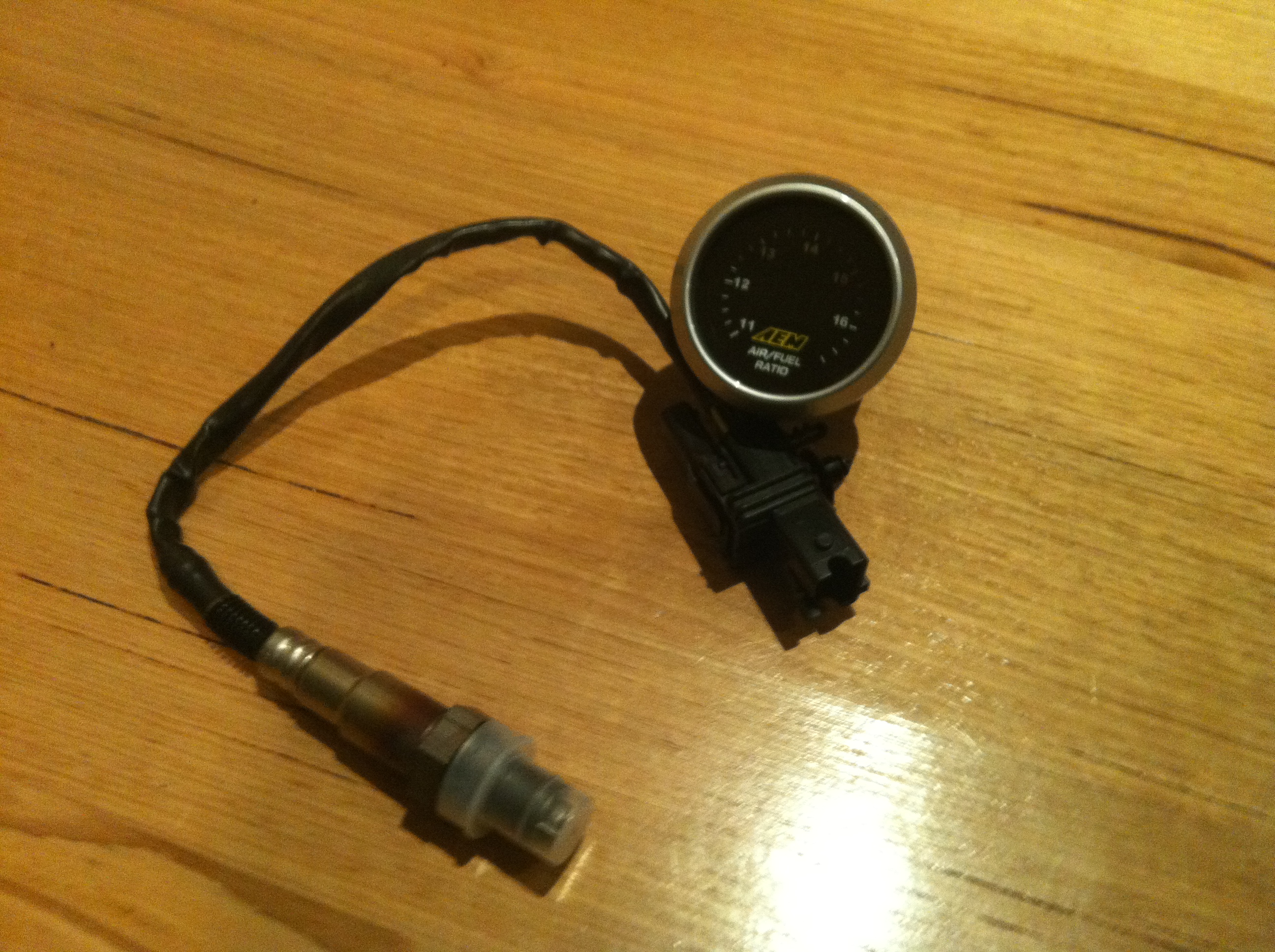

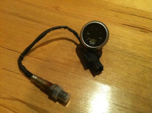

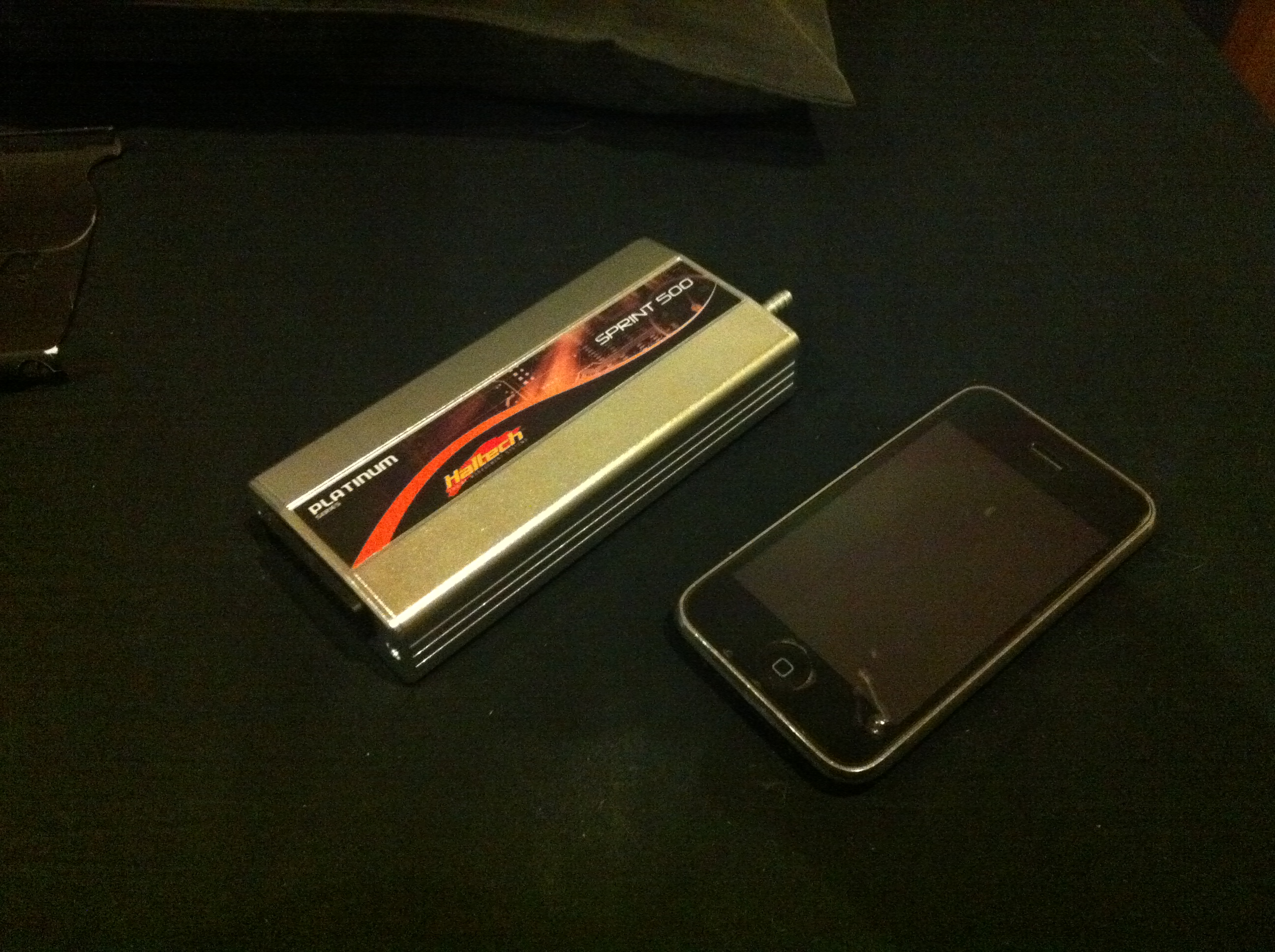

  25. ok now for all the shinny bits AEM wide band controller and sensor haltech sprint 500, iphone is there to show how small this thing is full set of ls2 coils, have to make a better bracket and get custom leads made up and the horribly expensive plate i had cut to be welded onto my manifold so i can fit the quads hopefully get this welded up in the next couple of days
