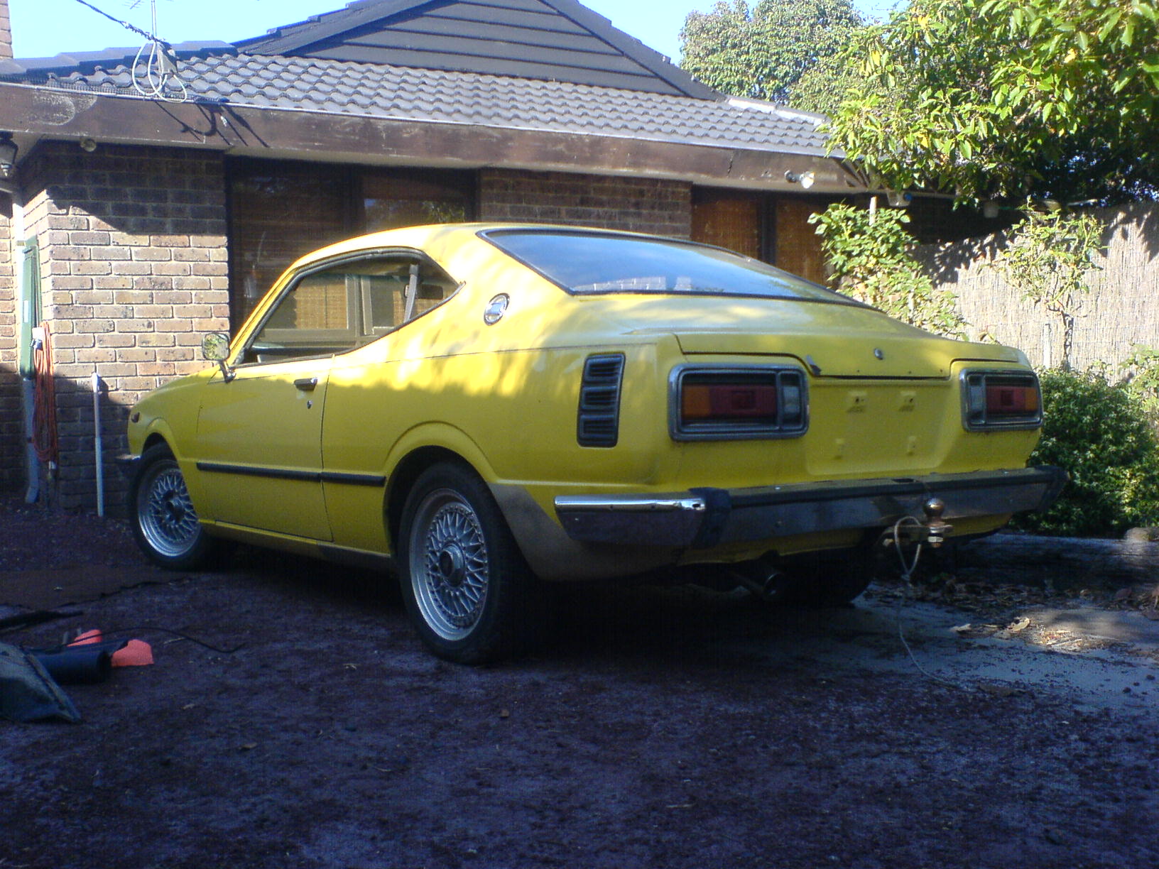

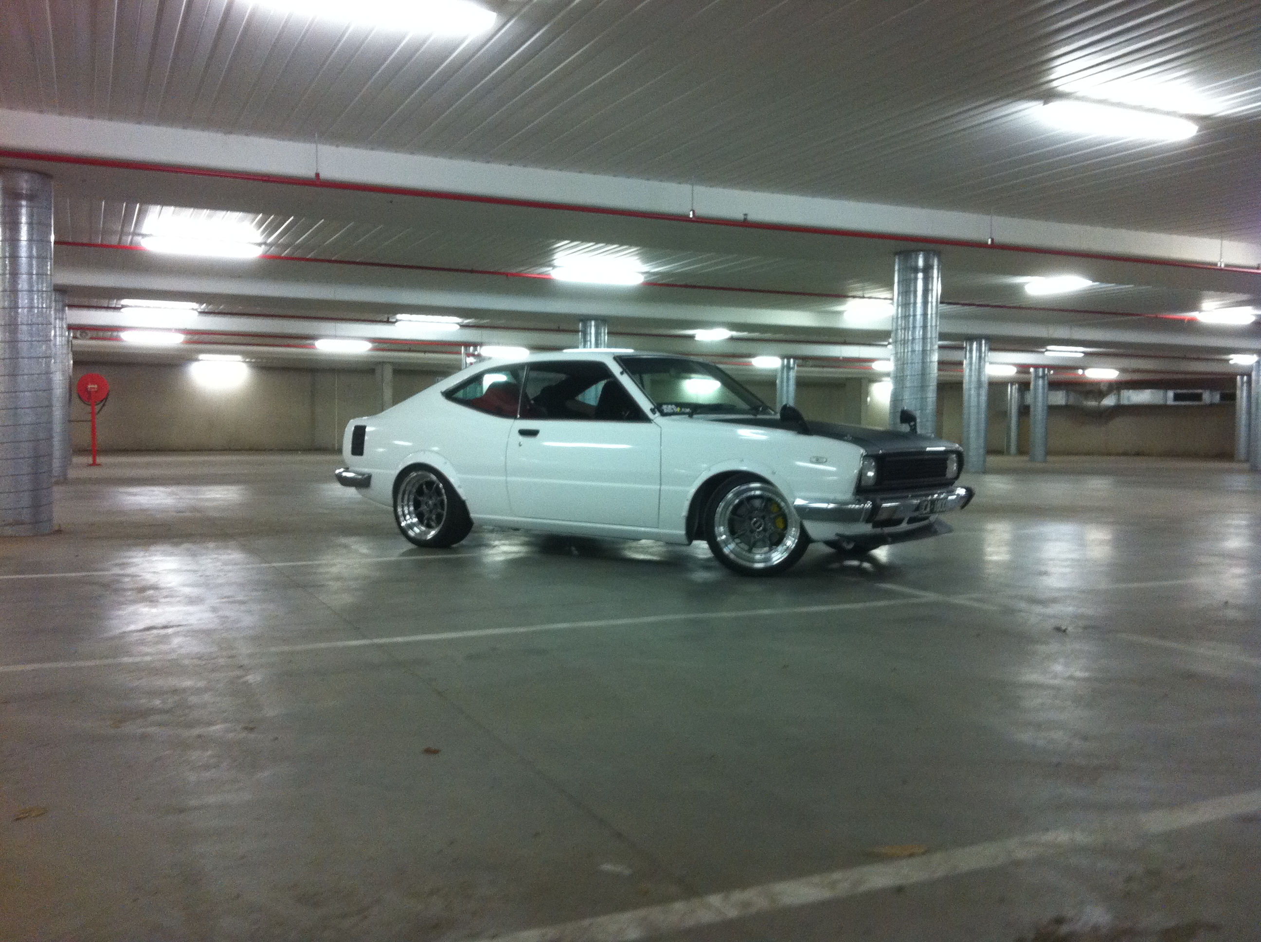

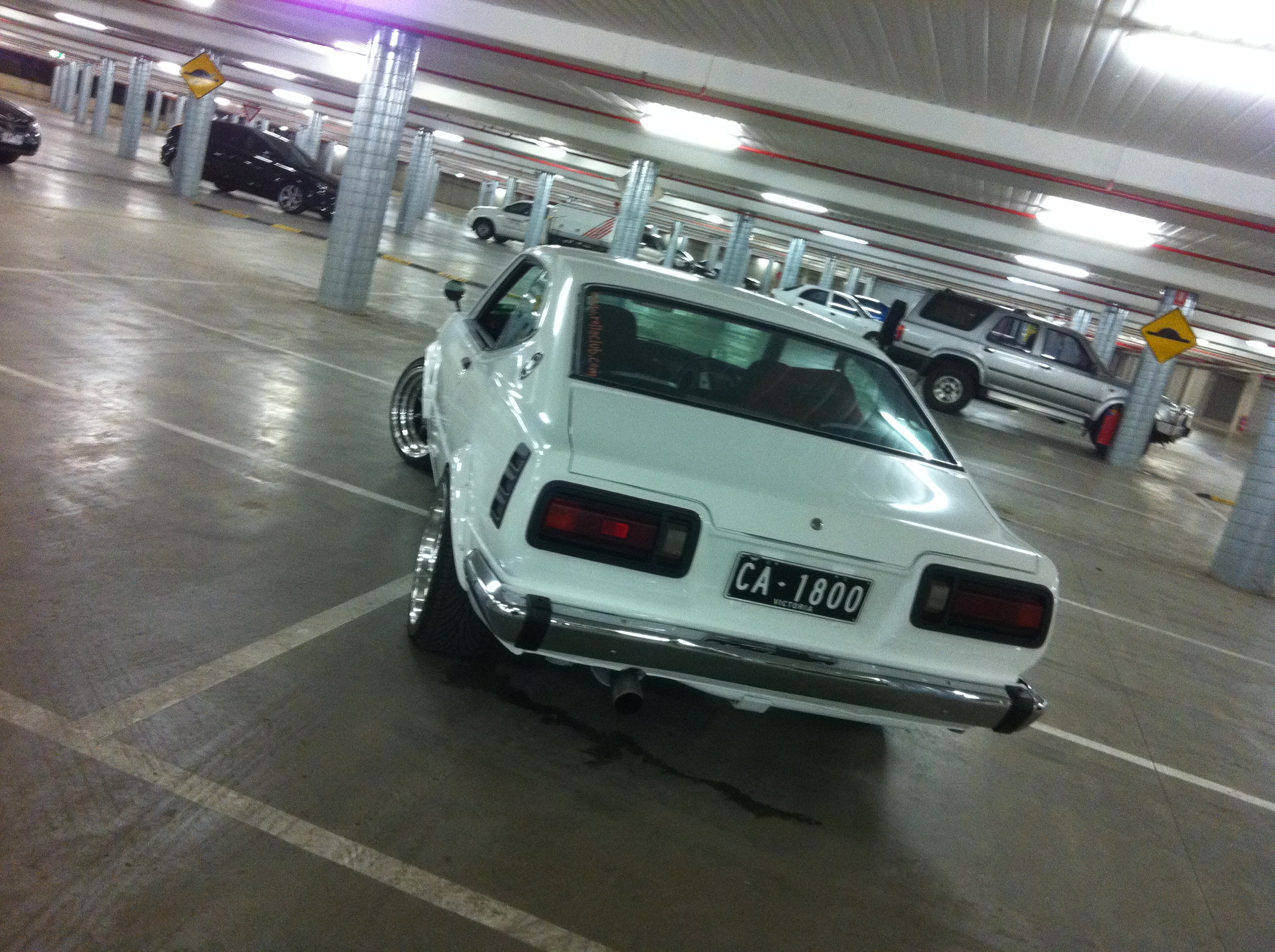

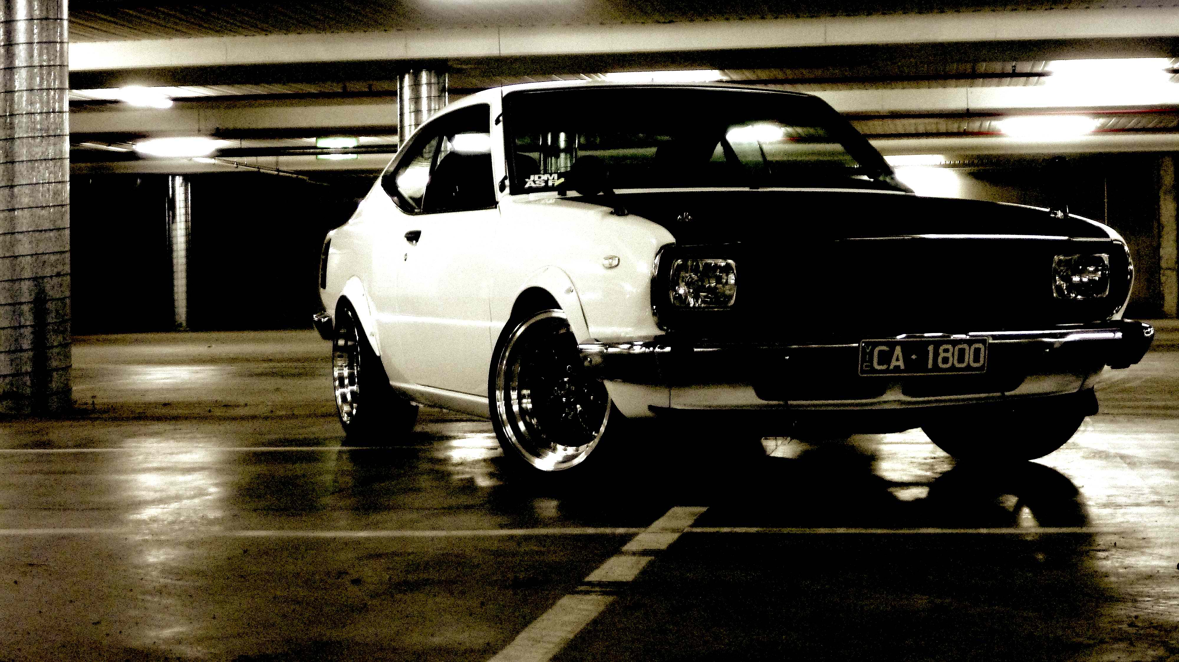

  1. painting all nice a white then came putting it back together, got a few goodies to go with it rebuilt the front end, including kyb excel-g st185 inserts, 6.25kg 200mm free height springs shortened struts buy 40mm, t3 camber tops and spring hats, ae86 steering arms and GH sigma control arms got ke36? bonnet, fender mirrors, chin spoiler and modified the rear vents and covered them all in the 3m ni-doc carbon wrap ba side indicators, cleared the fronts, and resprayed the rears, and wrapped the surrounds all new rubbers and locking strips, all chrome work was loving polished by the one and only teddy (thanks very much for that man :y: ) and the best bits, new wheels 16x8 +0 offset and te27 flares so here is how it stands now big thanks to teddy for coming down a week earlier to help me finish it off for the cruise, wouldn't have been quite as nice with out him paul

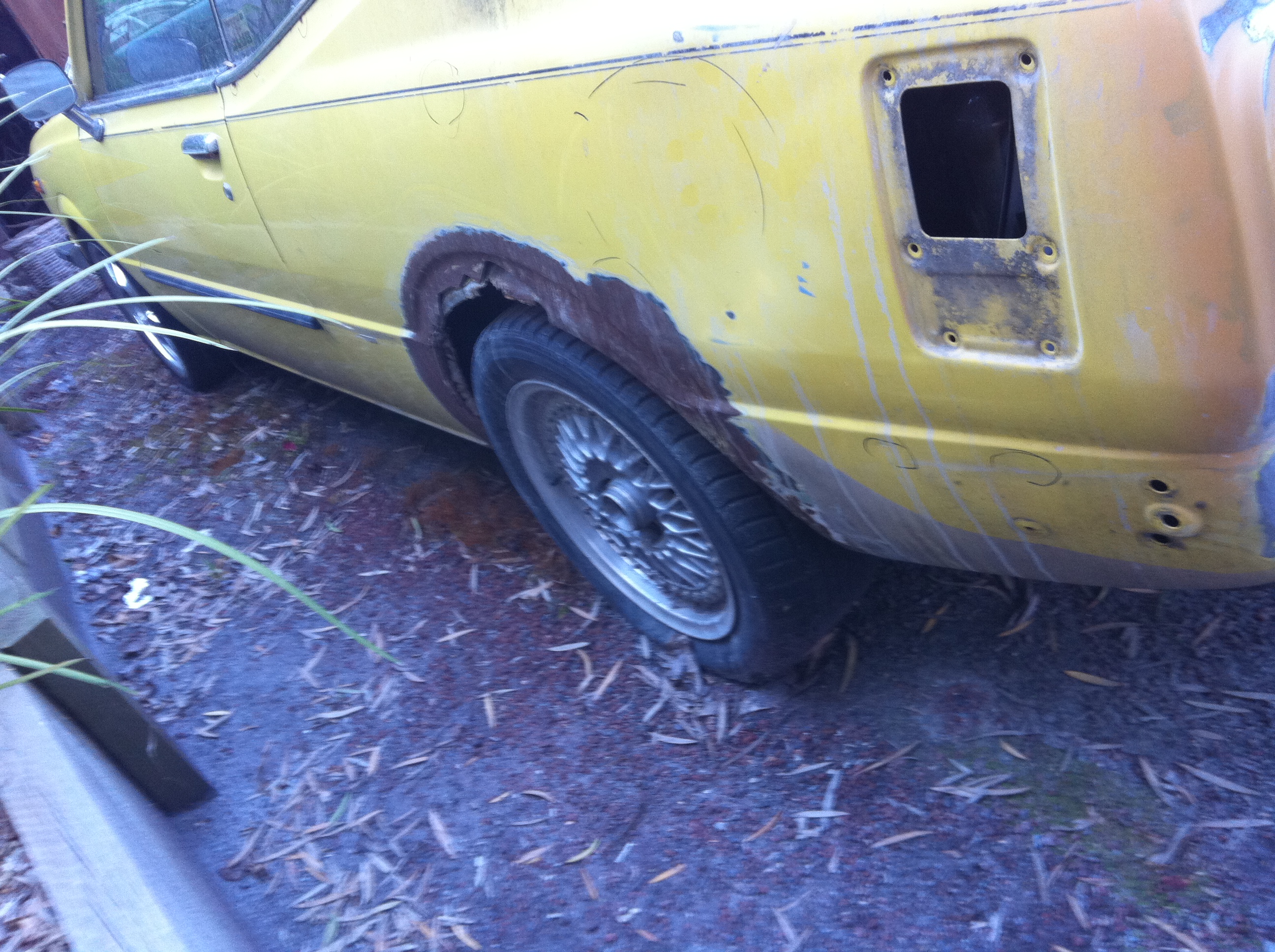

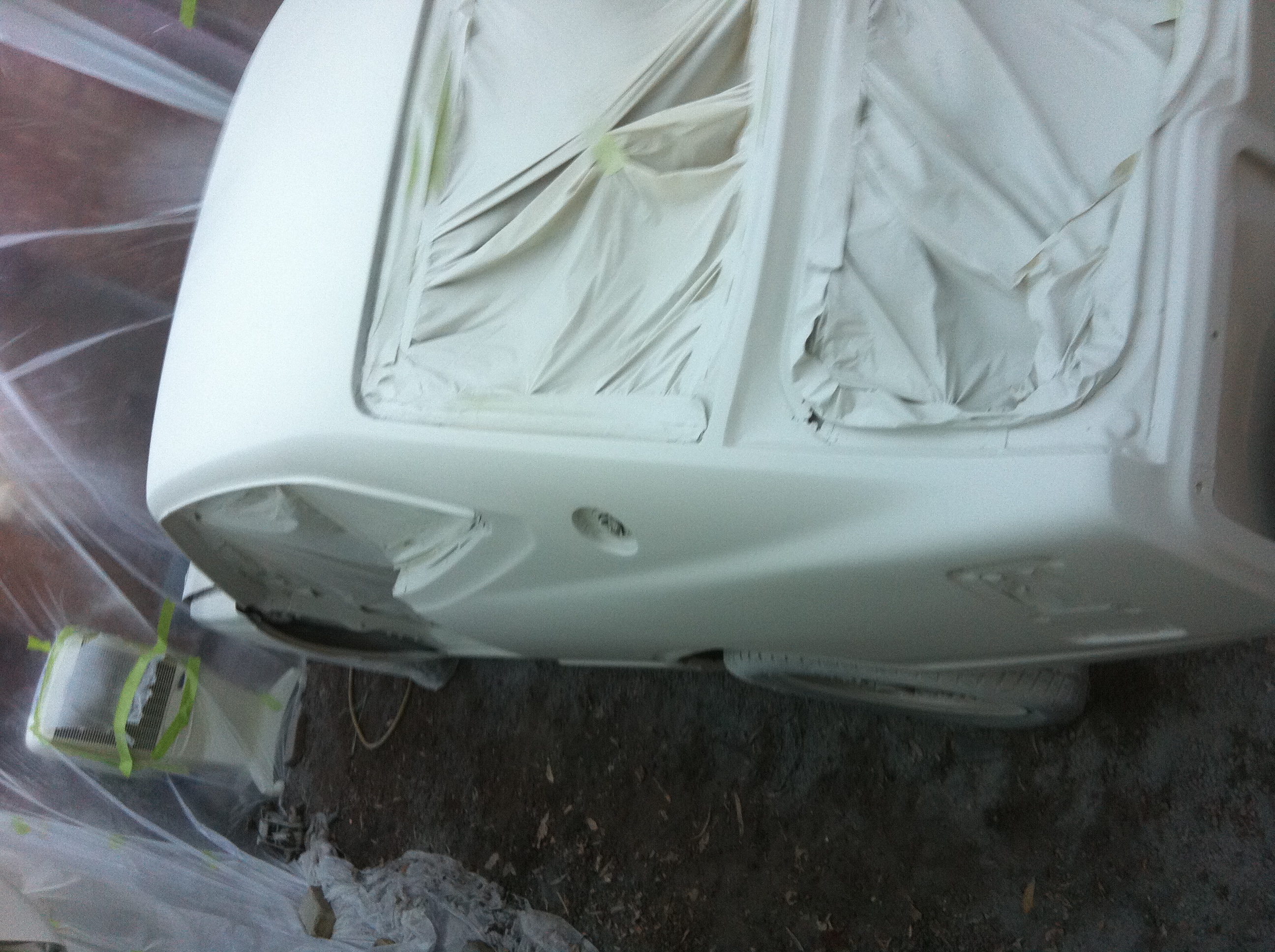

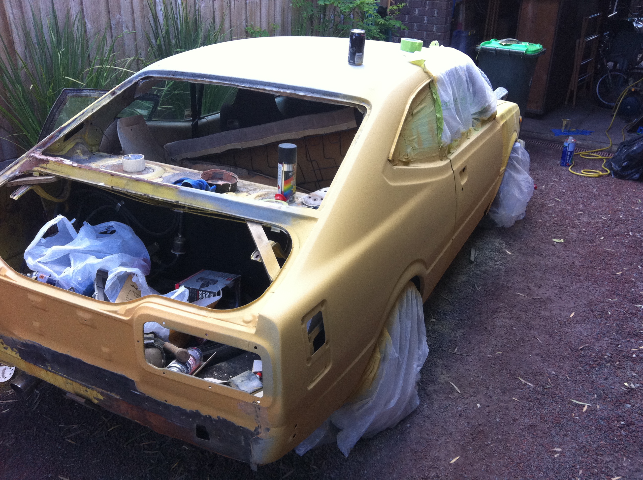

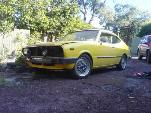

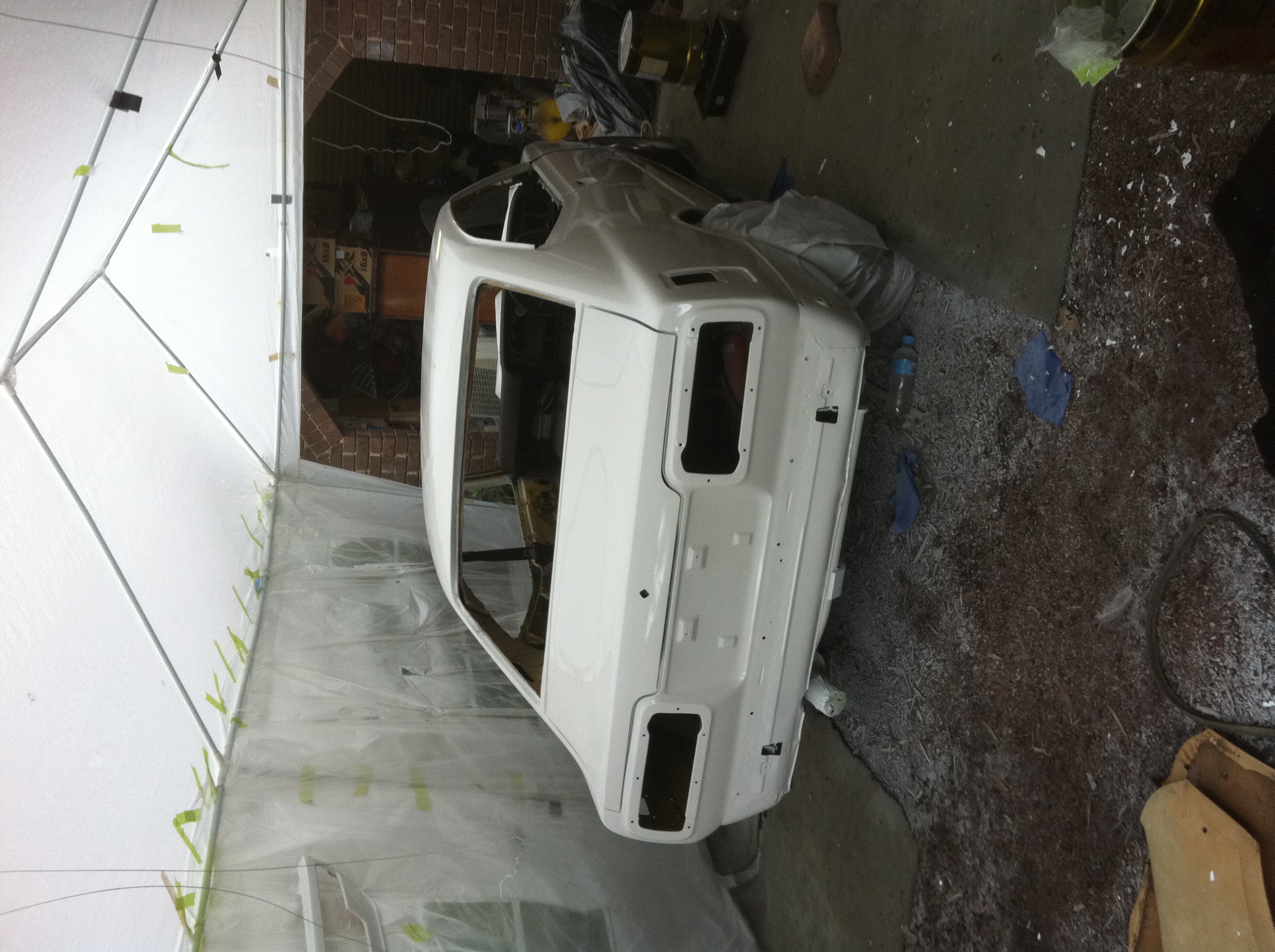

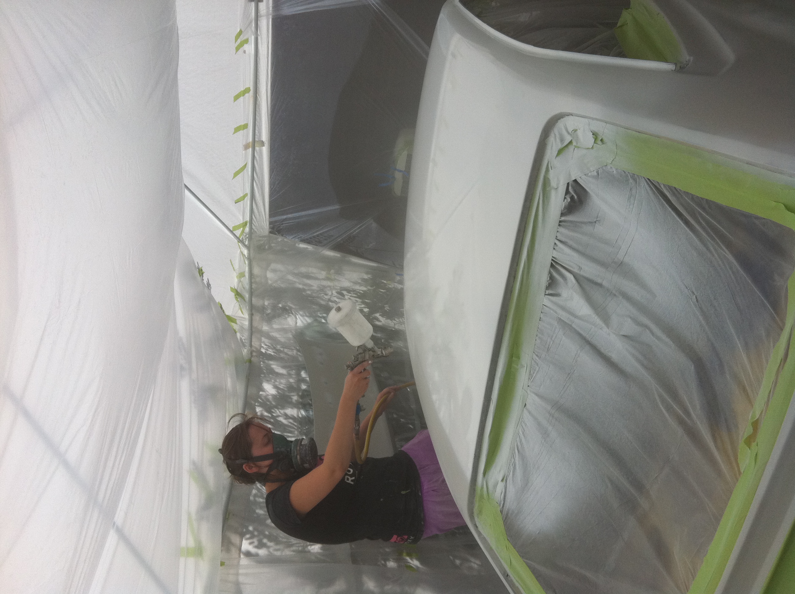

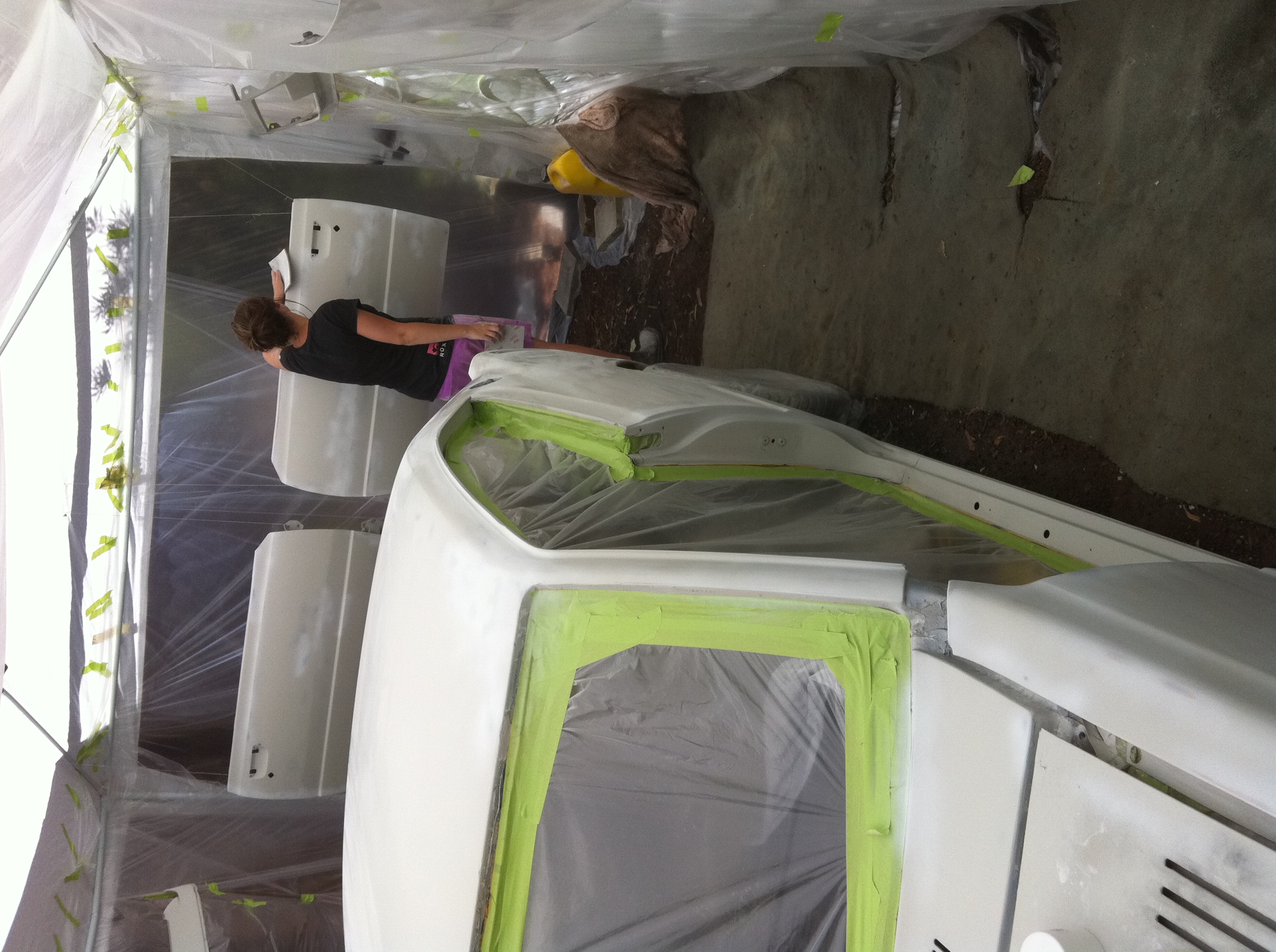

  2. rolla stayed like this for ages, until my stupidity, putting too wide a tyre on the rear, smashed all the bog and rust out of the guards, the whole car was in realy poor shape, it looked ok from a distance, but really needed some work there was more rust that needed to be sorted too, so i pulled it off the road to fix it up. got a bit into fixing it and then i lost interest (body work is balls) and i was having trouble with what to do with one on the rear guards, it was really bad it sat like this for nearly 18 months, then a Tate's wedding, i got some motivation back, and i needed it done for the 5th GOR cruise so i went like a cut cat, fixed all the bodged repairs 2pac primed wet sanding got scared of wrecking all my hard work and got a friend to paint it for me, all taped up ready to go

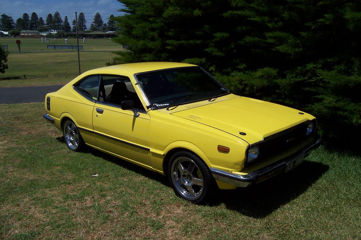

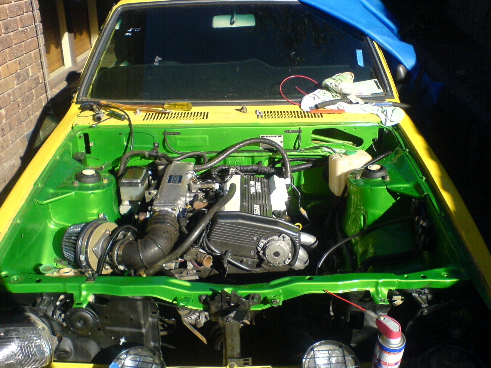

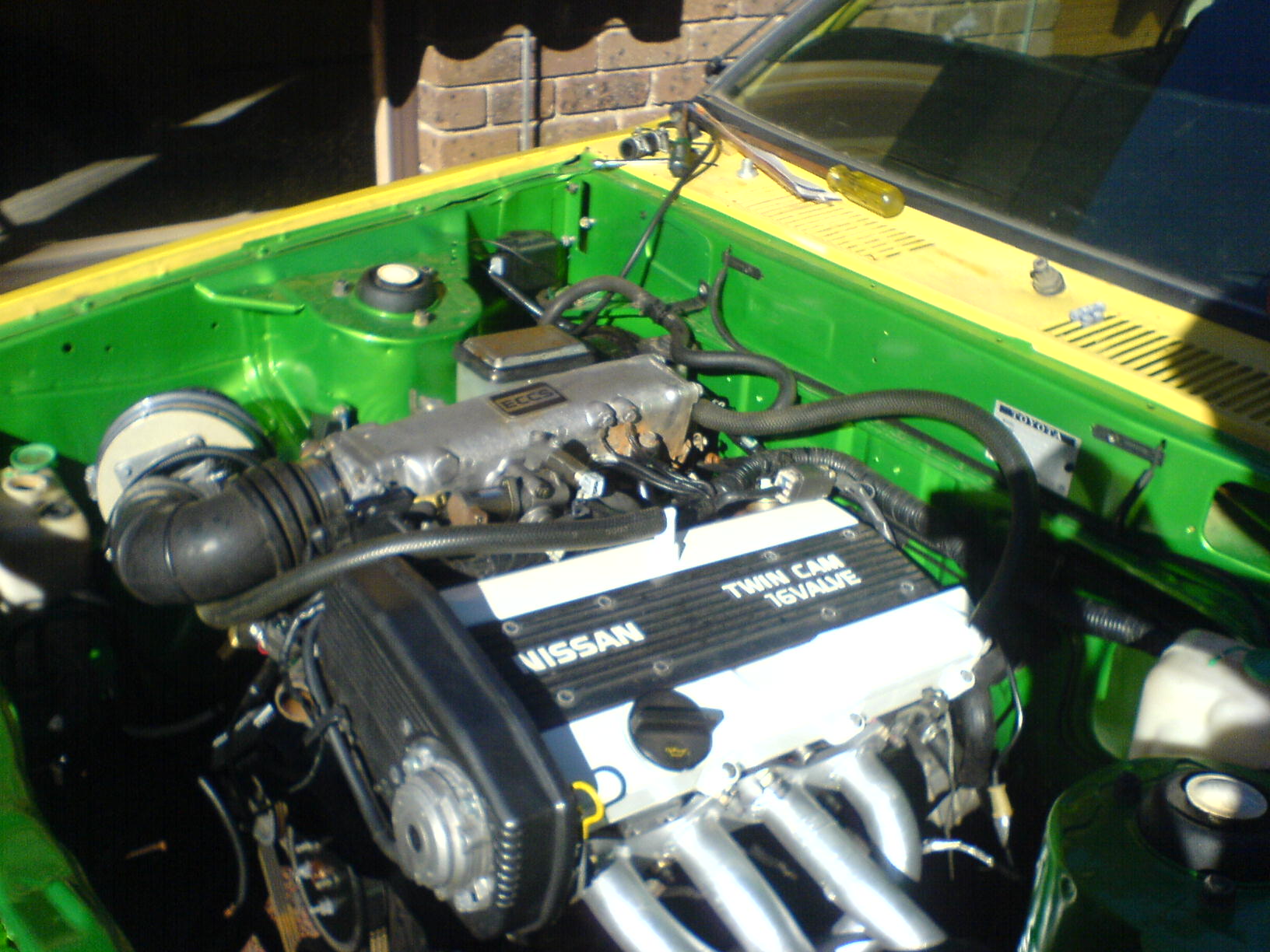

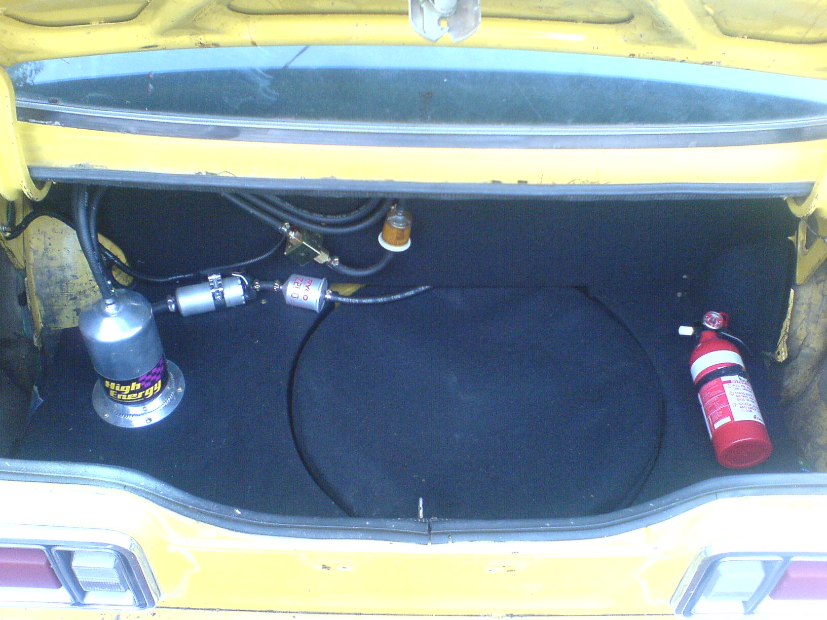

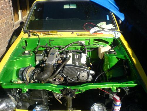

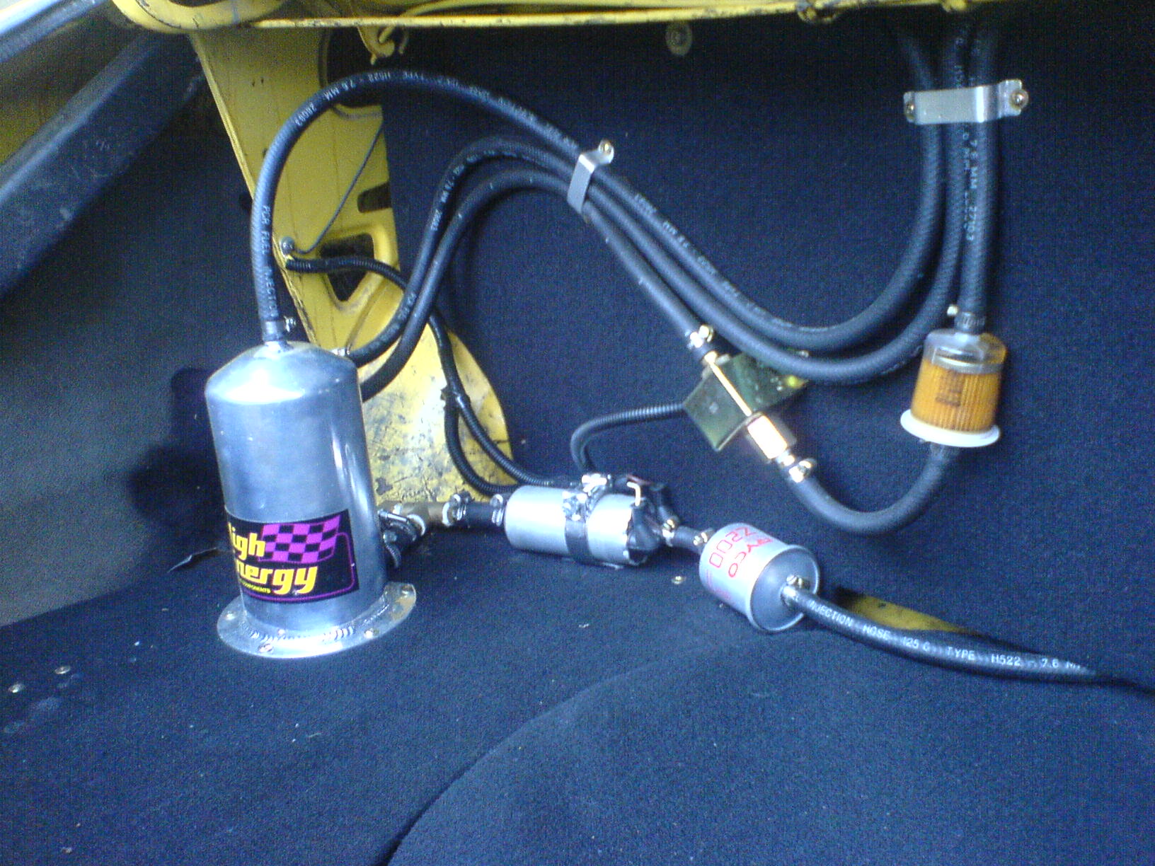

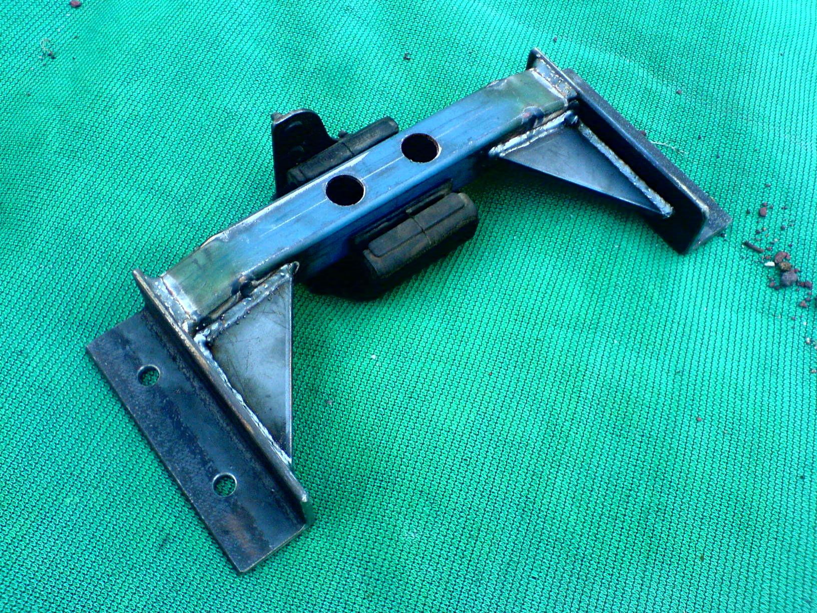

  3. hi guys a lot of you would already know my car or remember it from my conversion thread, but i thought i better do a real rides thread ive got a whats started out as a beaten up old ke55, which i thought was awesome at the time, which had a stolen 3t-c with extractors and 32/36 weber on it it went OK but the t50 was farked and the whole stolen thing put a gigantic spanner in the works, so a mate of mine was doing a ca18det convo on his de powered s13, and i bought everything he didnt need any more for the massive sum on $300 so the stolen motor and shitty box came out to make way for the ca18de (also painted the bay green, i was going to paint the this colour, hok lime time pearl, which the rest is for sale if anyone wants it) gearbox cross member fuel system and boot trimmings were done running xt130 struts, pug rotors and hilux calipers with coil over sleeves things were good for a while once i got engineers and rego, but then started breaking diffs so upgraded to a t series from a ra60, went in nicely, but as it turns out ive got it a little twisted in there, ill be fixing this soon put my chrome lensos off my pulsar on it

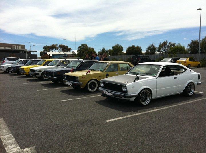

  7. yeah top weekend, cheers for such a great job organizing it a Jarrad and Mel, was epic thanks to everyone for voting for my rolla, pretty happy;) which i also have to thank teddy for for helping me out so much with it paul
  8. how true, i adopted a brother for the week lol

  24. yeah shes in the shade, good thing is cos I'm clumsy so i get as wet as the car, so in turn, stay cool got 80% done today, few things to finish off thru the week and should be painting on saturday. farkn hope the weather comes good, its the only day me and my help have free super psyched for this paul
