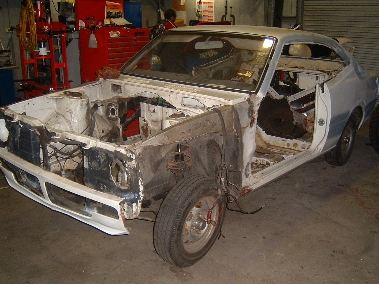

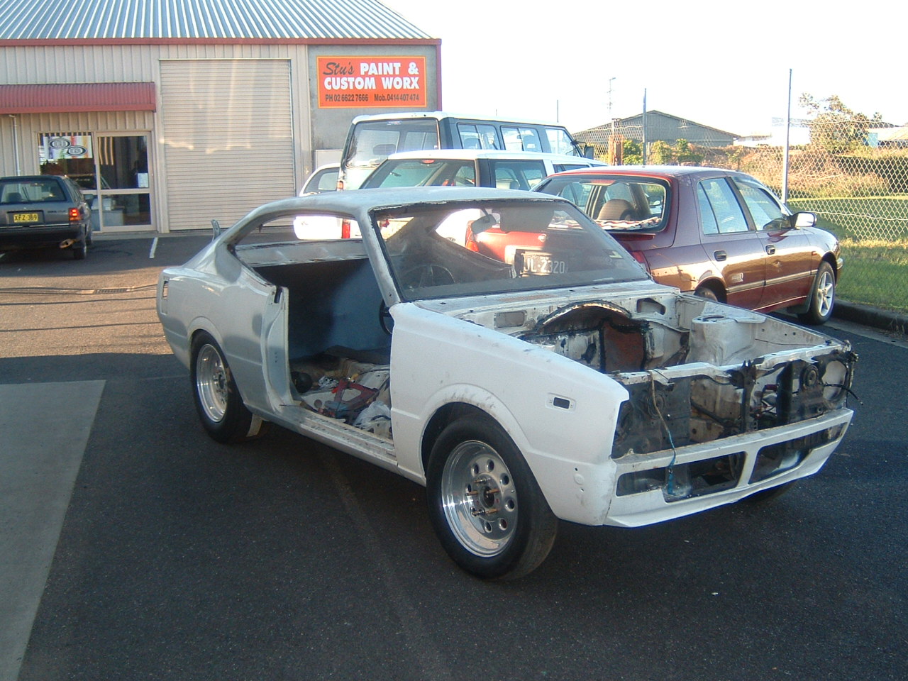

Hey Moot, I used Vb- Vl Commodore Struts,bottom control arms & Z-bar. Cut about 40mm out of bottom control arm & then boxed-braced them. Fitted coil overs to the struts. The Z bar we just straightened 1 end & used original mounting points on chassis.

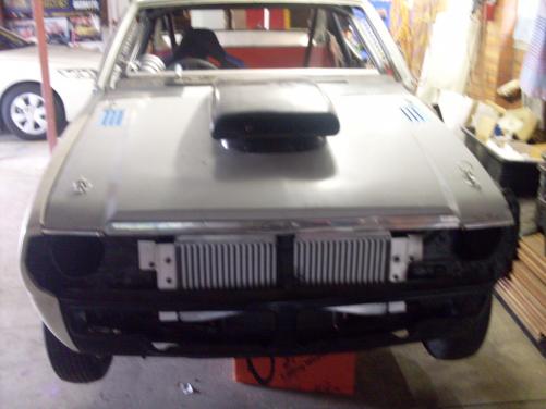

Transmission back in,diff back in on Friday.......... Getting closer....Slowly Have some more pics too....
V6 Chev Ke 35 Corolla Coupe

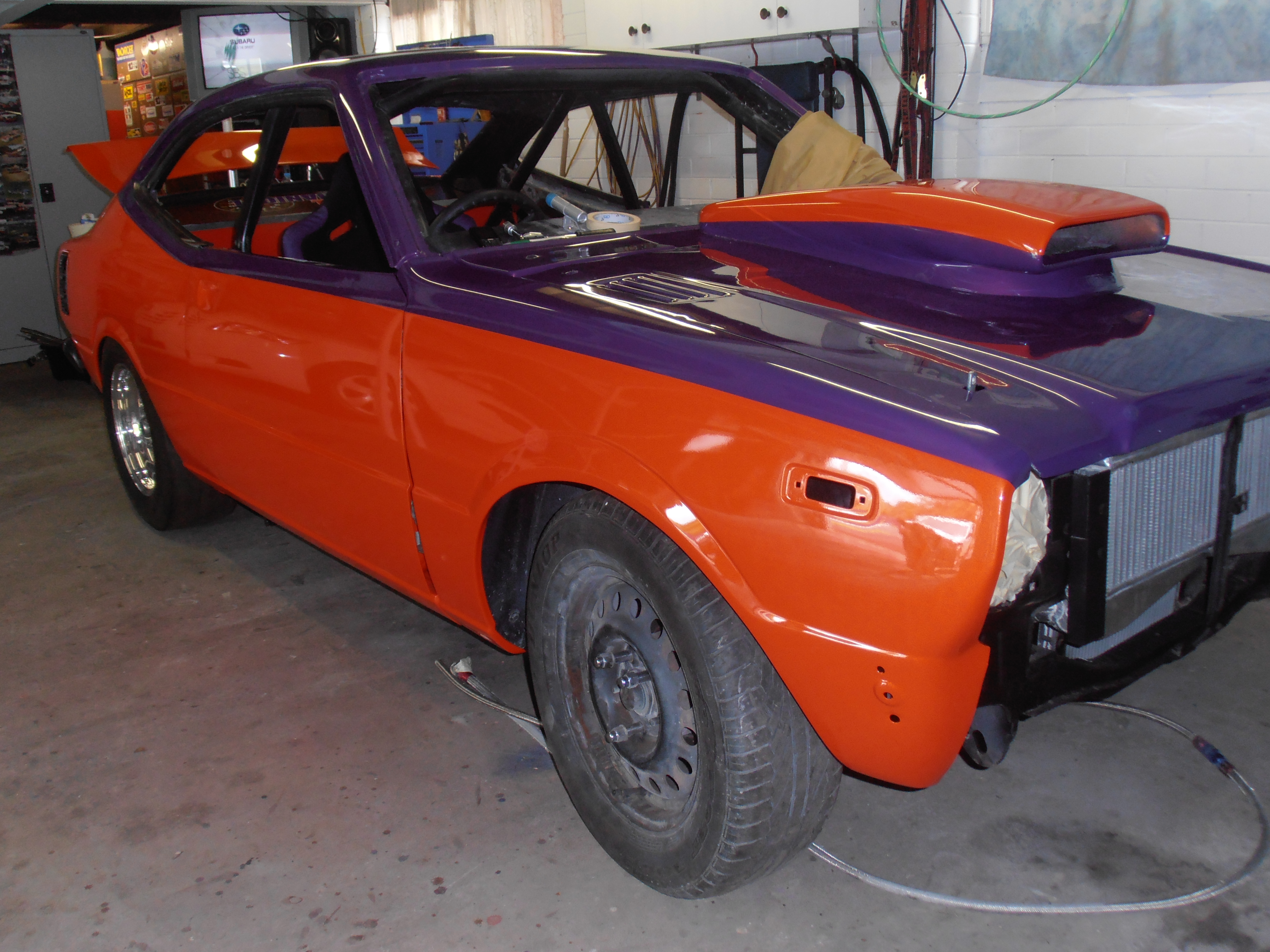

Where do i start....... going very slowly Has sat dorment for a period,Auto shat itself while getting ready to be put on the dyno. Currently Auto getting built (again) then is ready for dyno. Has been running & sounds fairly wild.....hopefully be fully sorted & on the dyno soon. Will update shortly(hopefully with video)

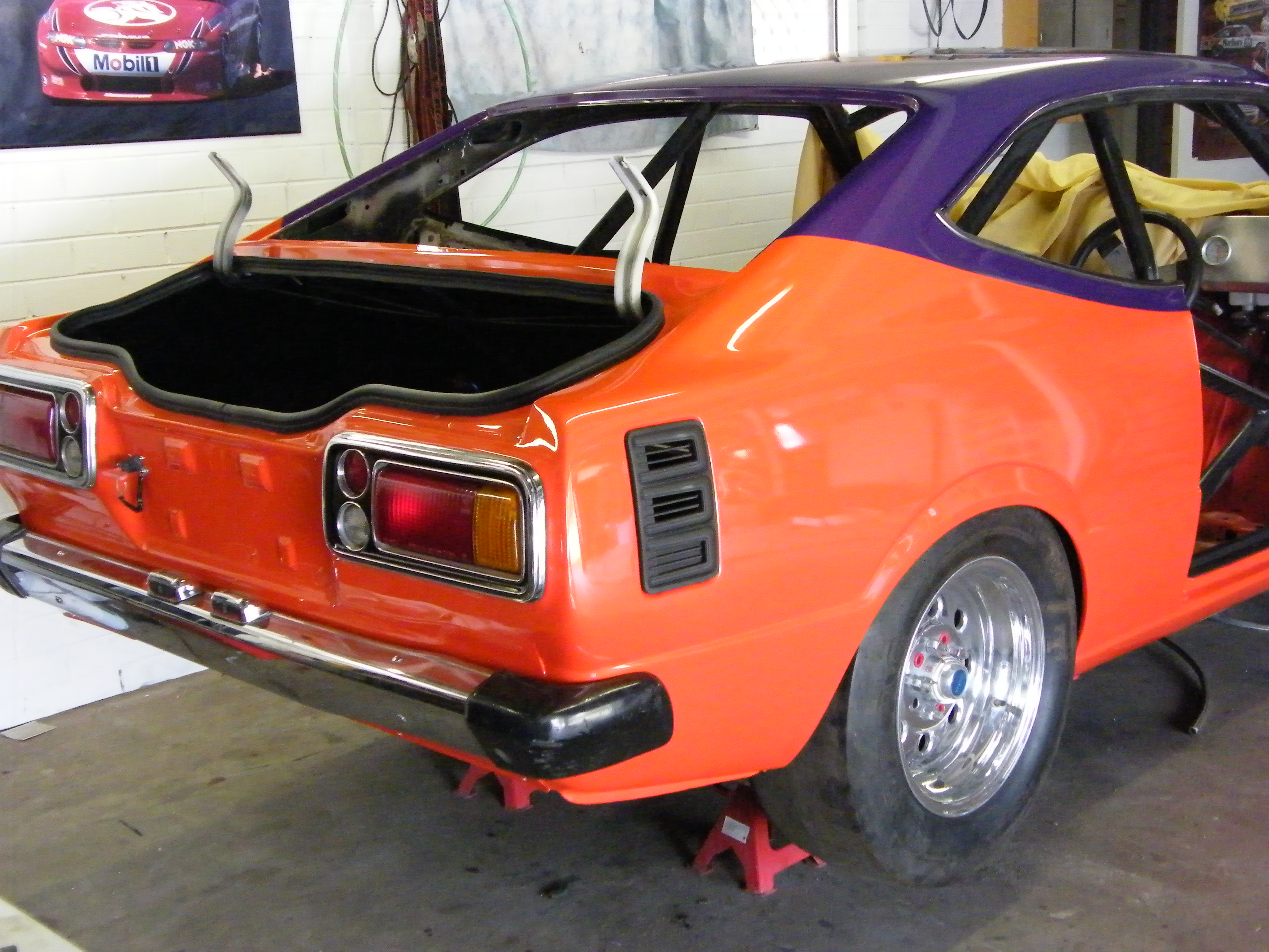

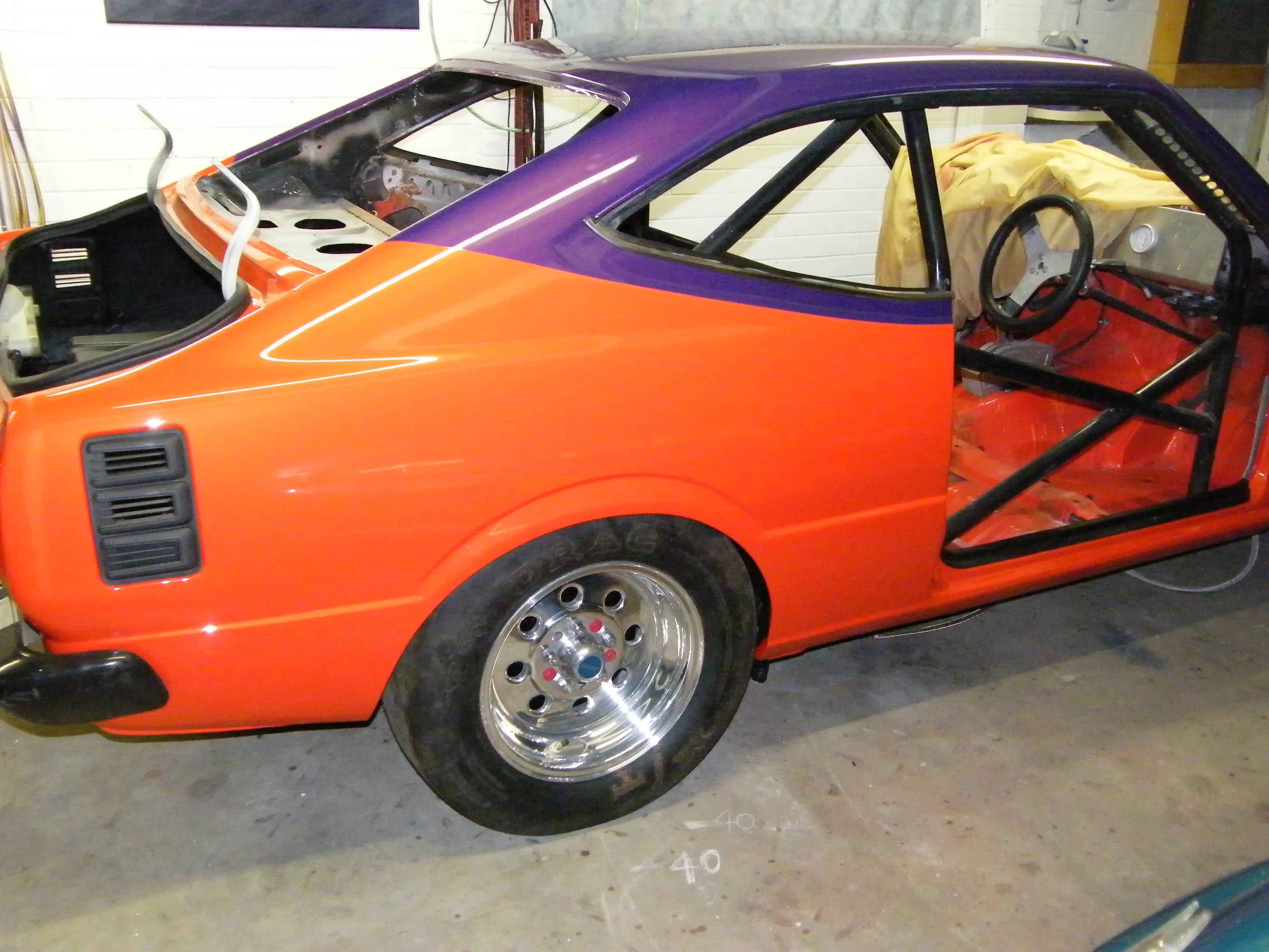

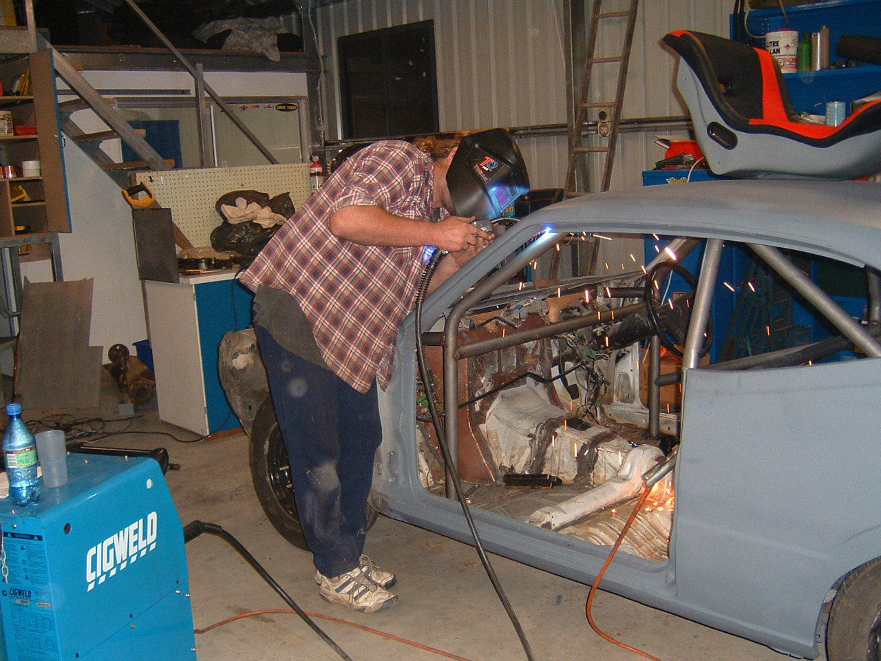

Mini tub into the chassis rails & a little squeeze of the wheeel arches to fit 15x8 tyres

Modified Commodore front struts & bottom arms.

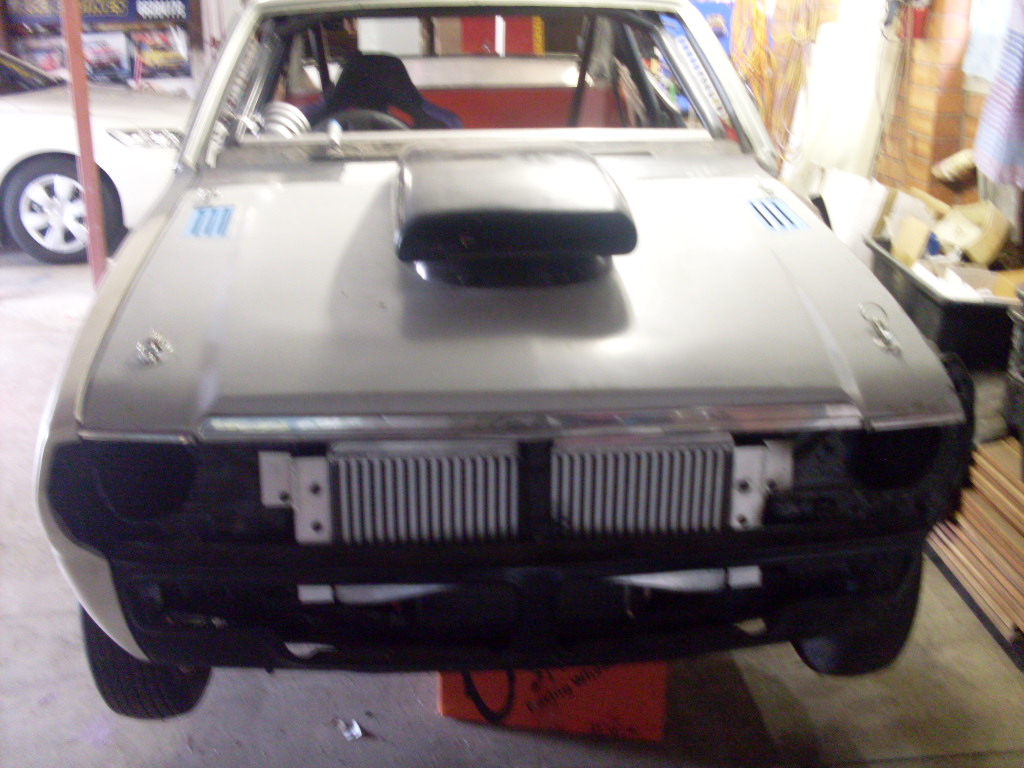

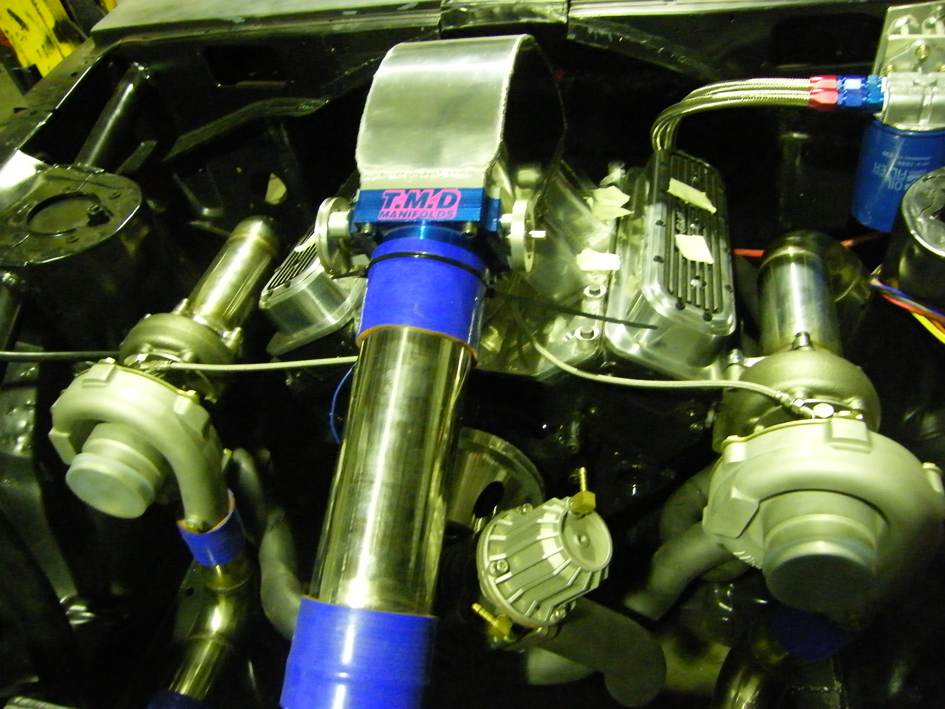

Had to modify firewall(so can't be rego'd) 262 v6 4.3 chev,same bore as a 350 chev(parts are cheap) Drag CAr or maybe some burnout fun
