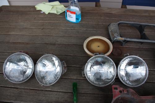

Hahah yea definitely using sert screws... in fact picking some up this weekend! purchased some hiyachi wheels for it! look good for now but may look at importing some more dished ones from japan flares are going on this weekend so then painting will hopefully commence the week after!! And suspension wise I have got some tokico HTS 102f Dampers for the front! And what is a good short stroke shock for the rear of a wagon? also finished the backing for the lights! came up quite good, and are rust proofed now! Cheers lights
ok not much as been happening on my wagon recently... :n: I have purchased coilover spring for my struts and i am going to install tokico hts shocks/dampers with cusco camber plate...i am currently restoring the quad lights as they are the original jdm ones so the casting/back support is a little rusty.and the rear of my car was in a bit of a prang before i purchased which is the main reason on opting for the bolt on flares on the rear... i have been prepping the panels so are all coming along...And also a little hint of what colour the car is going to be!Thanks and the car is coming along ... but slowlyCheers

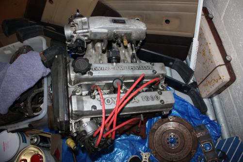

Hey Guys... I have been a watcher for quite some while and have finally decided to document the build of my corolla...(pics up soon). so whats happening... i have made a list: Ke70 wagon Converted to quad light front(from slanty!) Ae86 struts and steering or restore original struts and steering bushings etc... 4age 16valve red top- Individual throttle bodys, 0.8mm head gasket for high compression, reground cams possibly 272s?, Link ecu and fully rebuilt before dropped in! Reset rear leaves, Kings on the front! SSR long champs or SSR meshies for wheels( still need to decide on these) Strut brace Now thats for the mechanical side now for the cosmetic! Rolled/Flared guards, Smooth body work fill all miss perfections etc... Chrome bumpers, Freshly painted in a gun metal grey with blue through it... all in 2pac! I have allmost completed the prep for paint so that should be under way shortly! and I will try get pics up tomorrow, Thanks
