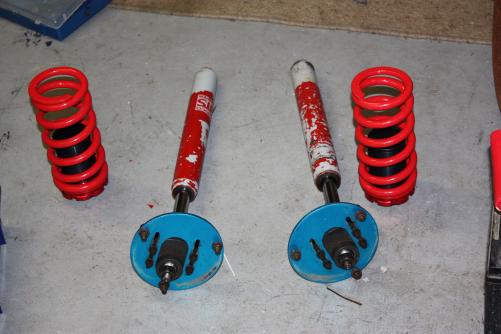

  23. Anyone know? Thanks
  24. no its definitely a 4 door ke70 wagon with a 4k... the original owner could of possibly swapped the struts? even though it was a complete stocker when I purchased... anyway I have added a picture just to show you guys.... Hmm I'm confused... hopefully they are ae86 struts but I really don't know.... Thanks for any help... Cheers
