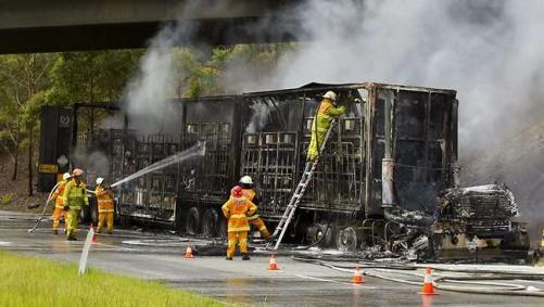

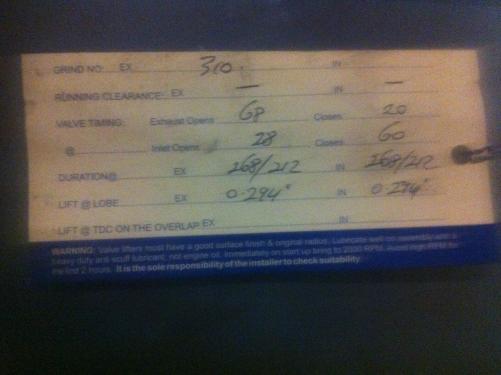

  23. sorry about not making any posts.. completely forgot! engine with the head and cam off :) edit: wrong photo.. but you get the idea whilst taking everything apart.. i somehow managed to break a lifter, so i replaced them all the head ready to go to " aussie heads " and the cam to " tighe cams " baught new carpet for the car, but didnt register the post.. and being a fire fighter i attended an aus post truck fire.. 3 weeks later, my carpet still isnt here.. so I'm thinking it was on the truck picked my cam up on tuesday with the following specs got my head the next day ( wednesday ) acid dipped, polished, and decked now it goes together!
