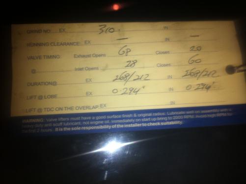

  11. and also, so really.. it dosnt run .423 lift like they say.. so there was really no point in upgrading to hd springs like they say
  12. hmm fair enough, i was just under the impression i would get it done to the exact mentioned specs.. but yeah.
  13. the lift is far smaller though? or am i just reading it wrong? also do they not gring to the specs, just to an " approx " ?
  14. hey all, well i took my 5k cam to tighe, and told them i wanted the tighe 104 grind.. so i drove up there today and picked it up ( i live in nsw ) and just looking at the tag, it has these specs on it? this isnt the grind i asked for, is it?
