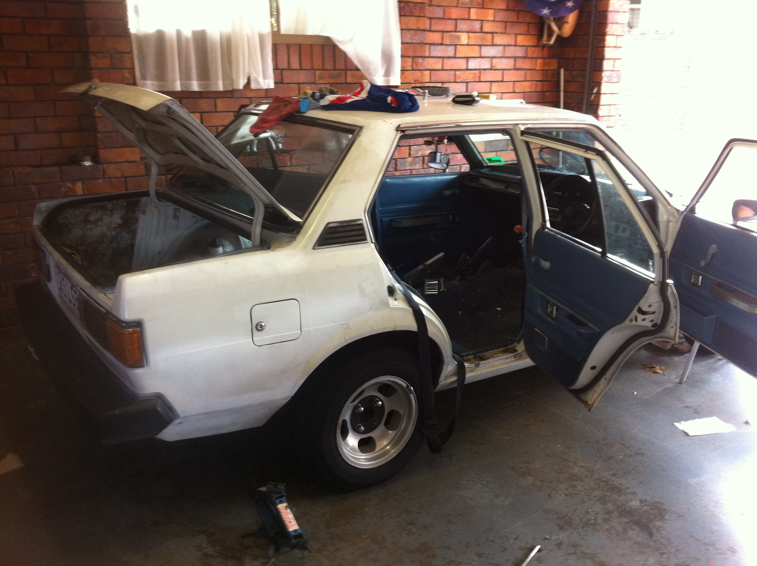

I got this ke70 from brisbane about 2 weeks ago.. and plan to do a bit to it.. so i thought i would do a build thread
first off, its a 1983 model ke70 with a 5k & 5 speed conversion
  • Gt shocks
  • weber carby
  • extractors
  • 2 1/4" exhaust

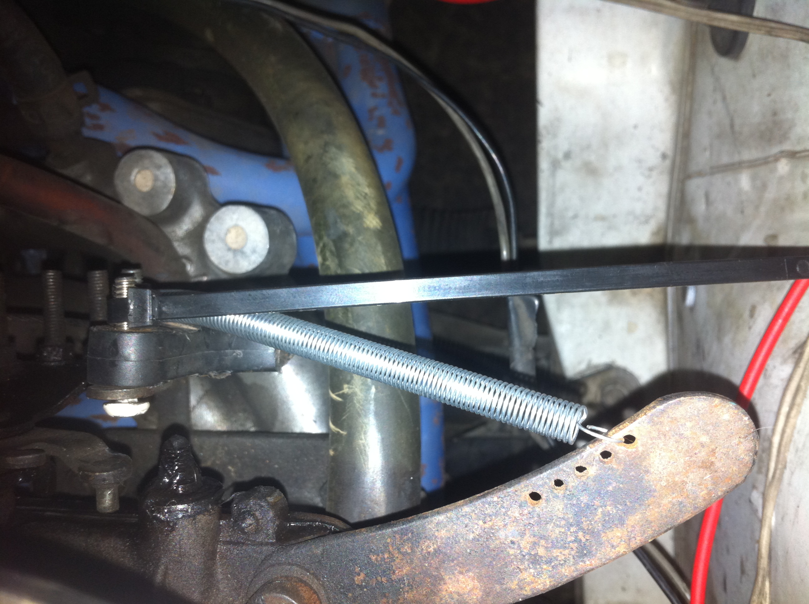

first off, driving it home from brisbane the throttle return spring snapped, so i put a zip tie to hold it in place till i got home

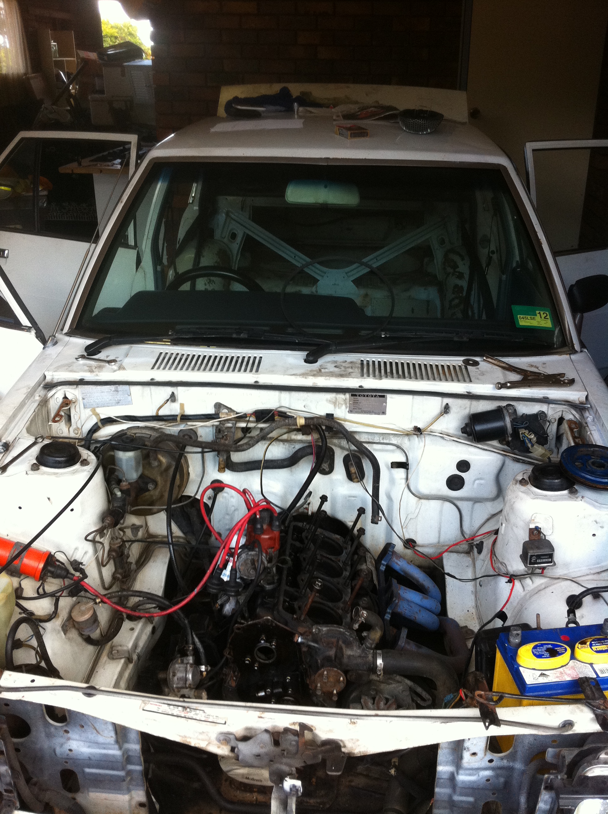

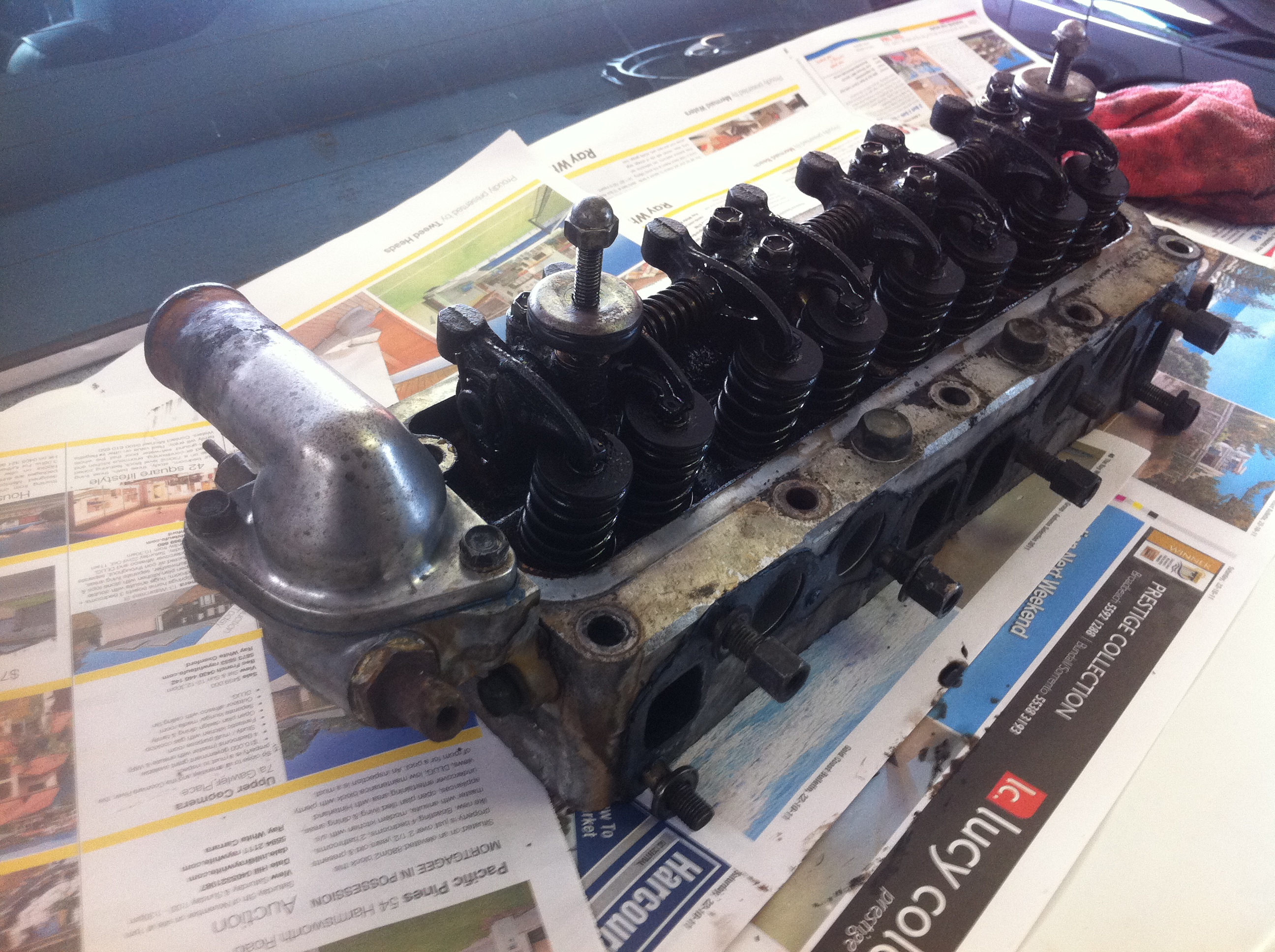

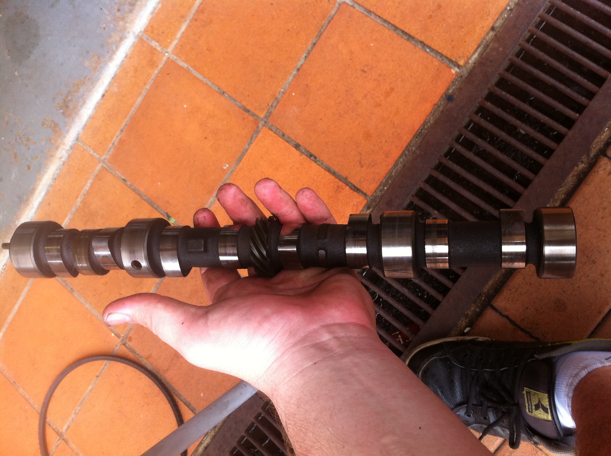

over the past couple days iv pulled the head off, and taken the cam out. i plan to shave & port the head, with new HD valve springs
and the cam i plan to regrind.. i had 25-65 270dur in mind. highway and street driving will be 50/50 but will this cam be to big for street driving, although its a 5k not 4?
and also, i broke one of my lifters trying to pull it out with plyers ( hydro ) i know there's a big debate.. but should i just replace it.. or keep the head off for longer and replace it with a solid conversion?

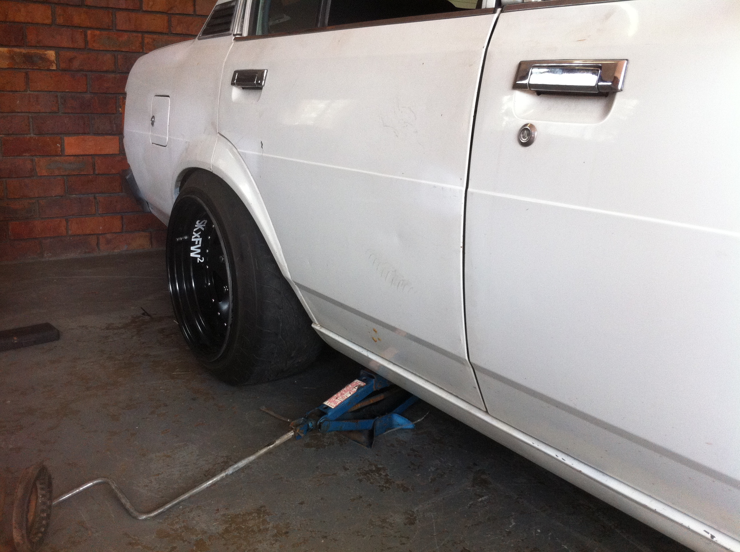

some wheels i tried on :P
the head
the cam

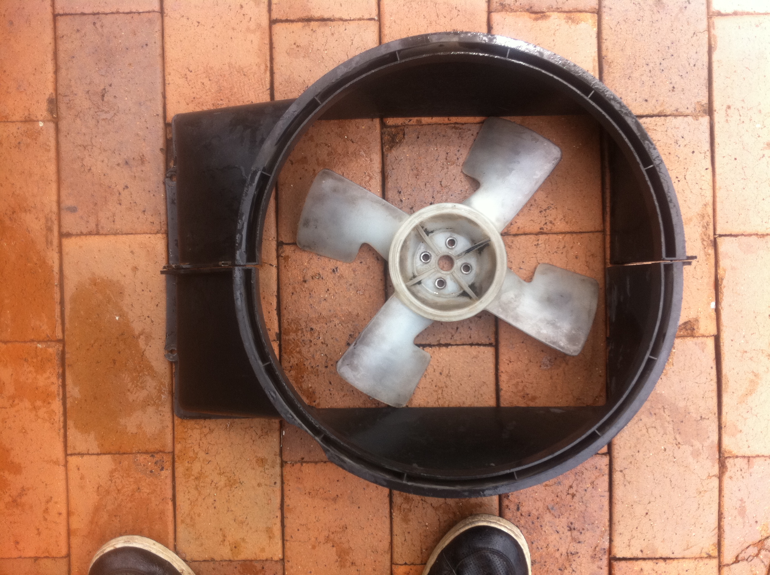

also, i have a cooling fan and shroud forsale, if anyone is interested, shoot me a text: 0432740324
Man those wheels are gangsta , those are the rims from toyparts ? Gona rub like ʞ©$ɟ with out a stiff suspension and gaurd work.
Anyways good starting point ,something about white ke70's!!
yeah they have crazy strech, so they fit perfectly in the guards.. but I'm going to pump my guards more.. just to cover a little more tyre..

And bro with P plates you will get butt raped with those wheels by the Popo. Looks cool though.
yeah i know the stretch is to much, but oh well.. a good looking car isnt legal..

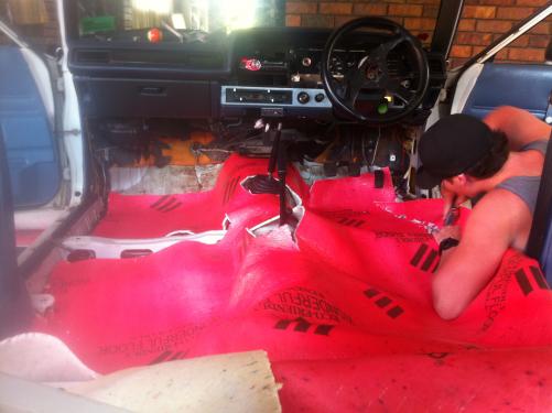

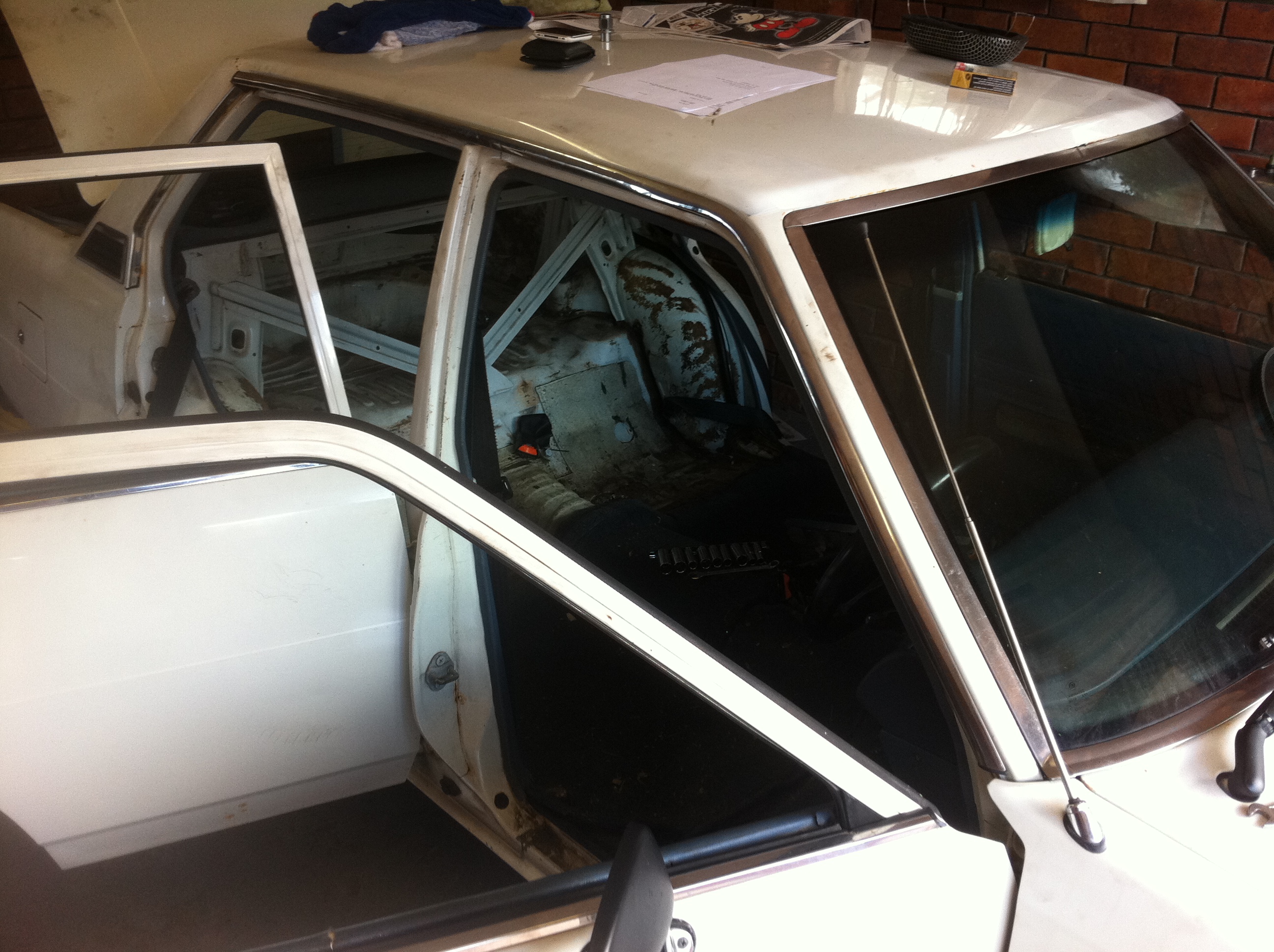

had a mate over today, and spent an hour or so stripping the interior, getting it ready for new carpet, and new bucket seats

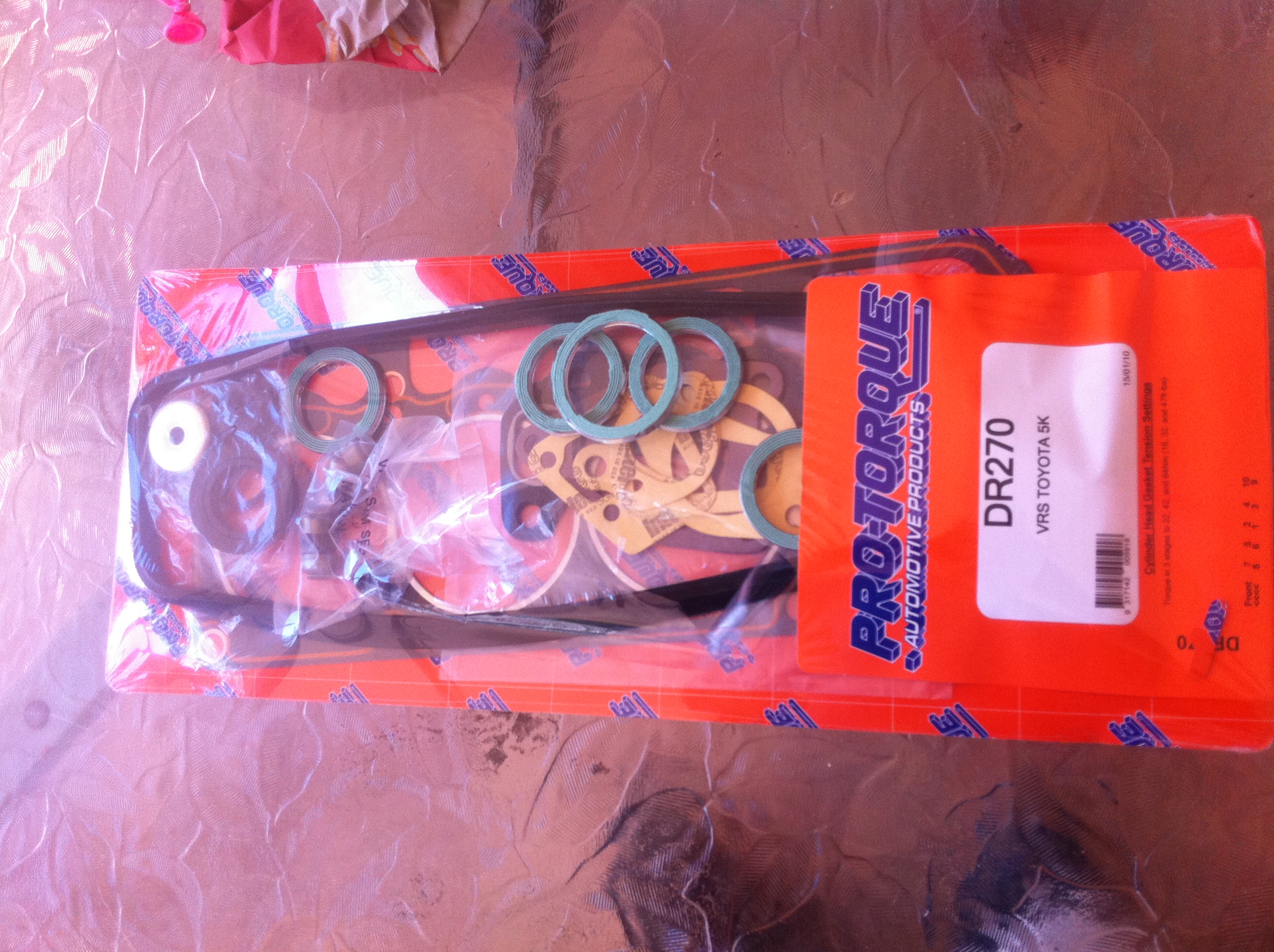

went out and got a new top end gasket kit.. and got some quote's on my engine work..
$150 to shave my head to 10:1 compression
$210 to grind my cam at " tighe " to the specs of: 20-60 260dur with 423 lift
and then $80 for the gasket kit
LOLWHAT?
i paid $50 to get my head shaved to 10:1
and $90 for 270 duration cam and $90 for double valve springs
$210 is ʞ©$ɟing expensive for a cam regrind!
Edited by Evan G

What about the cam grind?
Changes the timing of the valves opening and how far they open to give more power higher up the rev range.
5Ksev- I paid $170 for a cam grind AND the lifter re-grinding at Crow, so you are paying a lot.
Also, decide if you're using hydraulics or solids before you get a cam grind as they are different grinds. Whichever you get you should get the lifters reground to wear in with the new cam profile.
