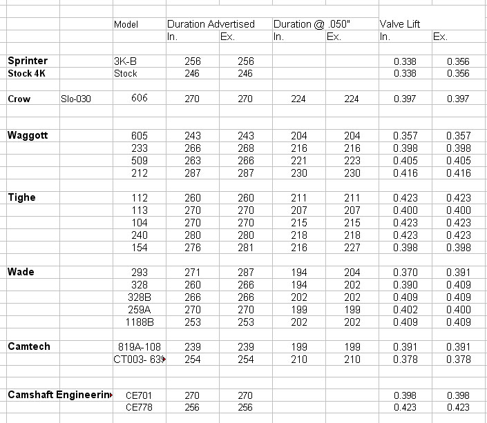

Half a dozen companies do them- I wanted a torquey cam & stock valve springs (0.4" lift) so 270deg was fine, & I ended up going with the Crow grind as they open faster ( The 50thou lift is slightly higher). They all cut much wilder cams than these.
I'm getting the tighe 20-60 260dur .423 lift.. Peak at 6500rpm
As the most common is 25-65 270dur peak @ 7500..
I don't really want to be revving that hard, and itl be shit to drive on the street. So I'm going a tad smaller, as mentioned above..

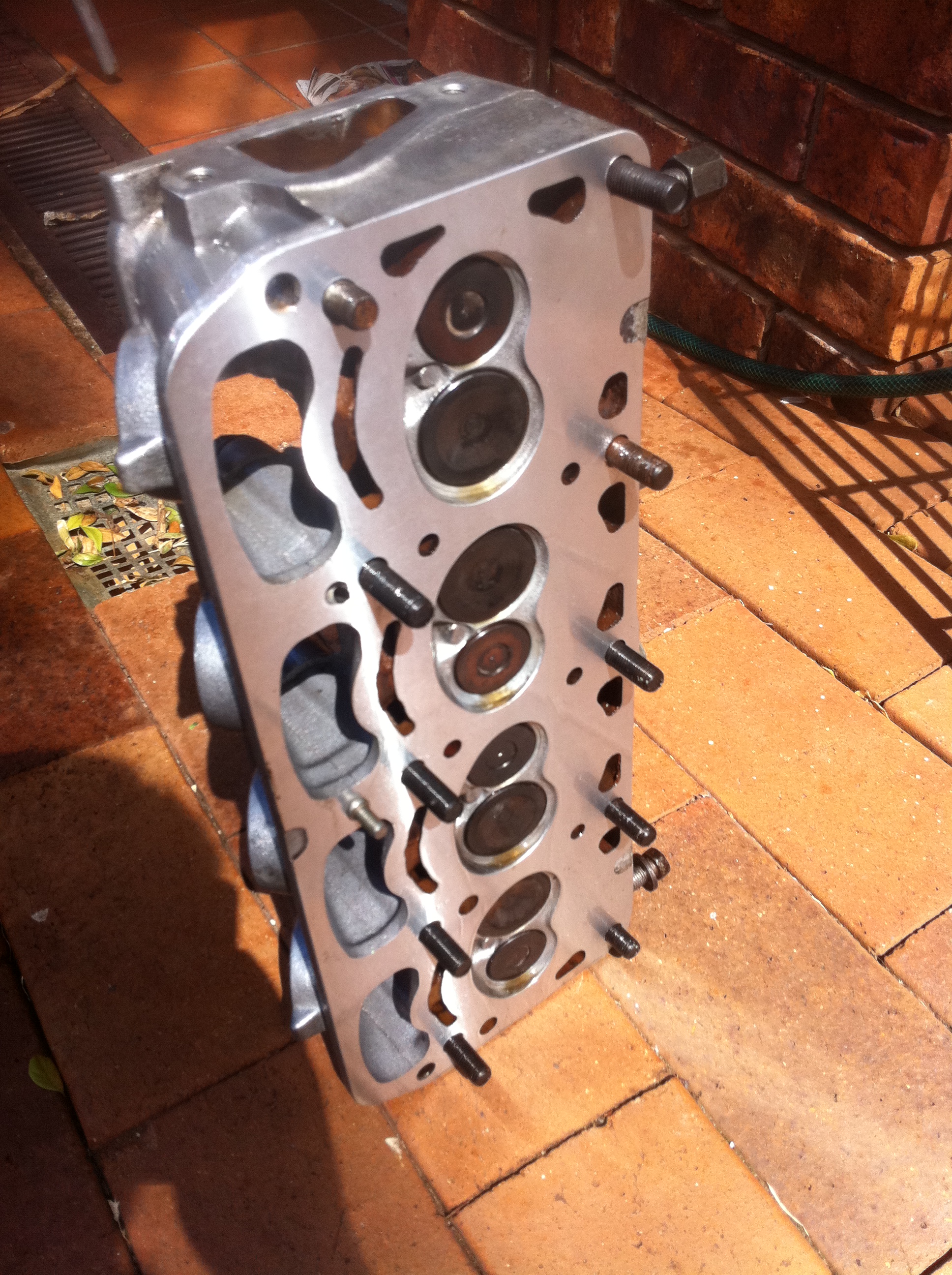

Took the head in today,
acid dipped
decked to 10:1,
Heavy duty valve springs
New valve stem seals
Decarboning my valves.. Picking it up tomorrow :)

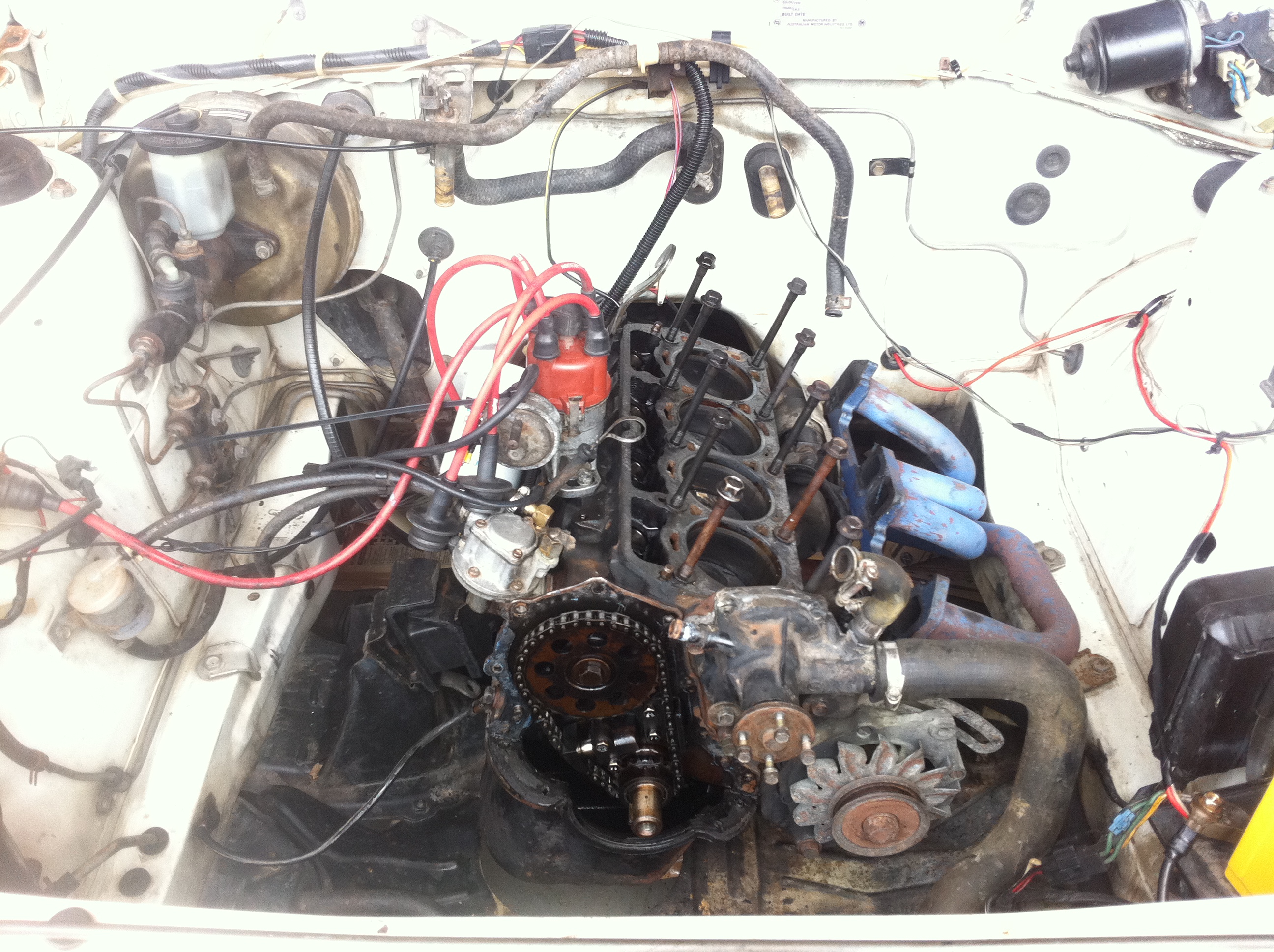

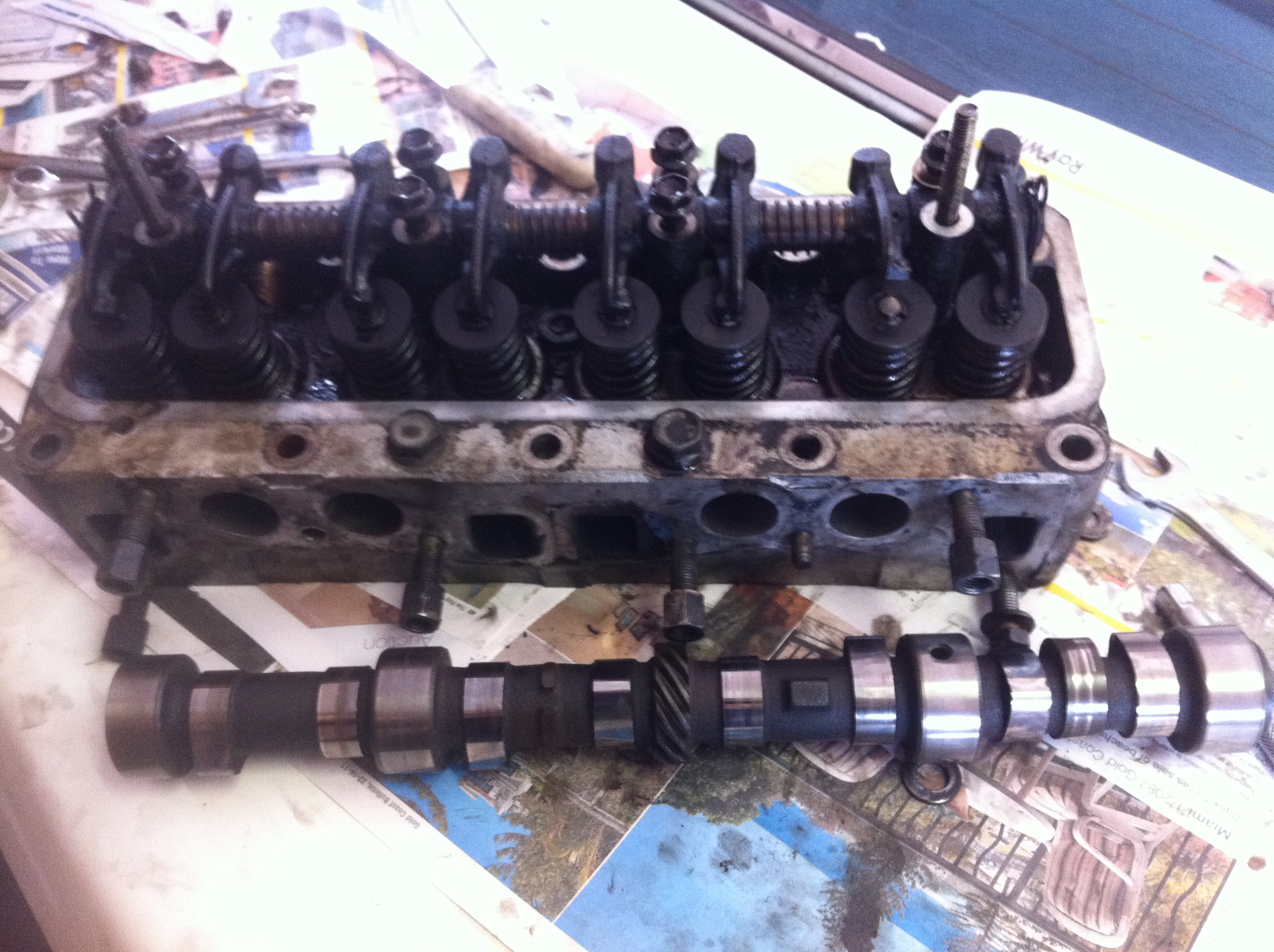

engine with the head and cam off :) edit: wrong photo.. but you get the idea

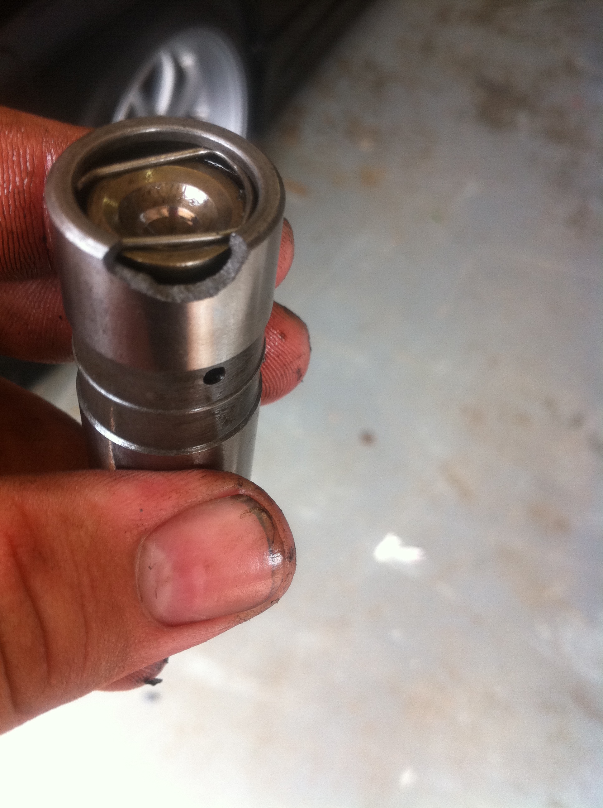

whilst taking everything apart.. i somehow managed to break a lifter, so i replaced them all
the head ready to go to " aussie heads " and the cam to " tighe cams "

got my head the next day ( wednesday ) acid dipped, polished, and decked
now it goes together!

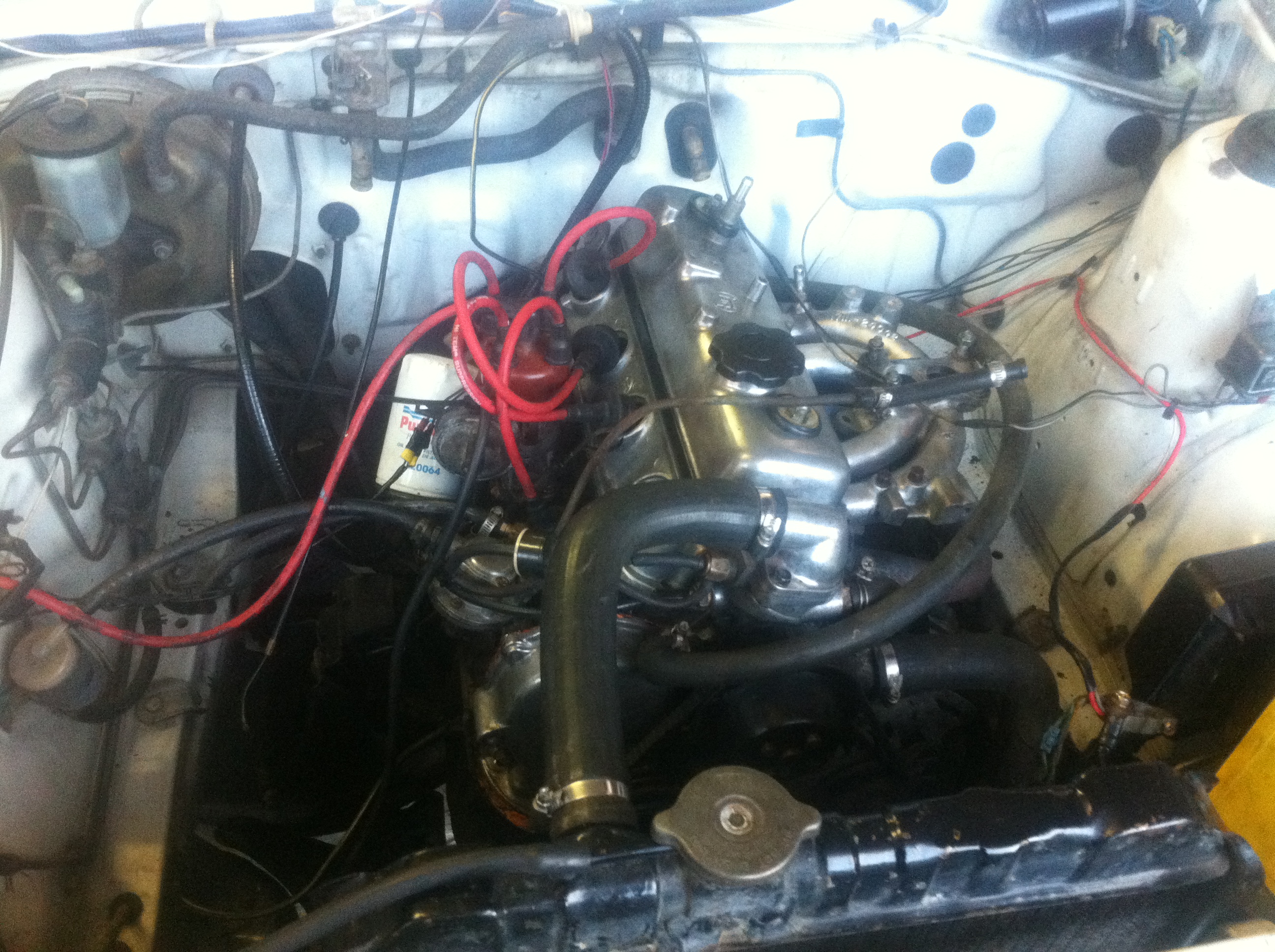

engine went back together! :)
drained the oil out.. and was crazy black,
did a complete oil change, new oil filter, and new spark plugs.. and the v to keep me going :P
video of its first run.. lumpy, but not too lumpy.. ( can't really hear it in the video )
