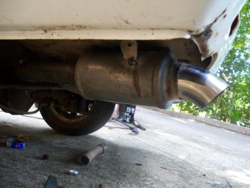

So I finally found the time to finish my exhaust today, and it sounds real nice, has a nice rasp to it at about 3500rpm and onwards but not too loud so hopfully won't attract to much attention.Also fitted my steering wheel but needed to modify the boss kit to fit properly as the self cancel and horn contact did not line up (even tho the ebay seller said it was for a ke70) looks to be off a seca or somthing.
