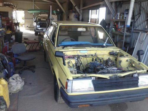

  24. My new daily until the panno is resurrected, not bad for 200 dollars. definatly worth the 200 dollars in the amount of fun you can have in a little shit box like this :y:
