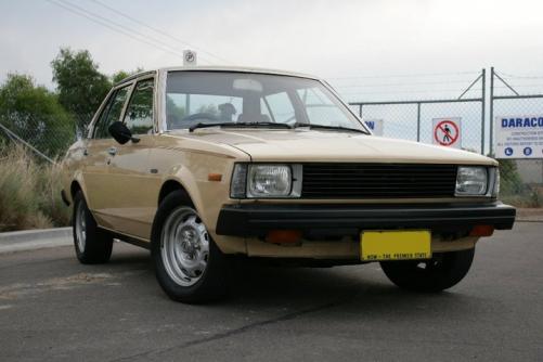

Hey, names Andrew! Been lurking on ke70.com and rollaclub for a while now just now been bothered to post a thread on my keto Had its for around a year and a half now, reason why i bought it was I got a lemon stagea from an importer, got a refund, gave the bank the money back and bought my mates keto from wagga, still got it and love it ^__^ Been slowly adding to it 1983 ke70 4kc originally auto, but was changed before i got a hold of it to a 5 speed. 146,000 original ks. air con has been removed previously. Car was straight until it moved to sydney with me where it has copped car park dents everywhere. :( rust around the petrol cap, thats about it other than some paint chipped surface rust. What i have done Monroe shocks and lowered king spings all around (cheap option for now as there was no oil left in either of the front shocks when i got it) Started with standard H4 kit for the stock lights now has Quad headlights with H4 upgrade and Philips HID xenon 4000k lights Sparco fixed back bucket XXR 16x7 wheels 175/16 for some stretch(mate was selling cheap, needed new tyres anyways) 3kc head ported (goings soon as the valve stem seals are gone) What is going to be done original 4k head has been ported, new valves( and seated) cleaned up, new stem seals etc. twin dellorto sidedraft carbies, mainfold has been ported to the head exedy hd clutch (soon) new starter motor fix rust 4age turbo done day................. now for some pics! When i got it (*after a wash and polish) and now.

G'day, Been a while since ive been on here. Bought myself a ke70 83 5speed man 4k corolla :) mods and parts so far New Shocks all round Lowered King Springs all round New pads and shoes all round. H4 Headlight upgrade Phillips HID Xenon 4000k hi/low beam lights De-badge grille. 3kc head ported conversion Optima Yellow top battery to be done 14 Hotwire Mags new tyres Twin Dellorto DHLA 40 Carbies (waiting to be installed with new fuel pump, reg and throttle cables) and a general tidy up of the motor and box :) Got to take some new photos. heres some older ones.
