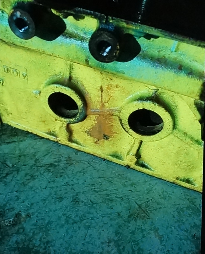

  10. Here is a picture of the crack. The machinist who was about to bore it out saw it and filled it to see if it was a scratch or if it blew out and therefor was a crack - ended up being a crack My 67 Rolla was originally a Tassie Rally car and as such the engine has had a hard time, when we opened it up the 4k head that was on the 5k block was heavily ported out, the block was bored to 20 thou and the engine was running on an 11.1 compression - no wonder the old girl shit herself, she used to go like a bat out of hell though Anyhow I have chased up a new 5k engine. Got a good deal $150 for an engine that was imported in the late 90's with only 30,000 Kms on it- has been sitting in a shed ever since - a nice virgin block - so take 2 for a 40thou bore out, new cam, cleaned up crankshaft, new set of deep curve pistons (I plan on adding turbo in the future so might as well put these in while its open), bigger exhaust, new seals allround, fully balanced, back on with the extractors and an upgraded carby Still after a decent carby for an upgrade from the original asian that was on it if anyone has one floating around.
  11. I have since found out that the block has a crack in it, so I am on the hunt for a new 5k donk as well.
