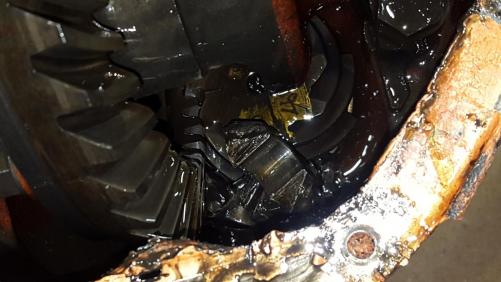

  1. So that play and movement in the spider gears was probably meant to be there then? Haha i just assumed complete lock would be the goal. Although, some of the welds had definately snapped. Ill be replacing it with the hilux diff thats in my parts car once the new motor goes in so i guess its not too much of an issue for now
  2. Alright, not a great deal had been happening until yesterday. I blew the welded diff early last week which was bound to happen sooner or later. After pulling the diff out last night and openning it up it wasnt hard to see why. One of the spider gears went due to no penetration on the welds and slag all over the thing. So got another welded diff off a mate of mine for free, auto diff so its 4.11s instead of 3.9s ???? Openned it up to inspect it, and I'm glad i did because half the welds had snapped and there was a fair amount of play and movement in the spider gears... not any more ???? Just need to give it a good clean out and its ready to go in. Also picked up a few more goodies. Xt130 LCAs Ae86 hubs and p/s arms Bearing kits and new wheel studs. Currently prepping it all for paint as they all looks pretty weathered. Should be getting AJPS tie rod ends this week and rose jointed caster rods. Ill keep you all posted!
