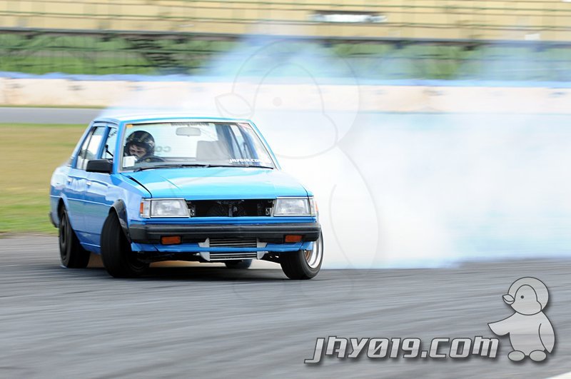

  1. umm theres a vid on you tube from last private day but its not tha best motor was skrewed just put in rb20 ke70 n itll come up. yep firewall recessed 26 cm back! did have it on the road heh heh first copper defected her even tho it was on a race rally permit!! he said to low to wider track and to loud he said and the rests speaks for it self. lol it barely fit in a car park width when it was pulled over quite funny! um shall be out mallala soon the old motor is screwed pushed out 4 litres of oil in one private practise day! shall be installing bigger injectors new forward facing plenum and cooler and be running on E85 :dance: lol i got no power steering n its a fair old handful.. fair to say after a days driftin I'm fair skrewed :bash: but thats the fun of it!!
  2. Hi all don't come on here much but thought id flip up a few pics of my ol dunger ke70 with rb20 in it.. conversion was done in my shed all by me. it runs 250KW at the wheels (roughly 400hp at flywheel) has a custom highmount gt2871r turbo (18psi) and 50mm external gate with screamer :dance: 3 inch stainless straight thru pipe with custom flutes apexi fmic cooler rb20 turbo 5 speed custom hardie spicer 1 piece tailshaft r31 spooled diff non shortened with welded on ke70 diff mounts and custom pan hard rod and swaybar. 8kg front custom ae86 coilovers 5kg trd springs in rear front lca blocks 50mm 25mm steering spacers each side recaro seats willians harnesses nardio wheel twin fuel pumps with surge walbro 600hp and a bosch 910 r32 gtr fuel lines hks cam gears and rb20 redtop cams um nethin else just ask ill reply as soon as i can. Cheers YA'LL
  3. go rb20 if anything! have to chop firewall but they fly mine has 246kw at the bags!!
  4. just wanted to do something different than everyone else... plus has 246kw at wheels and can sit on limiter all day n lovers it ova n ova haha!! :-P
