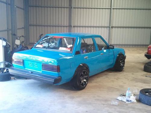

  1. umm theres a vid on you tube from last private day but its not tha best motor was skrewed just put in rb20 ke70 n itll come up. yep firewall recessed 26 cm back! did have it on the road heh heh first copper defected her even tho it was on a race rally permit!! he said to low to wider track and to loud he said and the rests speaks for it self. lol it barely fit in a car park width when it was pulled over quite funny! um shall be out mallala soon the old motor is screwed pushed out 4 litres of oil in one private practise day! shall be installing bigger injectors new forward facing plenum and cooler and be running on E85 :dance: lol i got no power steering n its a fair old handful.. fair to say after a days driftin I'm fair skrewed :bash: but thats the fun of it!!

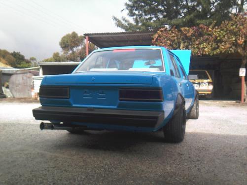

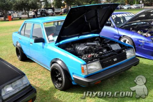

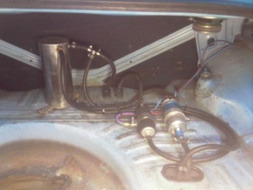

  2. Hi all don't come on here much but thought id flip up a few pics of my ol dunger ke70 with rb20 in it.. conversion was done in my shed all by me. it runs 250KW at the wheels (roughly 400hp at flywheel) has a custom highmount gt2871r turbo (18psi) and 50mm external gate with screamer :dance: 3 inch stainless straight thru pipe with custom flutes apexi fmic cooler rb20 turbo 5 speed custom hardie spicer 1 piece tailshaft r31 spooled diff non shortened with welded on ke70 diff mounts and custom pan hard rod and swaybar. 8kg front custom ae86 coilovers 5kg trd springs in rear front lca blocks 50mm 25mm steering spacers each side recaro seats willians harnesses nardio wheel twin fuel pumps with surge walbro 600hp and a bosch 910 r32 gtr fuel lines hks cam gears and rb20 redtop cams um nethin else just ask ill reply as soon as i can. Cheers YA'LL

  8. yeah its a real tight squeeze i cut a lot of the firewall out and the motor sits back roughly 250mm under tha dash.

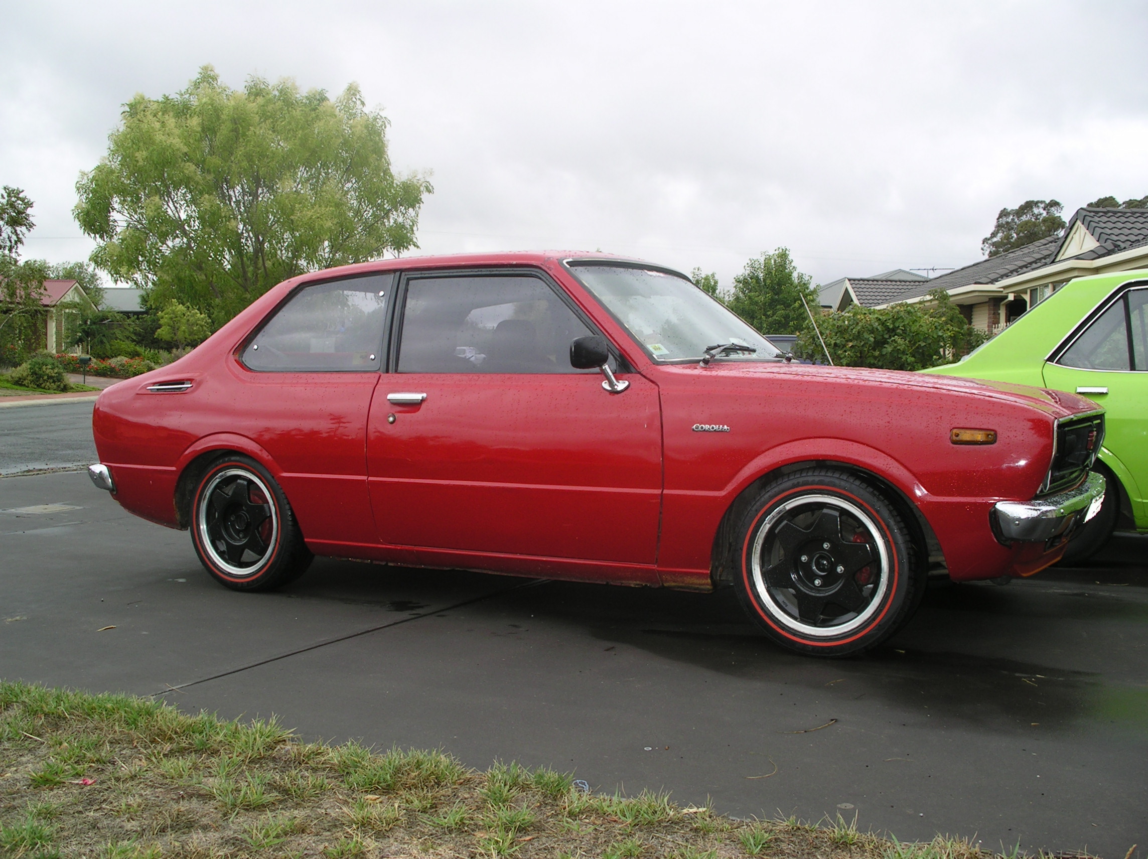

  12. i put my vaccum line for the brakes back onto the manifold and the brakes seem to be working fine. Got a photo of ma car so ill put it on :jamie:

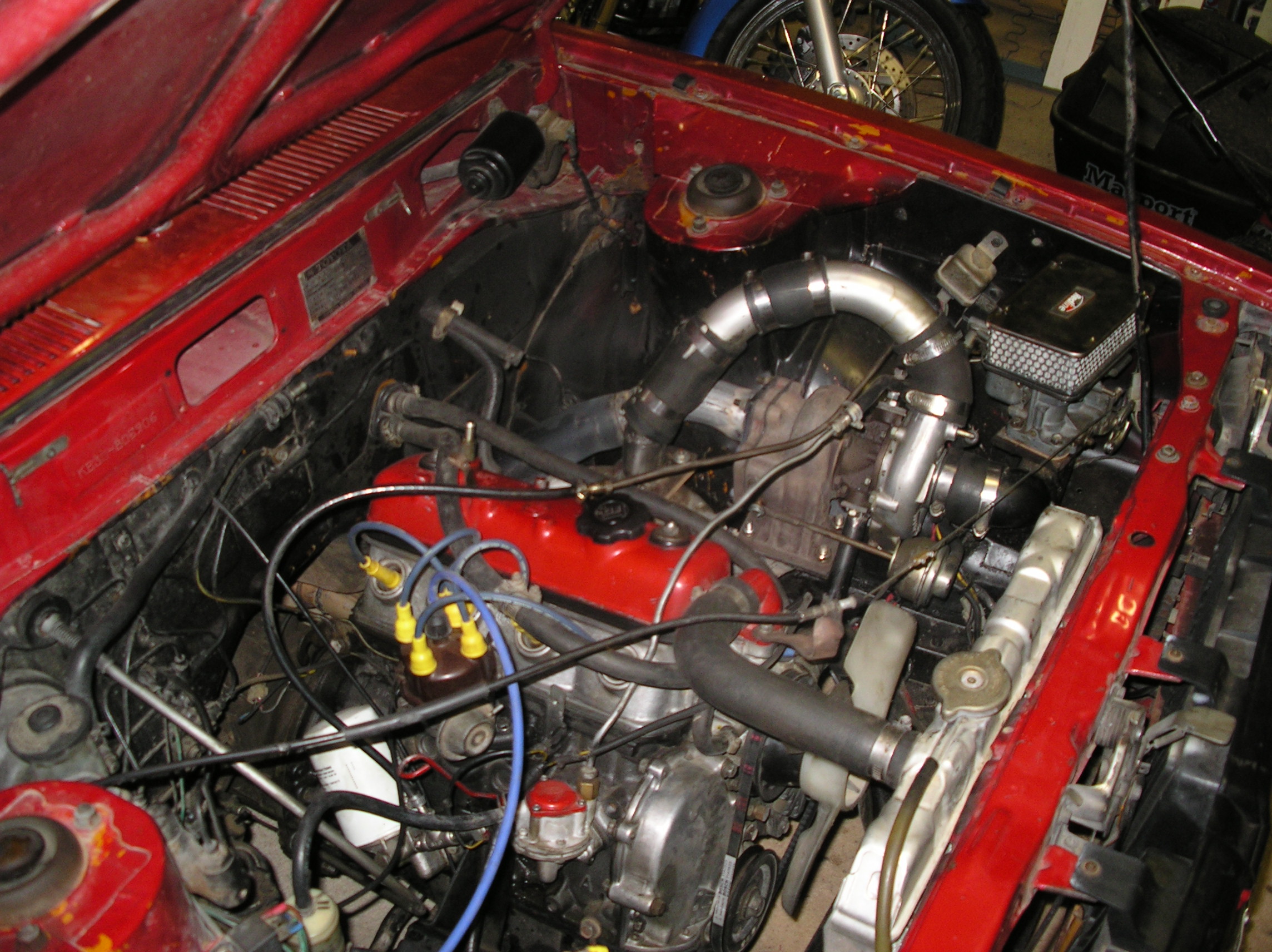

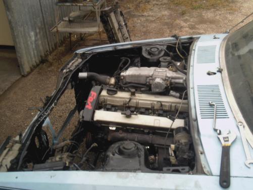

  18. ok thanks that looks like a good S/C set up you have there has any one used a 1 3/4 SU?? here is my engine bay ill see if the picture uploads
  19. Hi I'm from south australia and am new to all this so sorry if I'm stuffin up your boards lol :) . i have a 2 door 1975 ke30 corolla that i have just completed a draw through turbo set up on. i have locked the distributor and set it at around 17- 18 degrees. i am using a turbo from a 12a rotary running around 5-6 psi (soon to be 8- 10 psi) and a 32/36 webber running 98 octane fuel. i have found the webber to be really rich and i have down jetted it by putting a 175 in the primarys and a 145 in the secondrys but is still really rich. i was wondering who else on here has done a draw through set up on a 4k-c and what carby and settings they used or would advise When i figure all this out soon ill put up some photos of my car and engine
