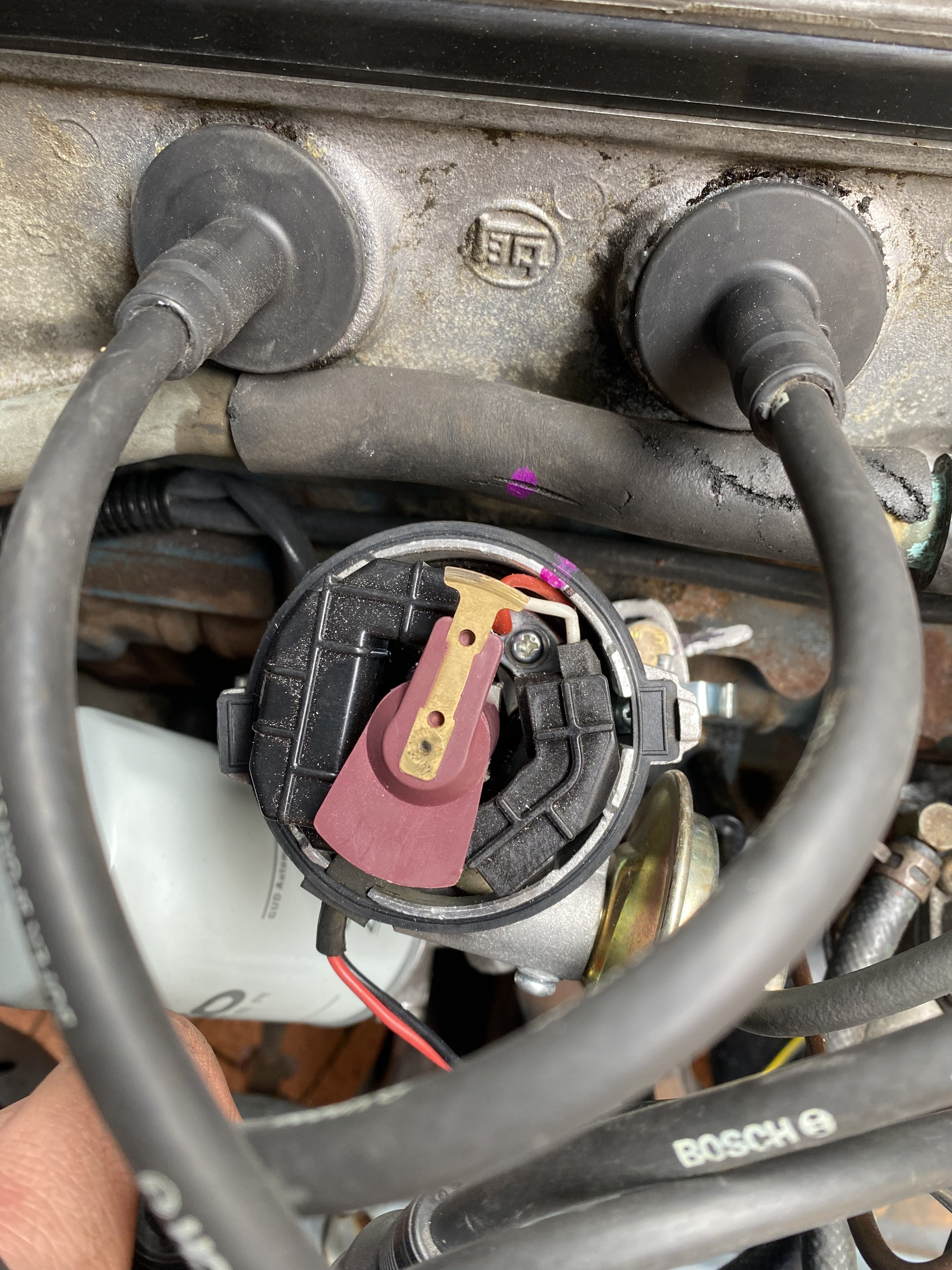

  4. So if I got this right that red dot on the dizzy should be on the other side (left hand side) of the brass arc and that will be a lot closer timing? Then you think grab the timing light from there and check to see what it does

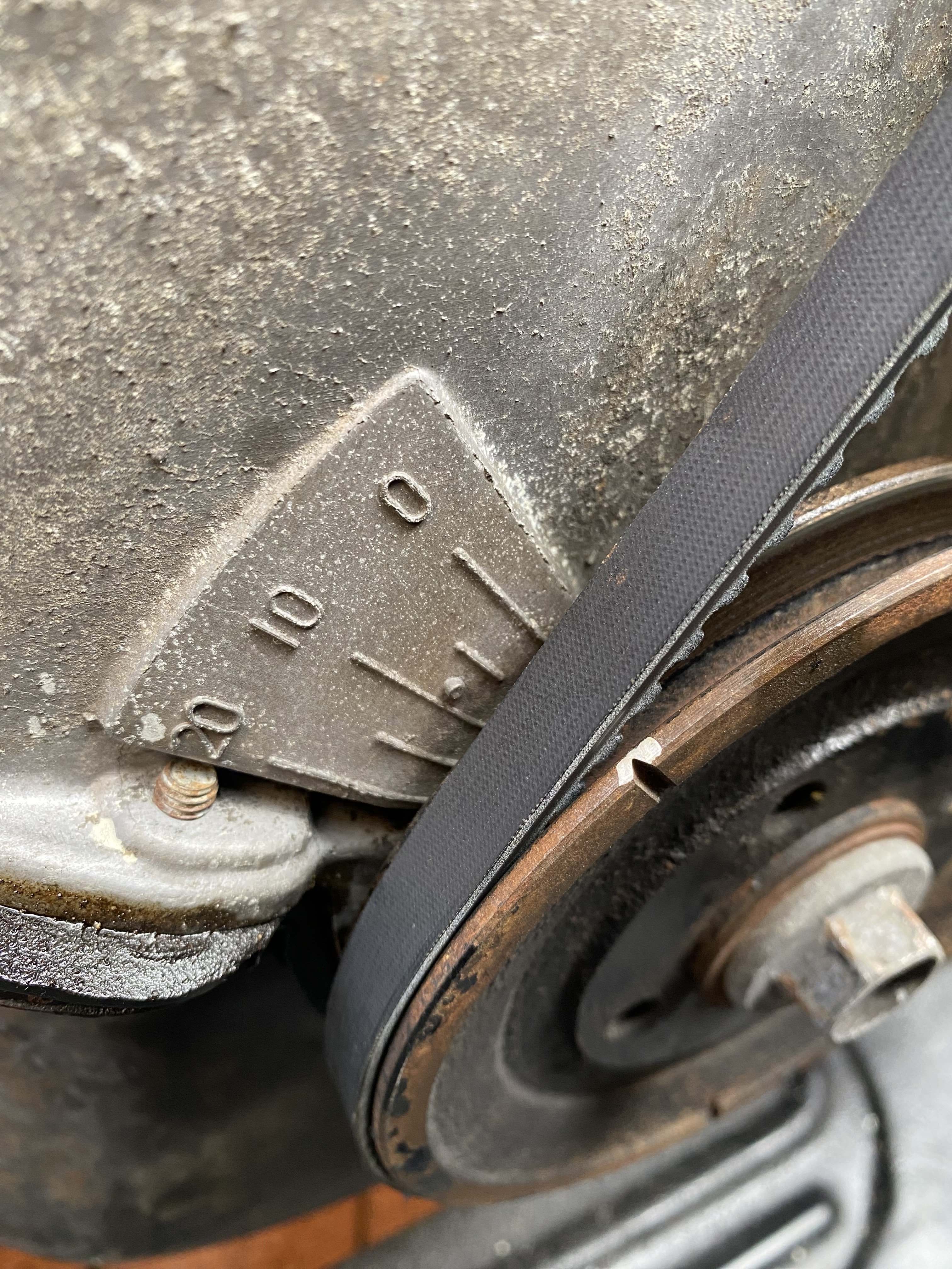

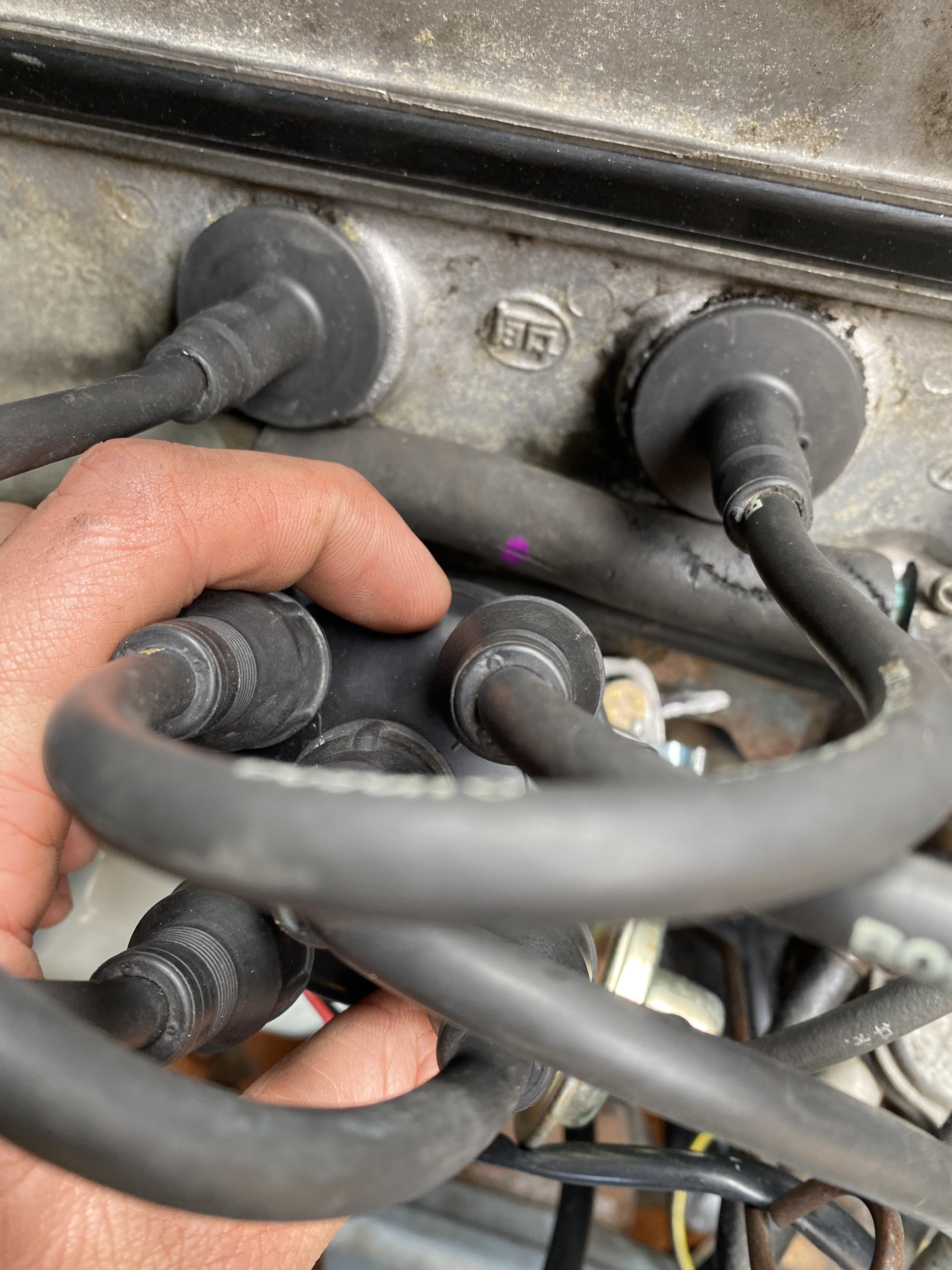

  5. Alright I have had a brief moment to mess around with everything I found a vacuums line unpluged and have plugged that back in that was for the vac adv on the dizzy did not fix issue I think it’s slightly better but that could be placebo. i replaced the fule filter quickly that was filthy so that should help me a bit now I have lined up the timing marks like you all suggested onto 0 deg taken my dizzy cap of taken a photo and then put it back on taken another photo so you can see where the top of my finger is is about the middle of that brass arc when it is at 0 deg. So it just misses the number one lead at 0 deg i haven’t had time to get a timing light yet as I fly out again tomorrow but from what I can see there it is a little out still am I right in saying this? also the rotor turns to the left (anticlockwise) when the engine is rotated clockwise so does that mean turning the dizzy clockwise will advance it and turning it anticlockwise will retard it. the more I look at it and think about it the more I am led to believe that it has been installed a tooth out so is it as simple as pulling it out rotating it a tooth in a direction then putting it back in? anyway please let me know your thoughts and what I am doing wrong or some other things I should try cheers

  8. Paid bang on the 10k mark was pretty happy with it no major rust or anything very clean car overall interior in near perfect condition to one small rip in carpet and a small crack in one of the door cards. i do not have a timing light so I was using the pull the top of the dizzy off method and lining it the first striker up with 10 degrees so turning the dizzy to the right advances it it is currently sitting all the way right atm so something is not quite right because lining it up with 10 degrees is all the way in the left position but yes next step for me was to check the fule filter ect is not blocked and fule pump is pumping with nice flow then go onto checking the float and the keys ect however not really sure what I’m looking at tbh so any help is appreciated
