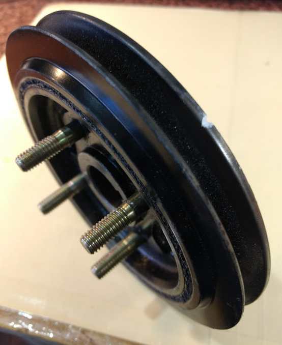

The only advice I can suggest, is to completely clean around the timing marks on the timing chain cover, & the little "V" groove in the crankshaft pully, on the rear edge.  Paint the grove with a little white paint of "White Out".  The crankshaft pulley, can only be fitted in one position, as it has a single keyway.
The only potential problem with the timing marks are; if some one has swapped a 3K or 4K crankshaft pulley, for one from a 5K engine, which has it's timing indent, is a different position; as are the timing marks on the 5K timing chain cover.
