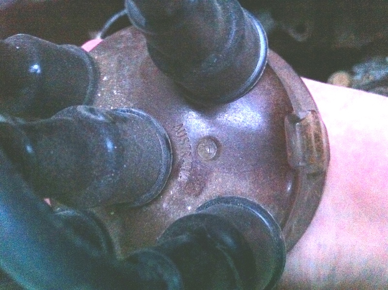

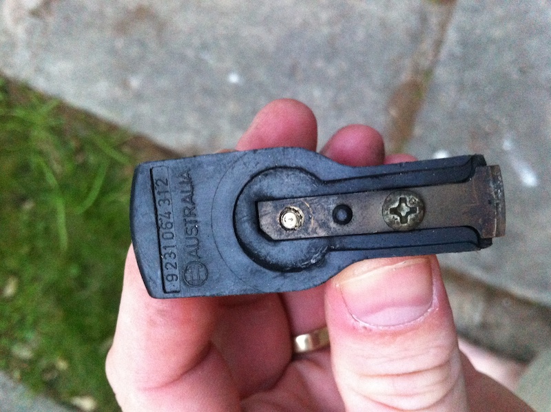

  1. Hi All, I was looking at doing an electronic distributor conversion for my ke10 (4K motor). Was looking at the pertronix electronic ignition. I've had a look and I am not sure what dizzy I have on the car. The only markings on the dizzy are "Australian" see pics attached
