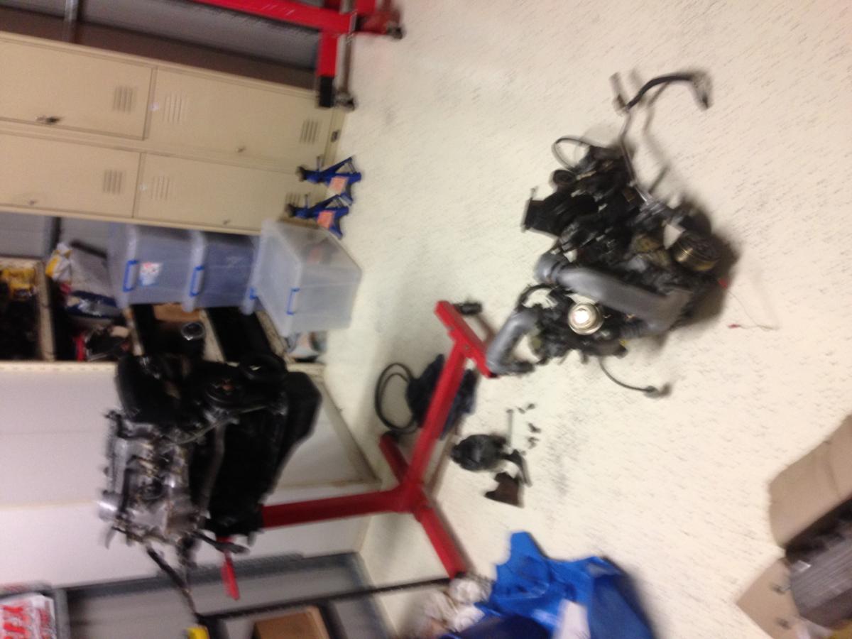

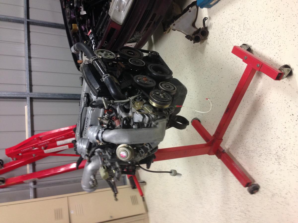

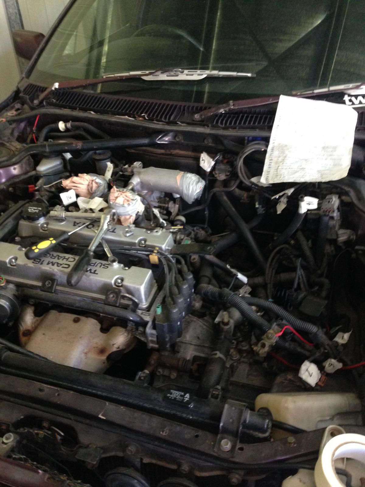

  2. Quick update. Not as much progress as hoped but progress is progress... Gearbox off and on stand (after removing and wrapping other GZE rebuild block) and some of the extra 'rubbish' removed ;) anyone got any suggestions for intake mani? I got one to cut and shut but seriously considering MRP job

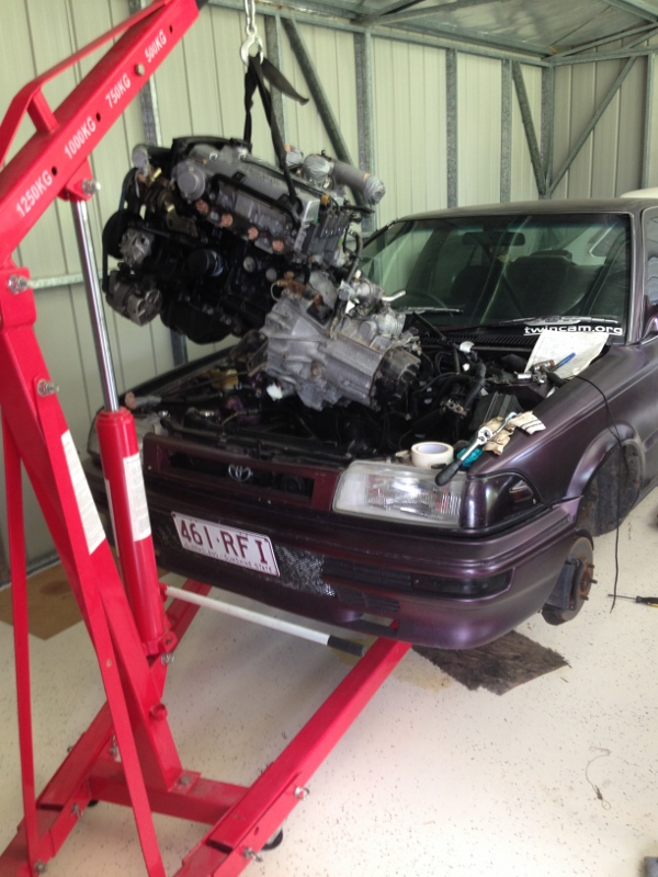

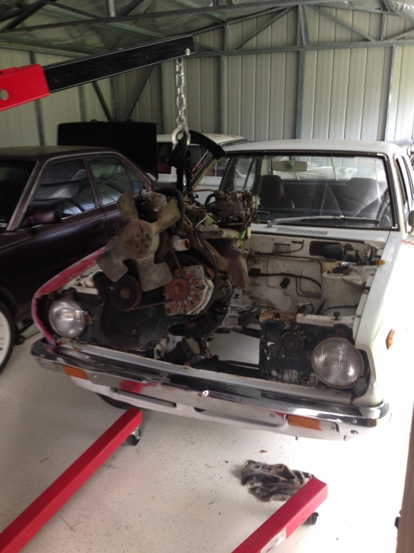

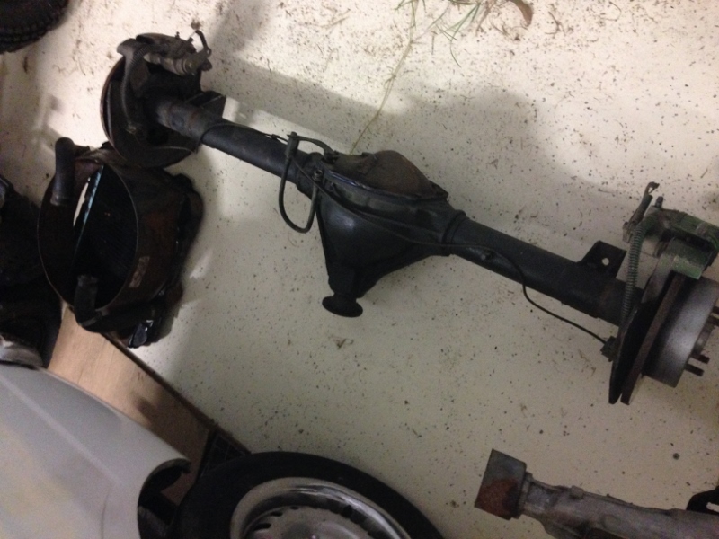

  4. So I decided I wasn't busy enough and needed to pull my ceiling down and replace my kitchen... now of all times ... Anyhow I did score myself an R31 LSD thanks to 'oh what a Nissan feeling!' the other day. Plus today, leave started and we sent the kids to daycare so I managed to lift the GZE and the 3K. Hoping for some more Christmas progress.

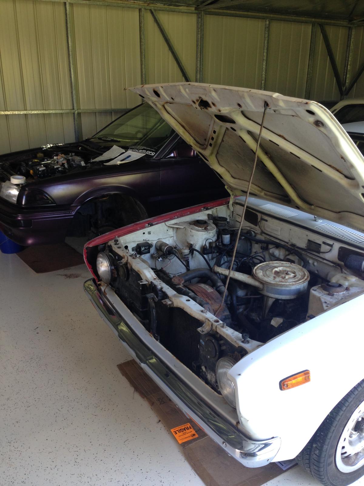

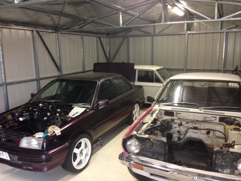

  6. Cheers all. Still slowly removing things for lift. I already got me Jordans kit and pedal box ;) Thanks for confirming cuzzo. I was pretty confident I had read it somewhere over the years, and the tunnel looks a good size
